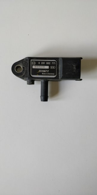

The DPF pressure sensor on my car (image attached) has two inputs but only one of them (the long input) is connected to the DPF; the other (the short input) measures atmospheric pressure. Hence, in my case, the DPF pressure sensor is measuring the pressure inside the DPF relative to atmospheric pressure. The readings of this DPF pressure sensor that I quoted in the previous post were from a new pressure sensor that was fitted after the coil light started flashing (based on advice from my mechanic).
