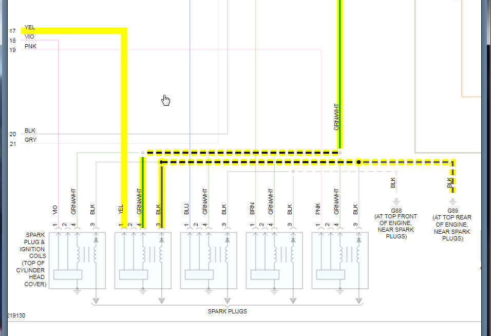

I have a misfire with cylinder 2. why I'm getting 11 volts on my coil connector without the engine running but ignition on?
Jun 21, 2020 at 5:40 AM

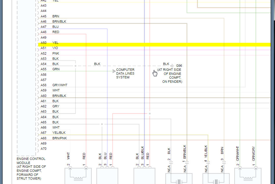

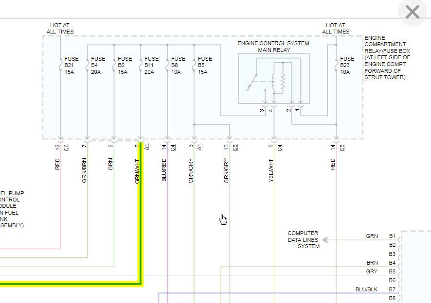

Which wire are you getting 11 volts on? I attached the wiring diagrams for your review. If it is the Green/White wire, I suspect this is normal. Compare it to another cylinder but you should have the same on each. The way it works is you have battery voltage on this wire when the key is in the on position. Then when the PCM wants to fire the spark plug it energizes the yellow wire (primary side) which then gets grounded through the spark plug.
So you should only have 12 volts on the yellow wire with the engine running and when that plug is firing.
Let me know if you have questions. Thanks
Jun 21, 2020 at 11:59 AM
WALT$
Thank you Kasekenny1. I didn't fully understand the electrical diagram as far as the yellow wire and the ground. I tested the coil connector plug itself and received readings while the ignition switch turned to on without cranking engine. Also got same reading on three separate connectors, so this must be normal.
The main issue is, I've changed all 5 spark plugs and ignition coils, yet still has a miss fire on cylinder 2, which had exposed bare wires that I've taped up. Did job myself cause I didn't want to pay the shop $800 they were asking. With all this done, what can be the problem?
