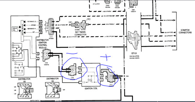

I have a 1993 with a 454. I’m changing the coil to a aftermarket Accel. The Accel has a + and a - . My stock coil has two plugs. Drivers side is pink and white. The passenger side is pink and white. Which wires go to the Accel + and - . Thanks

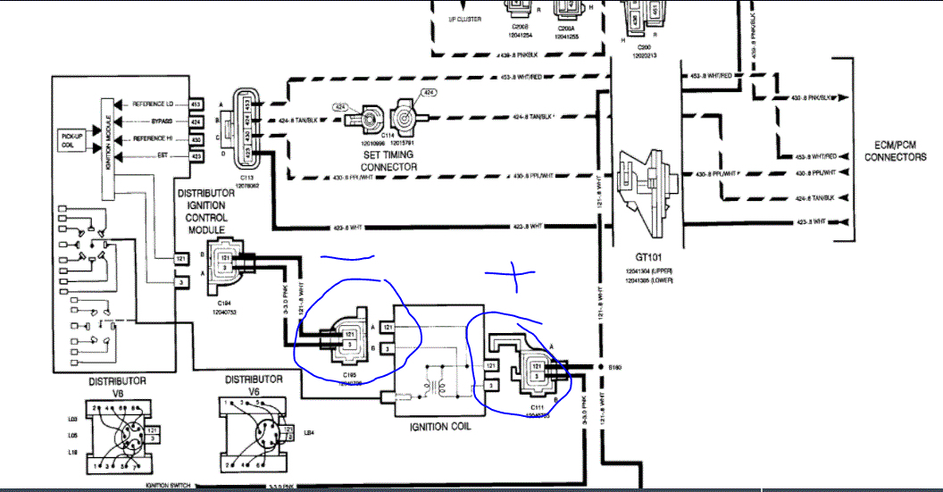

I attached a picture for you to view.
The wires that go to the distributor are or go on the negative side of your coil.
The other connector goes to the positive side.
