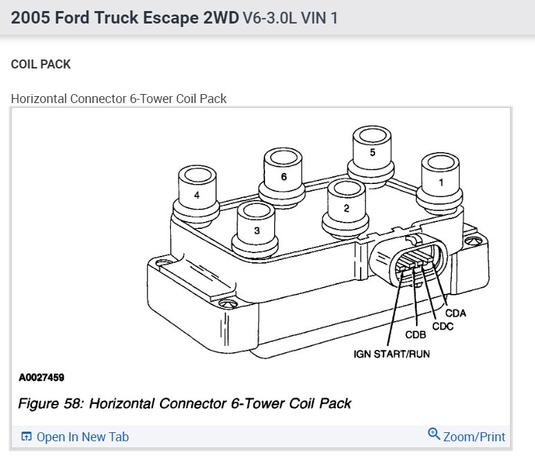

Coil, which one is p0351?

That would be bank 1, cylinder #1 firewall side front of engine, the intake will need to be removed to access it.

Here is a diagram of the ignition coil and a video on a similar car to help you change the coil out with diagrams below:
https://youtu.be/iDgXwKA-IIc
Image (Click to enlarge)
