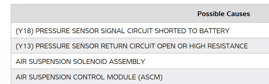

I am getting the code C155612, which says "ride height air pressure sensor circuit short to battery." My mechanic, nor my local Chrysler dealership, knows what this means or how to fix it. It is causing my engine light to stay on.

it may be the control module it is supposed to read c1556-12 that may be why they cannot see picture for causes. picture will not load pressure sensor signal shorted to battery, pressure sensor signal shorted or high resistance, air suspension control solenoid or bad module. finally loaded.
