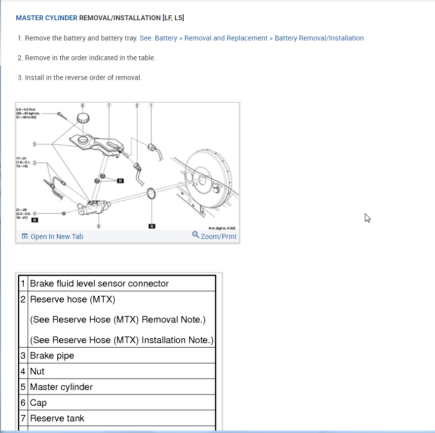

Prepared to purchase this car-my mechanic said it tripped certain codes he says I need a new brake master.

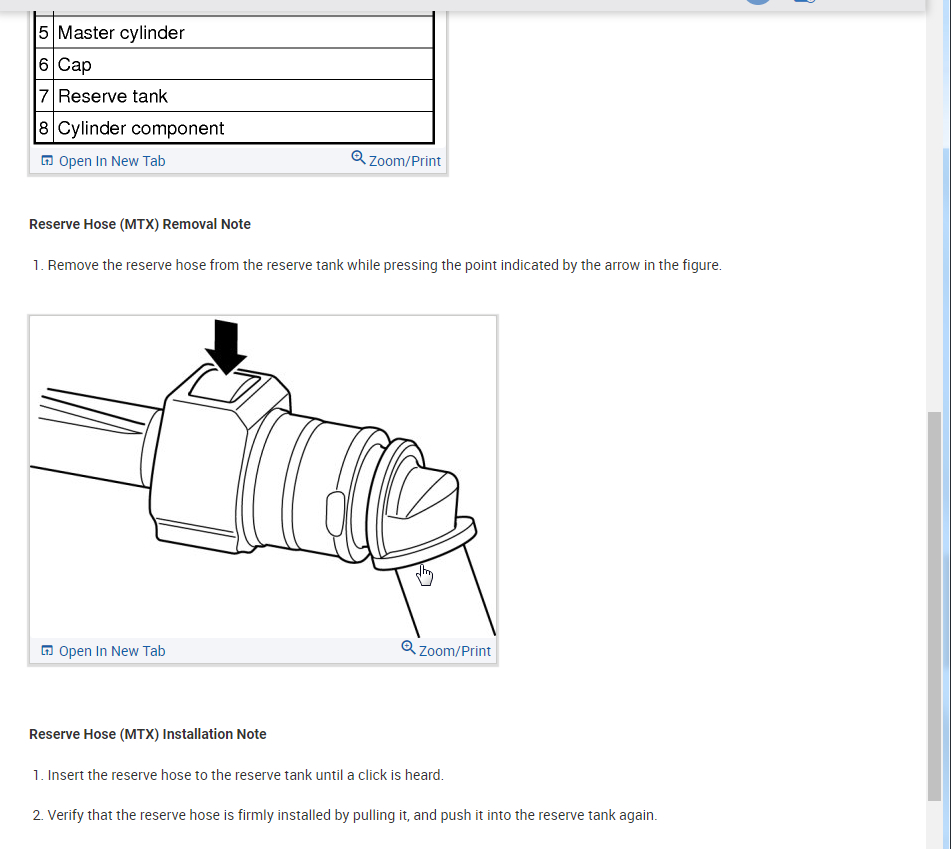

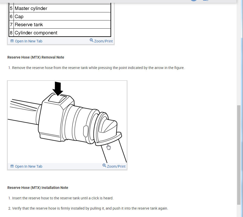

Here are some guides that will help with replacing the master:
https://www.2carpros.com/articles/how-to-replace-a-brake-master-cylinder
https://www.2carpros.com/articles/how-to-bleed-or-flush-a-car-brake-system
Below you will find the process from the manual on how to replace this. Please run through this material and let me know if there are questions.
