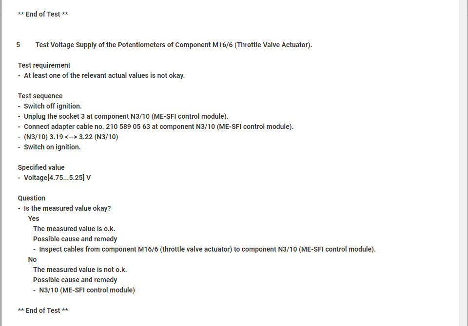

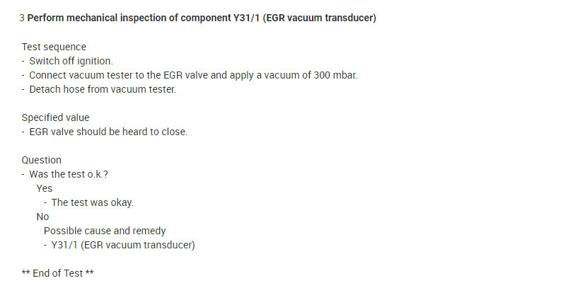

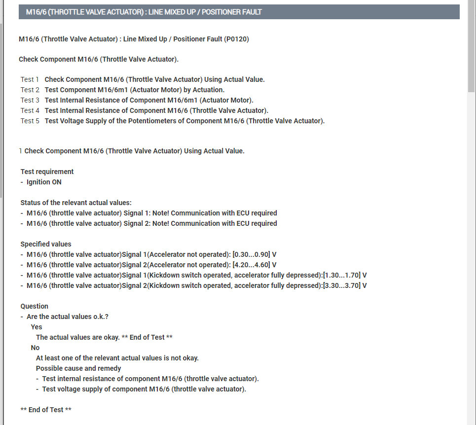

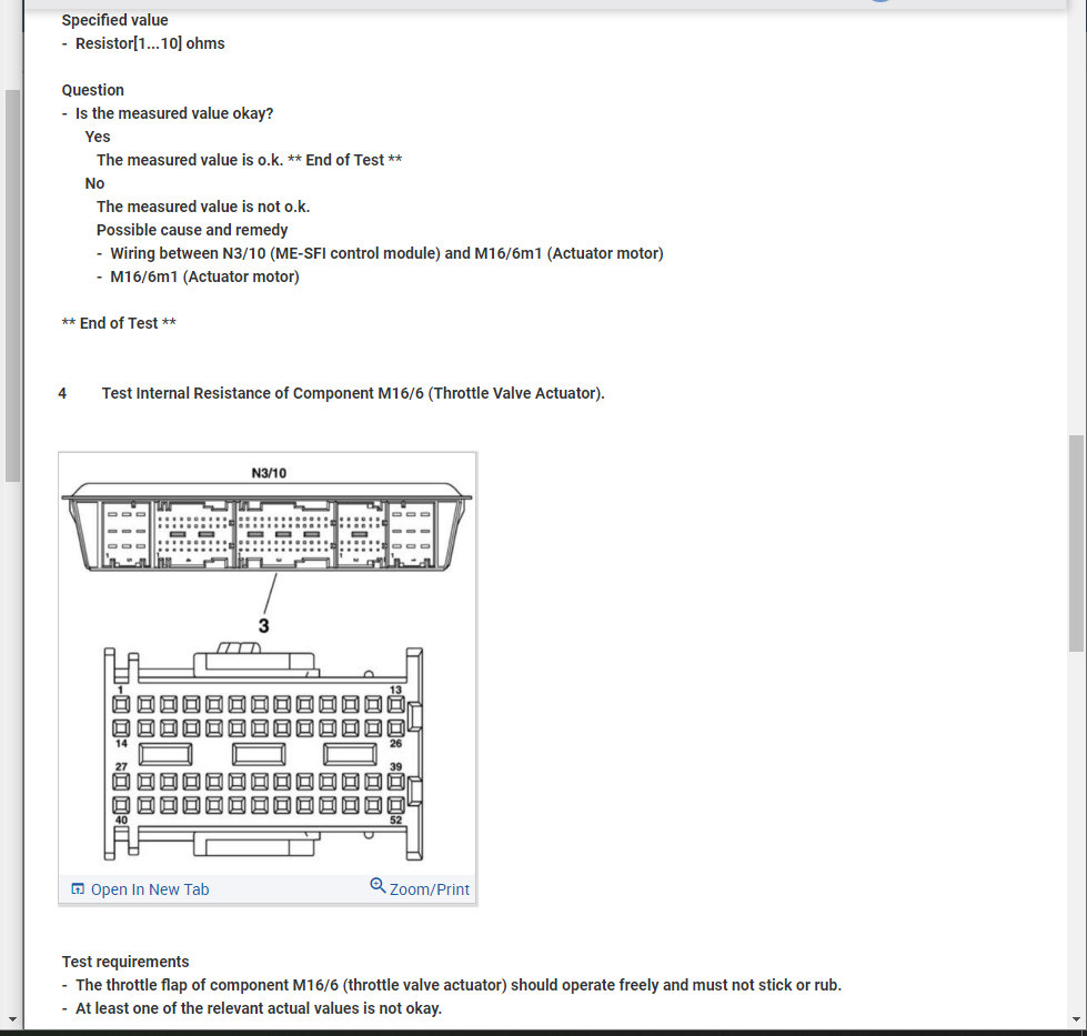

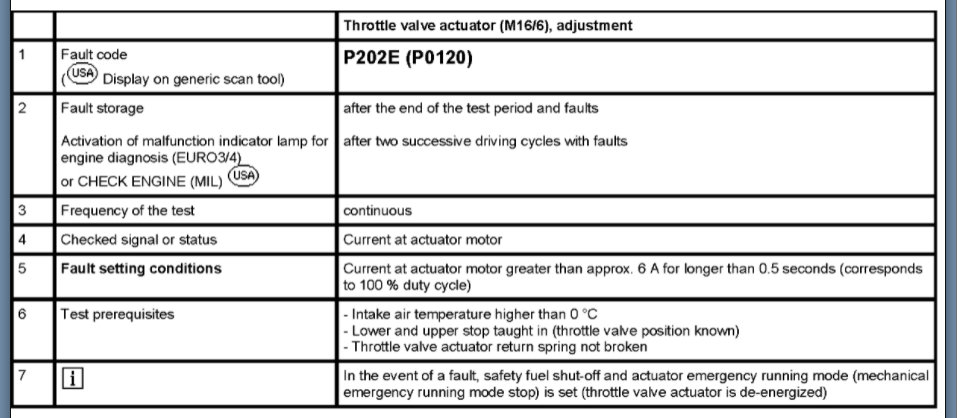

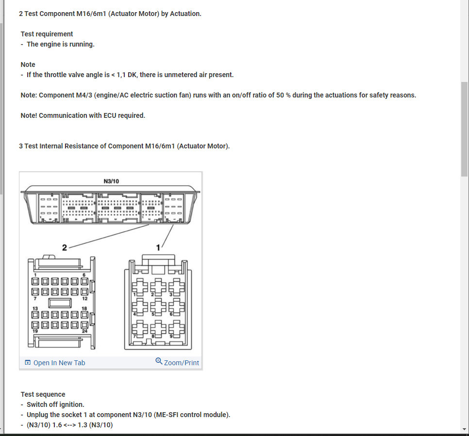

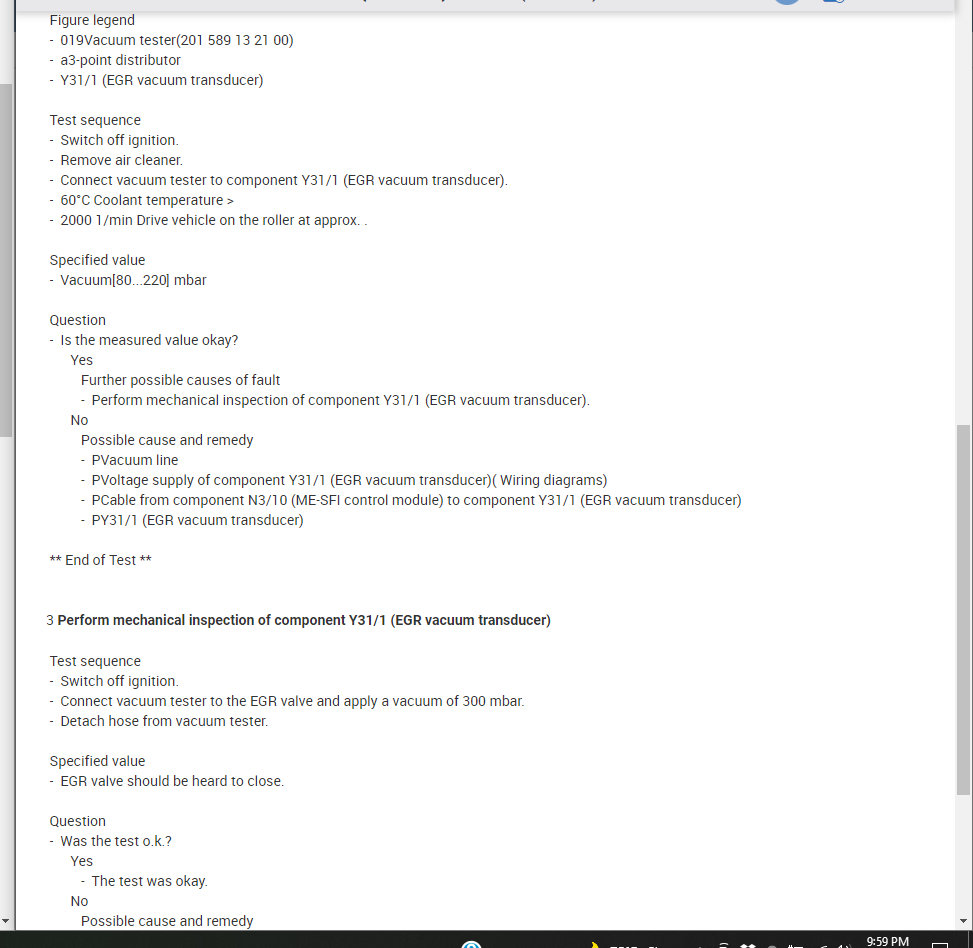

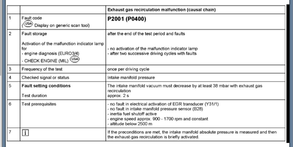

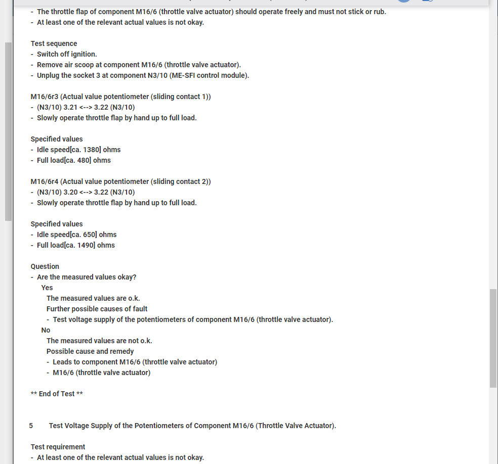

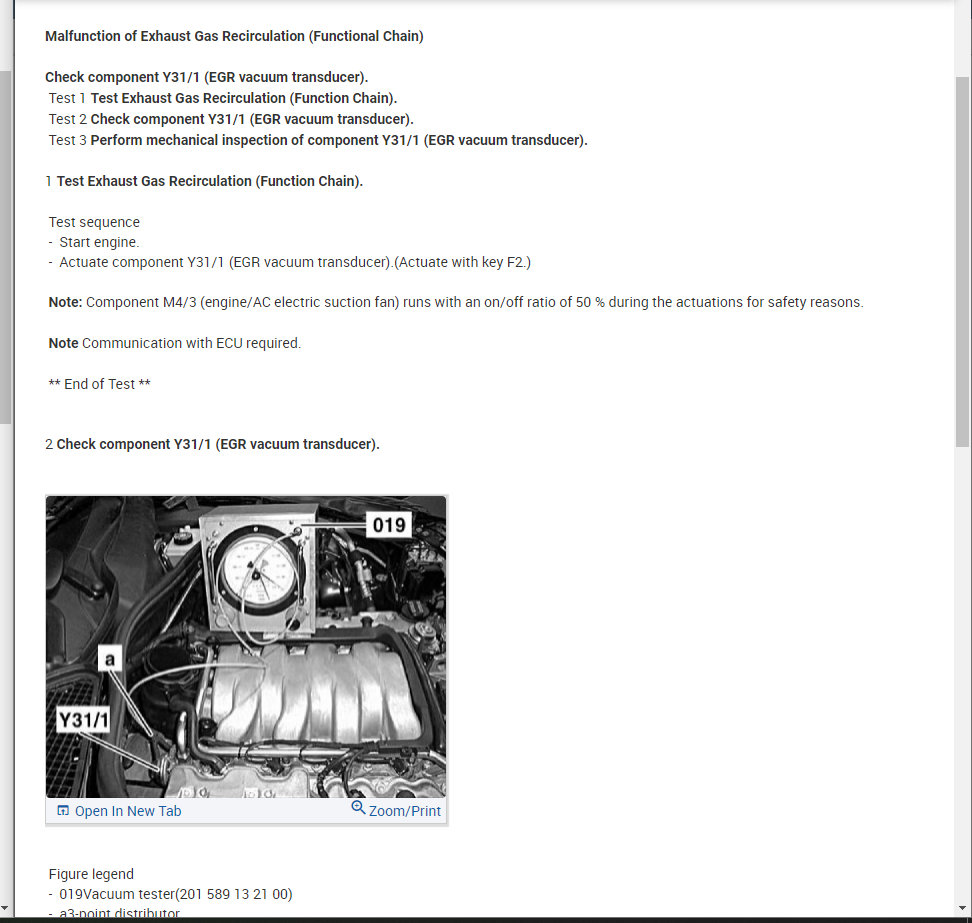

More than likely there is an issue with the P202E code which is for the throttle control.
However, this guide will help with getting us started on this issue:
https://www.2carpros.com/articles/engine-has-low-power-output
I am going to attach the info below on how to test these codes but I would focus on the P202E code and see what turn up on the testing.
Please run through this and let us know what you find. Thanks

ECU has been replaced with used one and it's okay now.
Thanks for every body.
