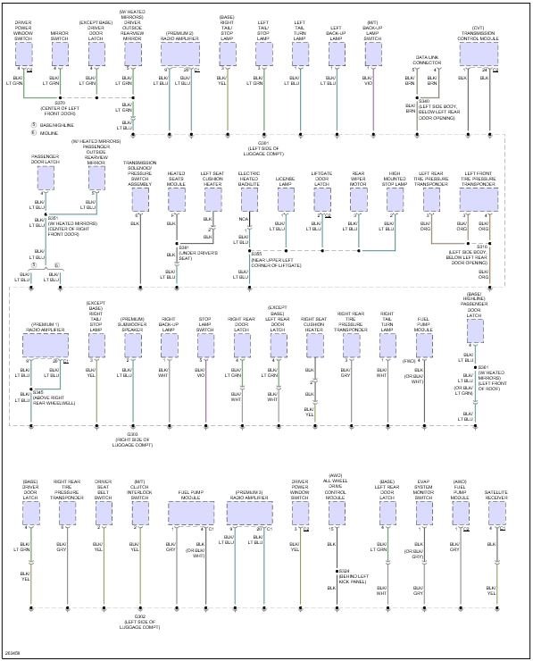

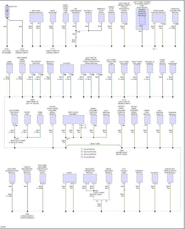

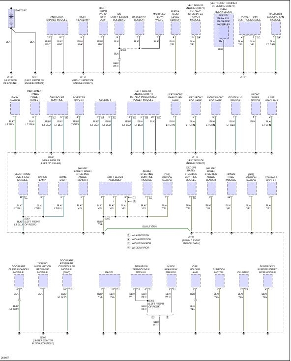

Ground wiring.
Feb 28, 2019 at 10:20 AM
PATENTED_REPAIR_PRO
Experienced Mechanic
1,853 POSTS
I assume you wanted the ground wiring diagram.
Images (Click to enlarge)
Feb 28, 2019 at 6:58 PM
GEORGE GILLAM
MEMBER
4 POSTS
Thank you. c100 ground wire.
