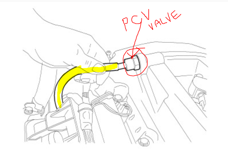

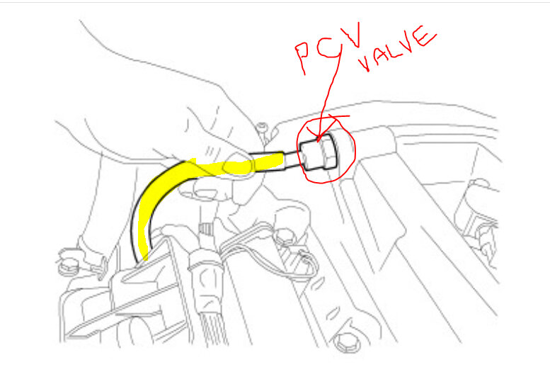

The P0420 indicates the catalytic converter is operating below the threshold. The P2173 is indicating an engine vacuum leak. The two can be related.
First, I need you to check something for me. If your scan tool has live data, check the short-term fuel trims when the engine is at operating temperature and at idle. Let me know what they are.
If you don't have that option, start by checking for possible engine vacuum leaks. Also, check the PCV valve and hose to make sure they are connected on both ends and the hose isn't cracked. See pic below.
Here is a link that explains how to check for a vacuum leak:
One last thing. Confirm there are no exhaust leaks before the catalytic converter.
Let me know what you find or if you have questions,
See pic below.

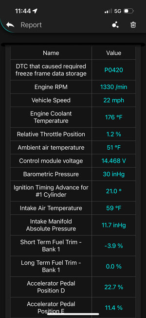

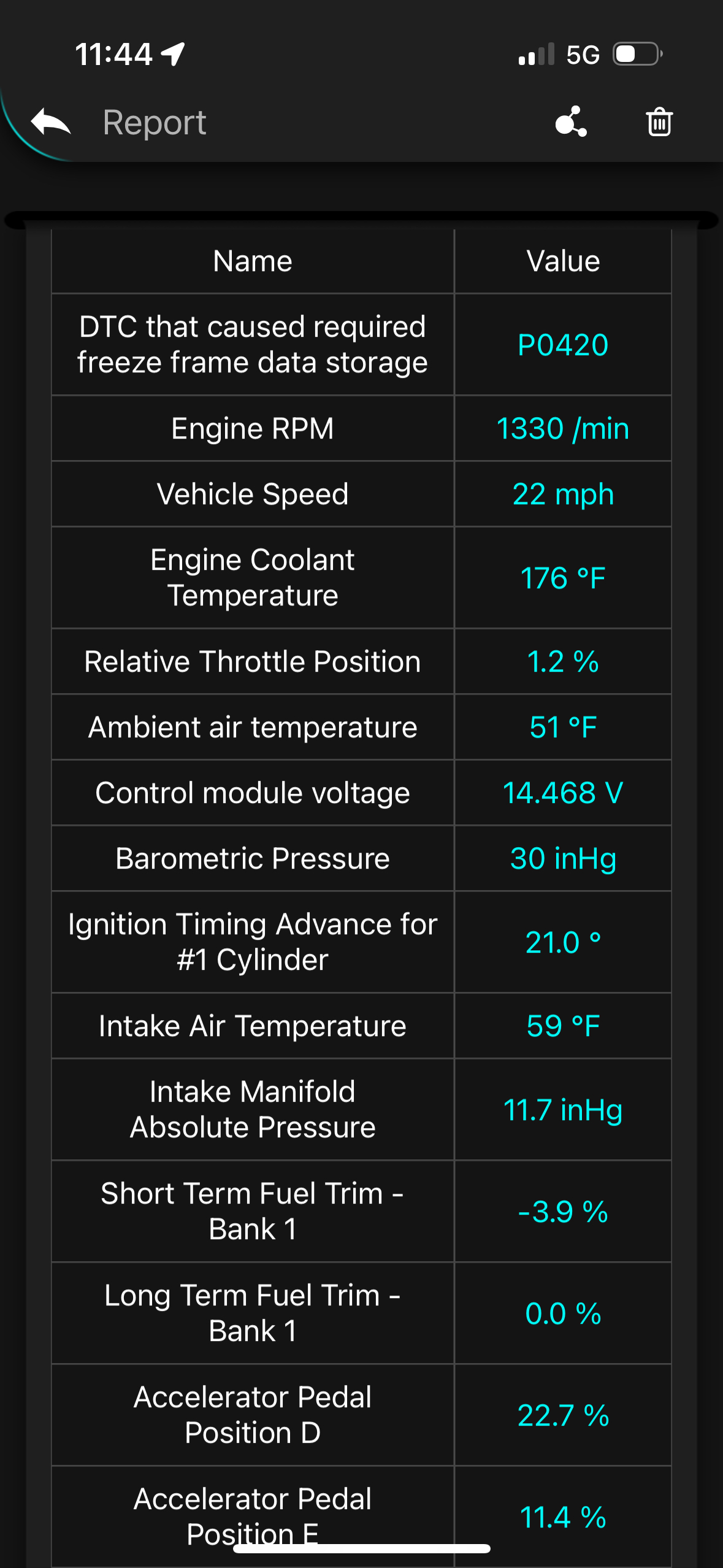

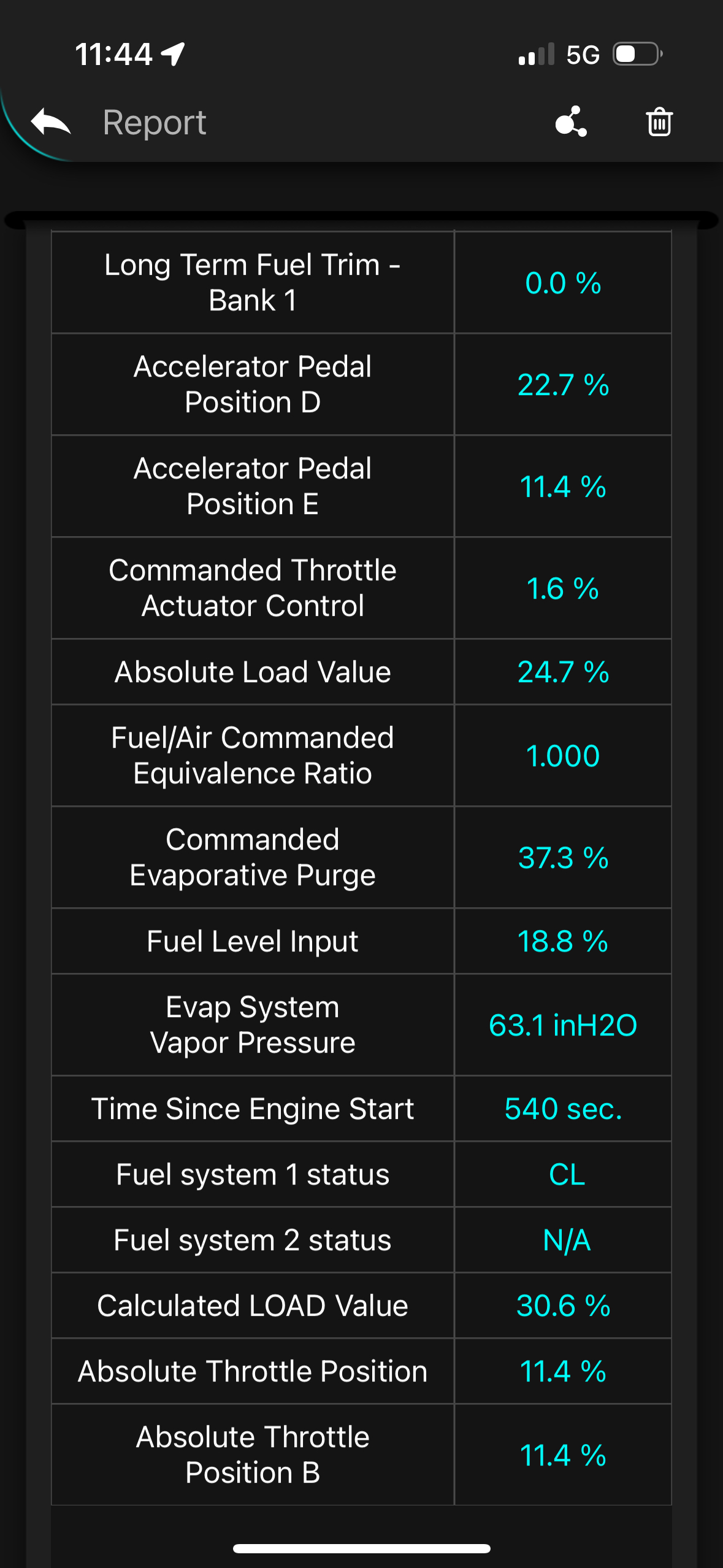

RROLSTON14
  • 5 POSTS
Here are the live data freeze frame results.
Apr 14, 2024 at 1:45 AM
  • 110,240 POSTS
Thanks for the information. The short-term fuel trims (STFT) can be used to determine if the engine is running too rich or too lean. (too much or too little fuel). In this case, the negative number indicates the computer is trying to reduce the amount of fuel being used. That is the opposite of what I would have expected for an engine vacuum leak.
In a perfect world, the STFT would be 0% with little fluctuation. However, up to 10% + or - is considered fine and you are within those specifications.
Have you been able to check the other things I mentioned, including an exhaust leak?
