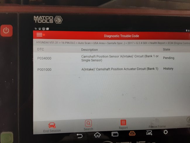

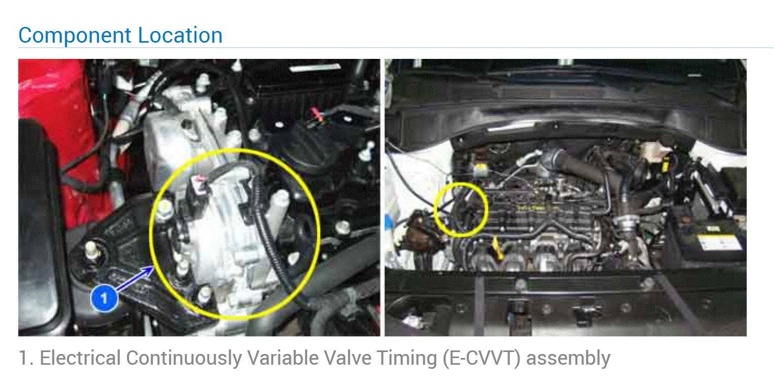

We've replaced the camshaft positioning sensor after getting code P034000 Camshaft position sensor A (intake) circuit (bank 1 or single sensor).
Then got a code P001000 A (intake) camshaft position actuator circuit (bank 1)
Which after research looks like a VVT solenoid. Where the heck on this vehicle is that located?
Feb 12, 2022 at 10:57 PM
  • 110,240 POSTS

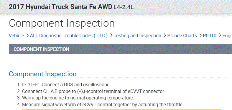

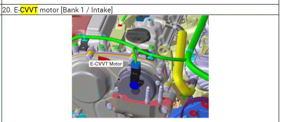

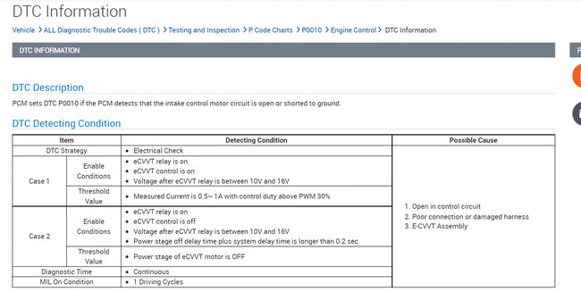

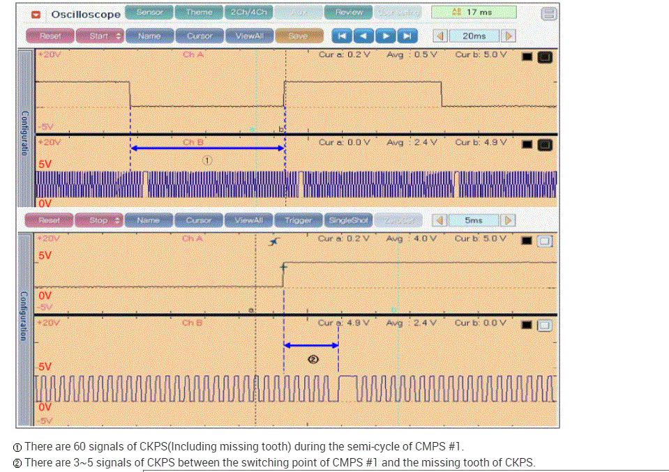

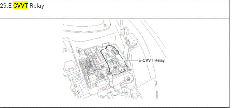

The P0010 is related to the CVVT system. See pic 1 below. The code leads me to believe there is an electrical issue or the CVVT motor has failed.

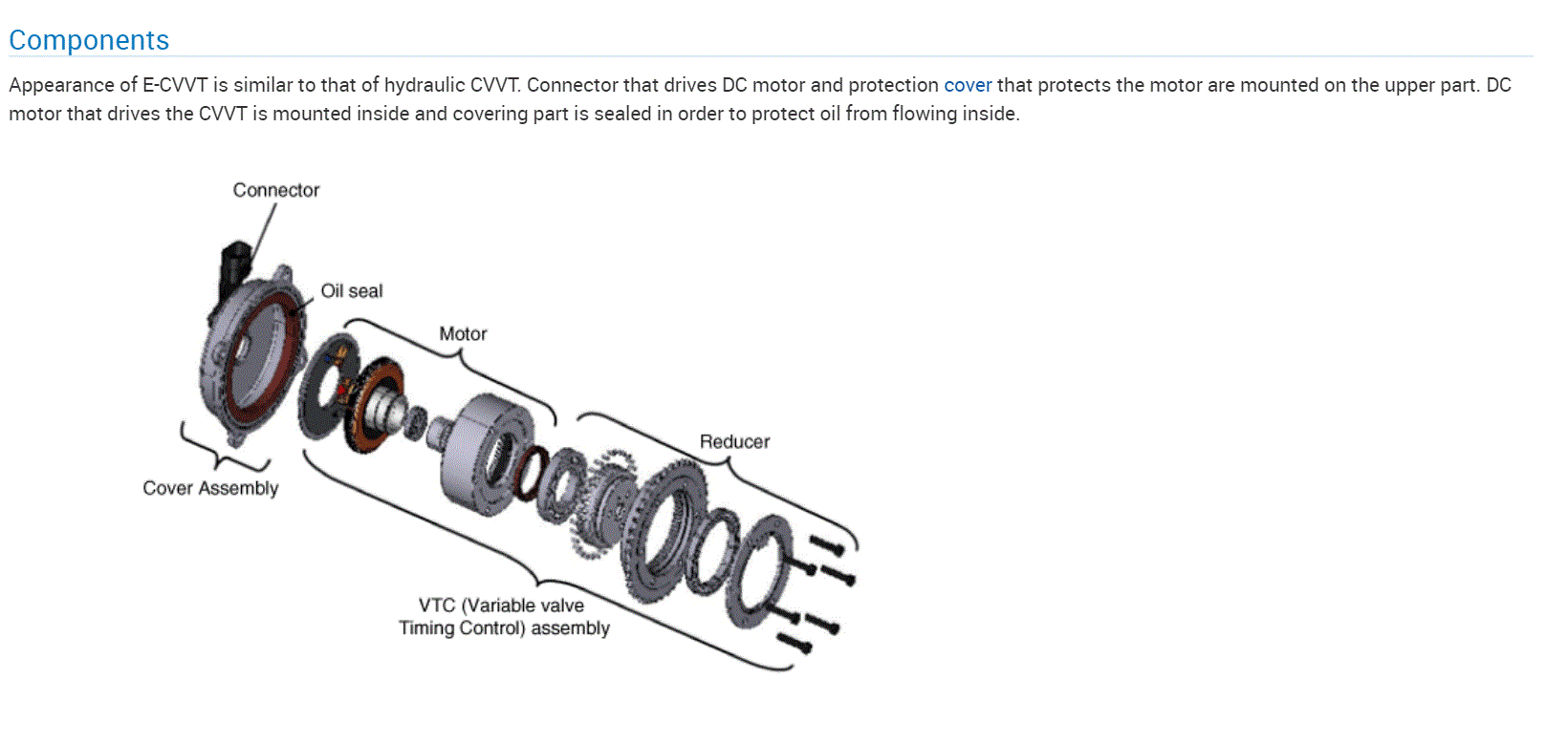

The component is located on the end of the camshaft.
Take a look through the pics below and let me know it if helps.
Feb 13, 2022 at 12:31 PM

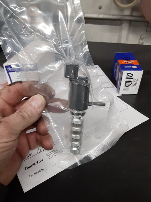

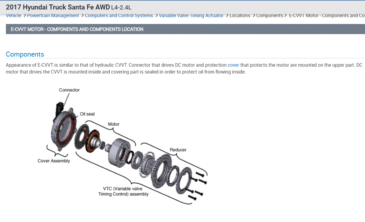

These are the codes and the camshaft actuator solenoid. Intake. Which picture you sent shows where the actuator is solenoid on the engine?
Thank you for all your help.
Feb 13, 2022 at 9:27 PM
  • 110,240 POSTS

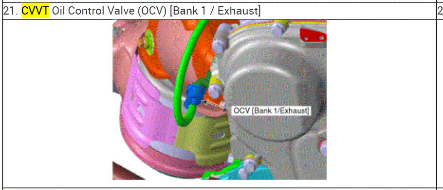

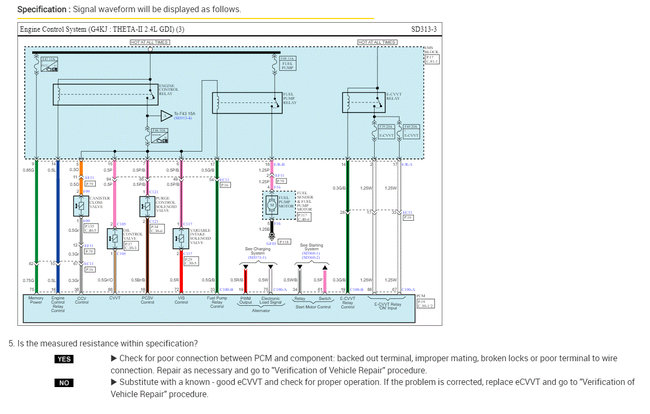

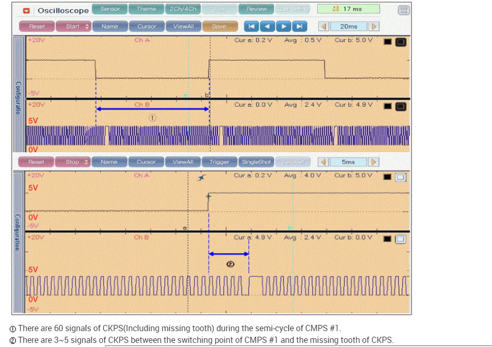

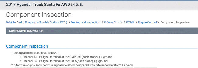

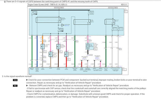

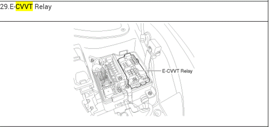

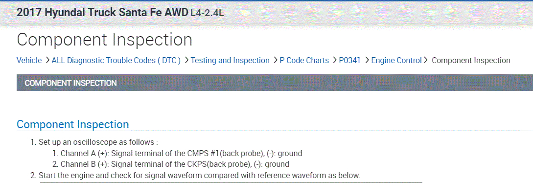

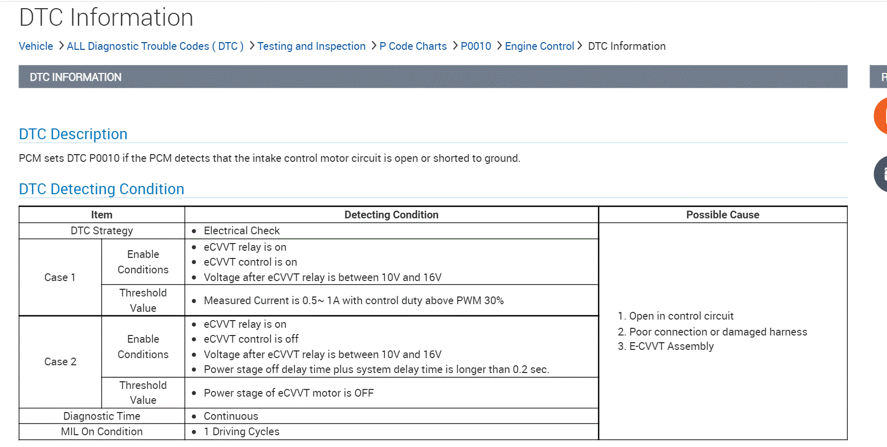

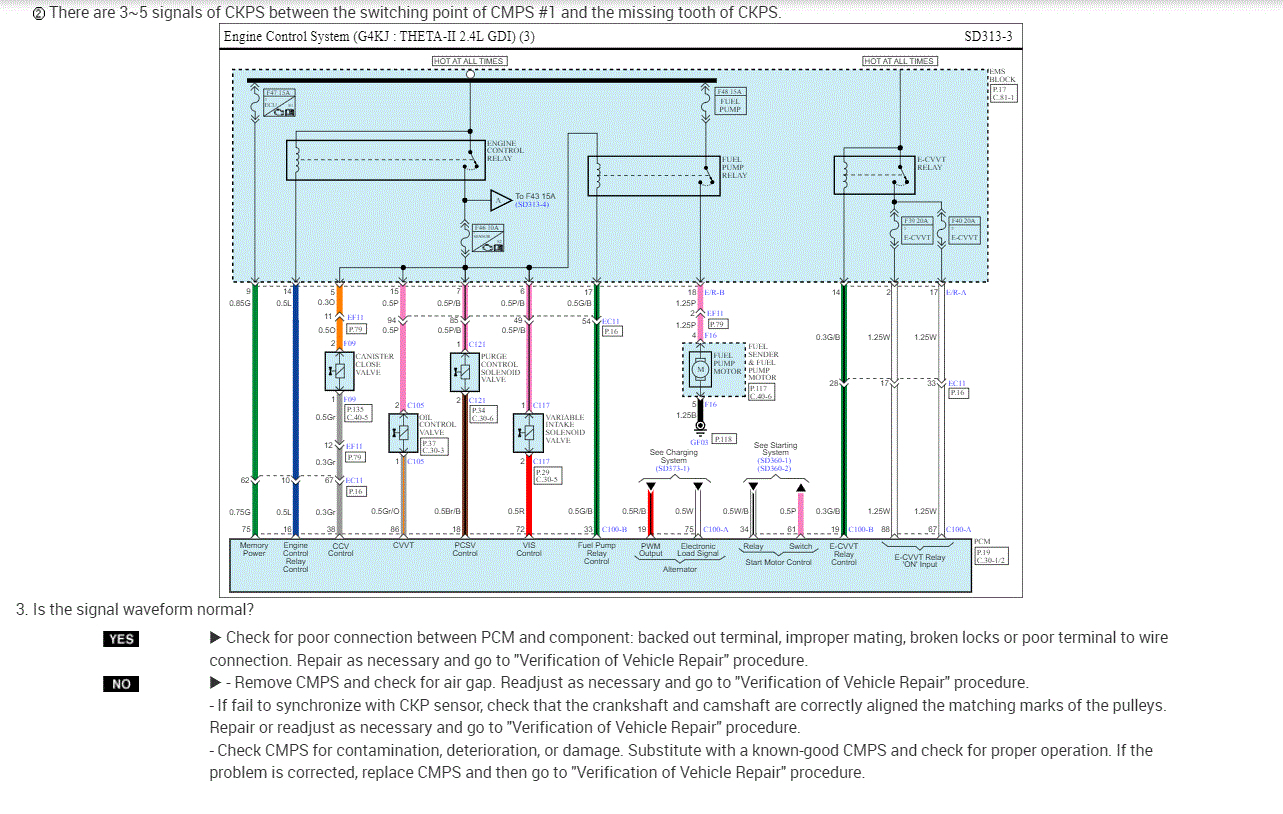

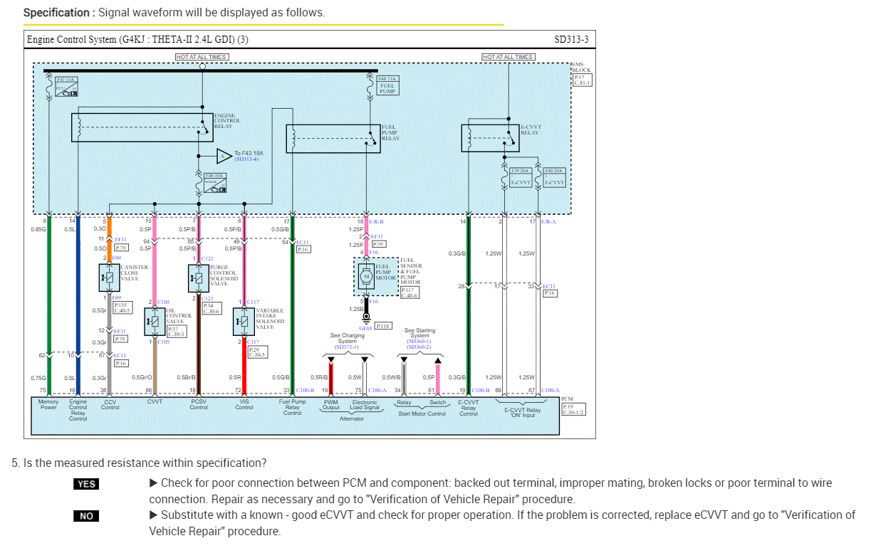

Your pic shows a CVVT oil control valve. This vehicle is has an E-CVVT motor taking the place of the hydraulic. It is actuated by the PCM. See diagnostics below for the P0010.
As far as the P0340 is concerned, it's related to a camshaft position sensor. Starting at pic 4, I provided the diagnostics.
Let me know if this helps.
