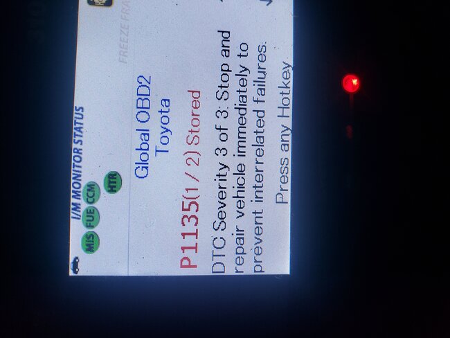

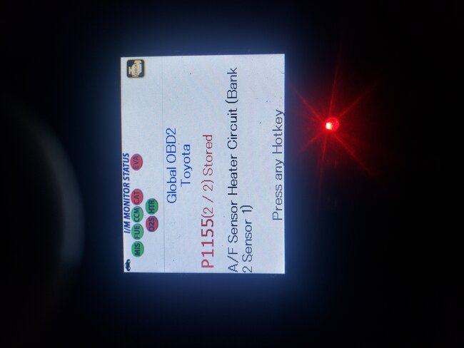

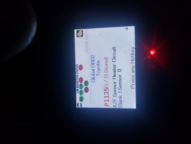

Codes p0135 and p0155?
2001 TOYOTA SIENNA
125,000 MILES • 3.0L • 6 CYL • 2WD • AUTOMATIC
BRUX
  • 6 POSTS

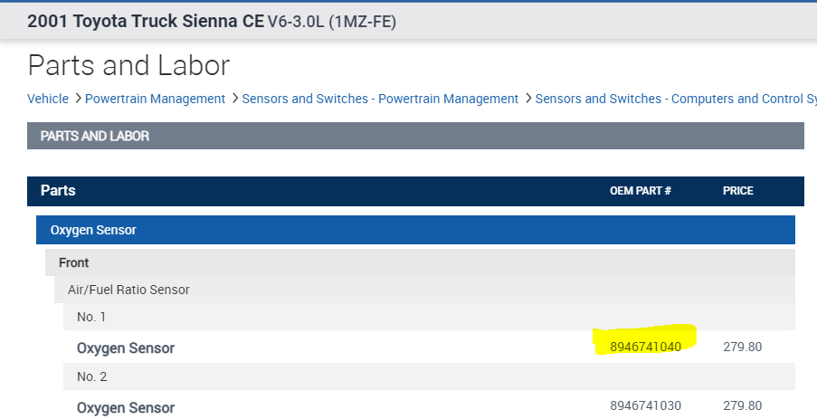

I know these are O2 sensors. Are they the same part in two different locations along the exhaust? I provided images of the obdII readouts.
Mar 8, 2023 at 4:18 AM
  • 110,244 POSTS

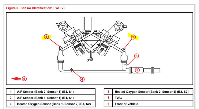

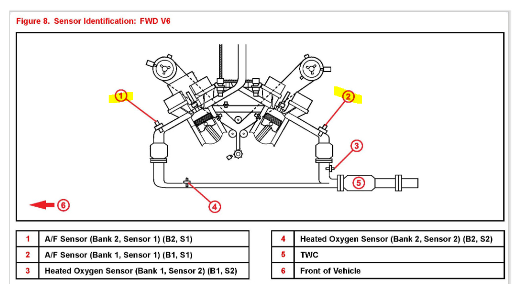

The codes you have for sensor 1 on both banks (1 and 2). See pic 1 below for locations.

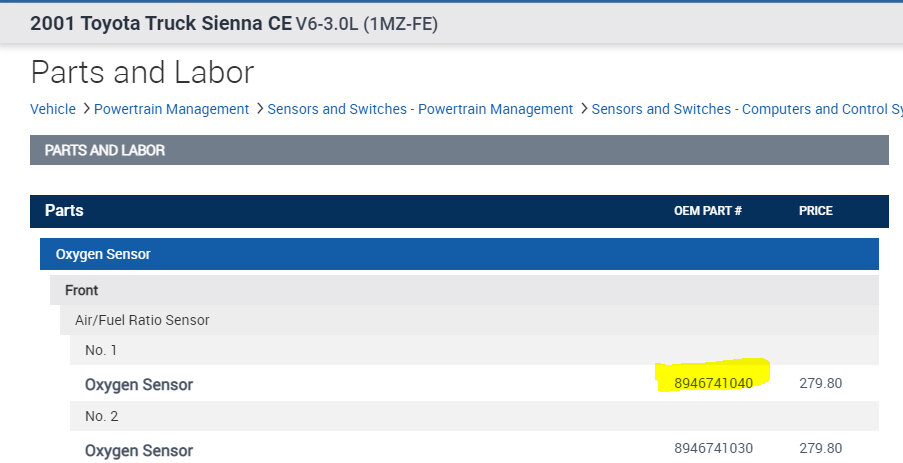

According to the part numbers, they are both air/fuel mixture sensors, and they have the same part number. See pic 2.

Yes, very helpful. Thank you, Joe. I hadn't really thought of the engine as it is depicted in that diagram either.

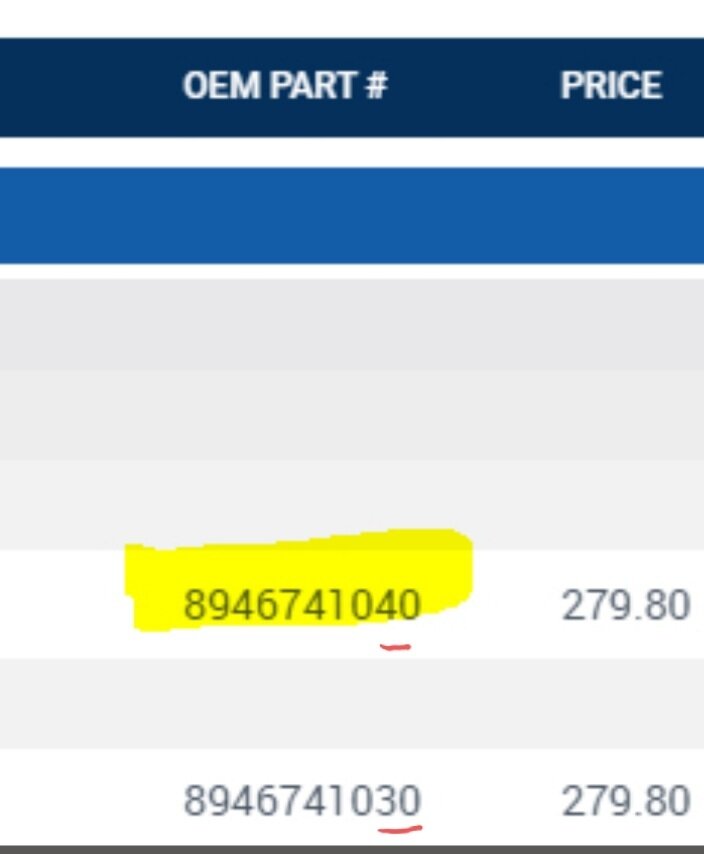

Just noticed that the part numbers are almost identical. I'm not sure if this is an important observation, or if I understand what I am seeing.
In the image, I've underlined the discrepancy in red.
Mar 8, 2023 at 4:26 PM
BRUX
  • 6 POSTS
I'm guessing that if there is a difference, it would be in the length of the connector lead and possibly to the connector head itself.
