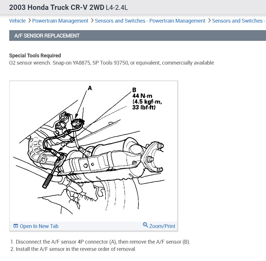

The engine light is on, and I get the following codes: P0134, P0171, P1457, and P0497. Please advise and suggest a remedy. Thanks.
Nov 8, 2022 at 8:19 AM
  • 54,832 POSTS
P0134 Oxygen Sensor Circuit No Activity Detected (Bank 1, Sensor 1).
P0171 System Too Lean (Bank 1).
P1457 Evaporative Emissions Control System Leakage.
P0497 Low flow condition for the evaporative emissions control system.
If the engine seems to be running okay, I would replace the primary oxygen sensor and for the EVAP issues the most common cause for this is a bad gas cap or it has been left off. Here is how to change out the oxygen sensor in the images below. If the engine is not running okay, we can have other issues that caused this code. Check out the images (below). Let us know what happens and please upload pictures or videos of the problem.
