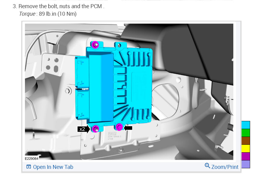

I got these codes for my car listed above. The check engine came on a day after we had a very bad storm and the area i work in got badly flooded. i drove through the flooded area for like 10 seconds but turned back. i don't know if it has to do with the codes but that was the only out-of-the-ordinary moment i had before the check engine and codes.

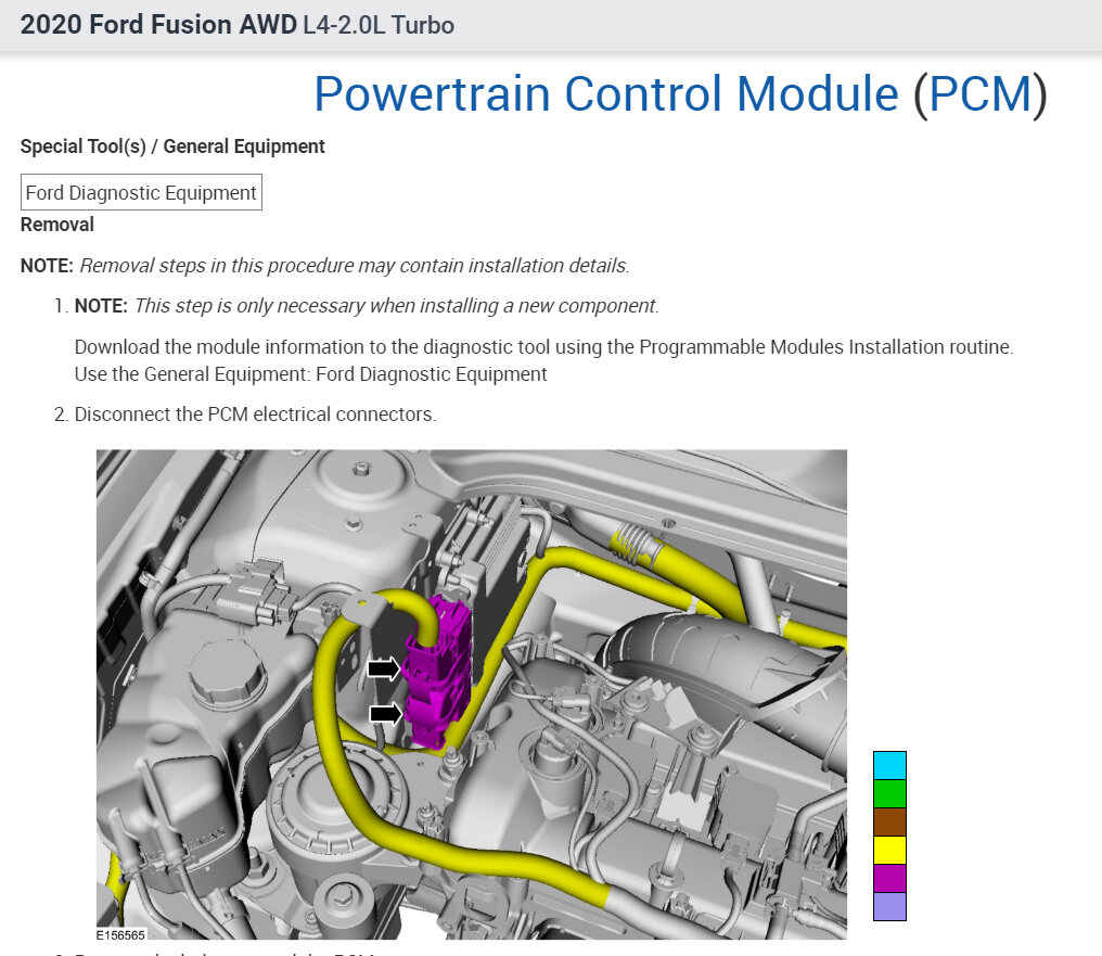

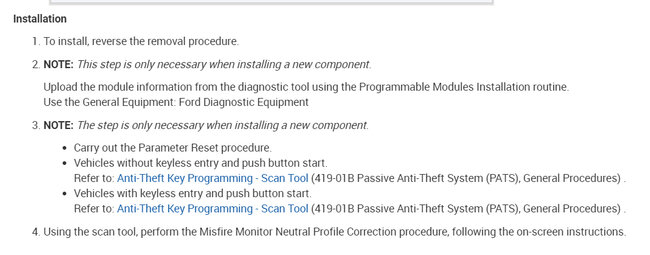

Is there any problem with the way the engine of cars or the car performs? If not, I would clear the codes and locate the PCM (images below) to dry it out. Here are the code definitions:
P0010 - "A" Camshaft Position Actuator Circuit (Bank 1)
P0013 - "B" Camshaft Position Actuator Circuit (Bank 1)
P0135 - O2 Sensor Heater Circuit Malfunction (Bank 1, Sensor 1)
P0141 - O2 Sensor Heater Circuit Malfunction (Bank 1, Sensor 2)
P0443 - Evaporative Emission Control System Purge Control Valve Circuit Malfunction
P0446 - Evaporative Emission Control System Vent Control Circuit Malfunction
Check out the images (below). Please let us know how it goes
