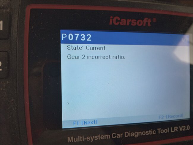

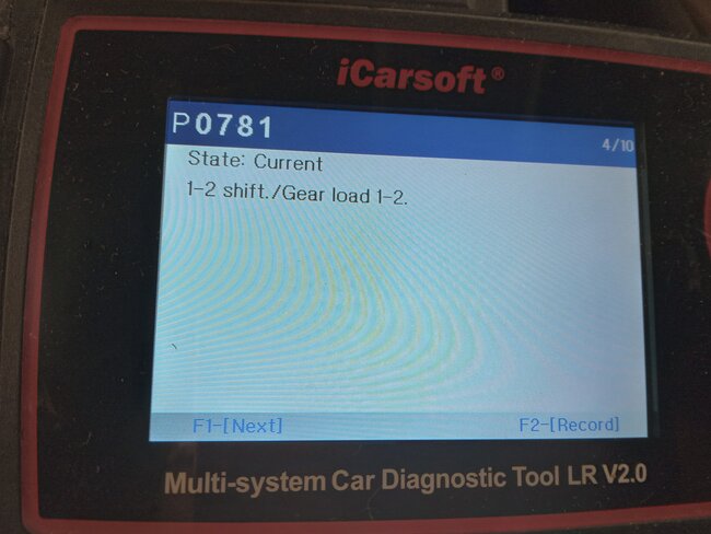

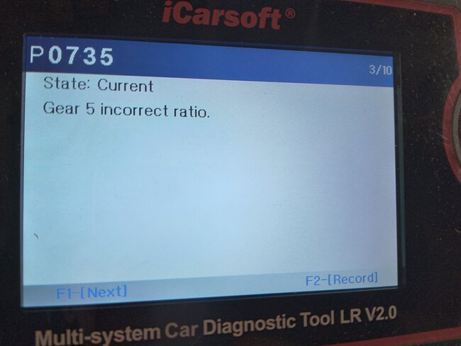

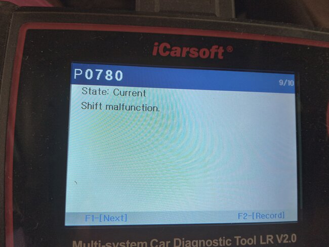

Codes for transmission p0706 p0708 p0720 p0783 p0741 p0701 etc.
47,000 MILES • AUTOMATIC
AUSTINO
  • 231 POSTS

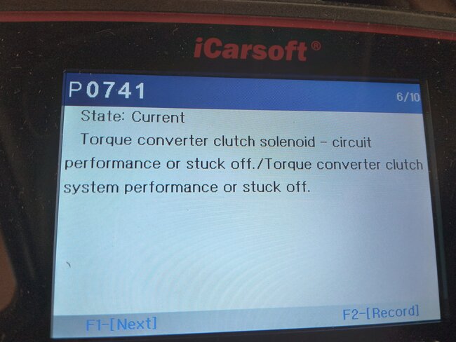

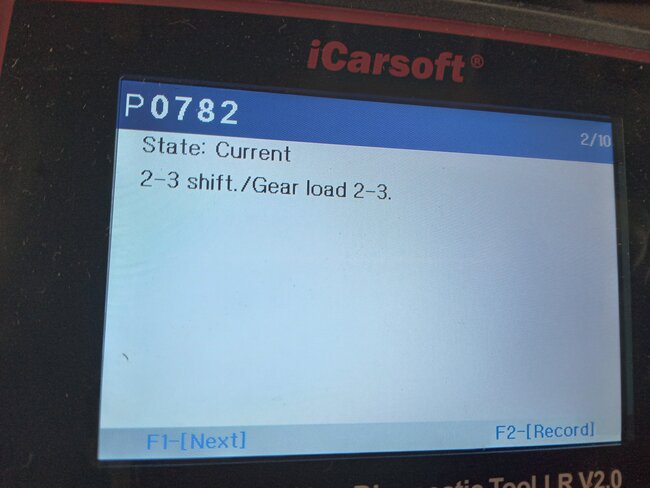

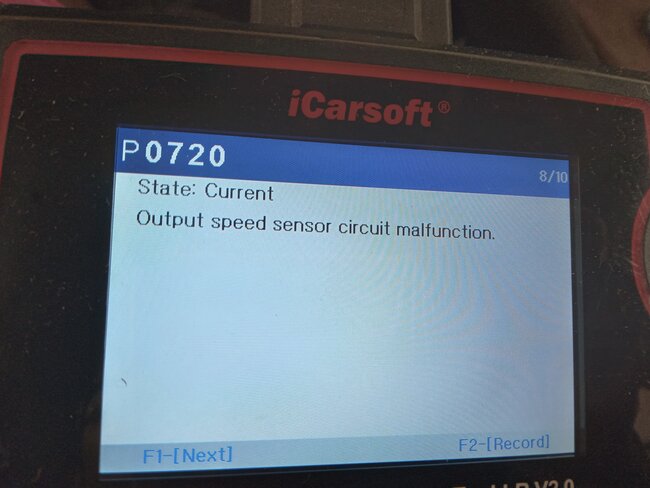

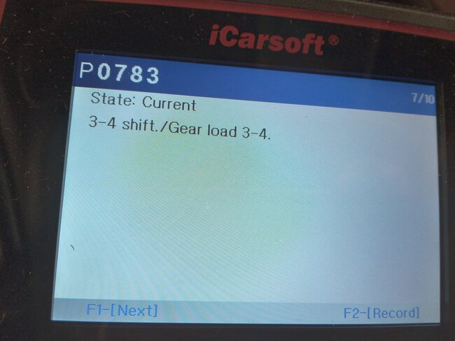

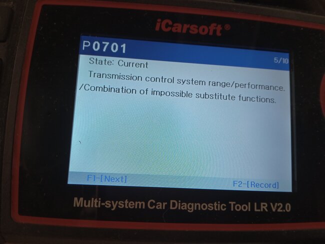

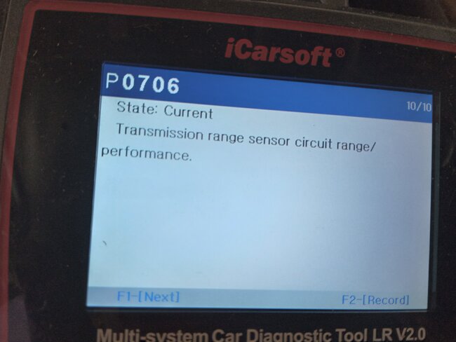

Good day can you please read these codes and let me know what you think?Please see images below .Thank you.
Jun 28, 2026 at 12:22 PM
  • 55,694 POSTS
Did all of these faults come up at once? We should do this first, clear all codes, then start the engine and without driving it, run the transmission through the gears, then run the codes again, we need to see which are come up first, let me know.
