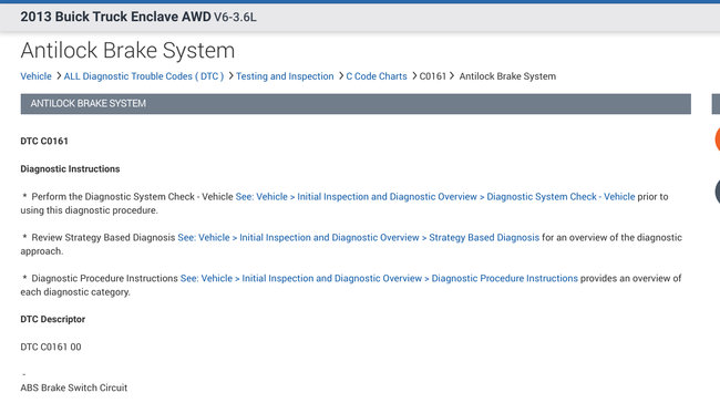

Codes c0131-00, and C0161-00
2013 BUICK ENCLAVE
132,000 MILES • 4WD • AUTOMATIC
JESSGT

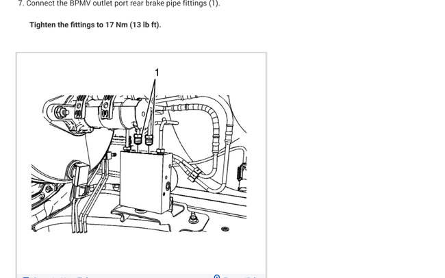

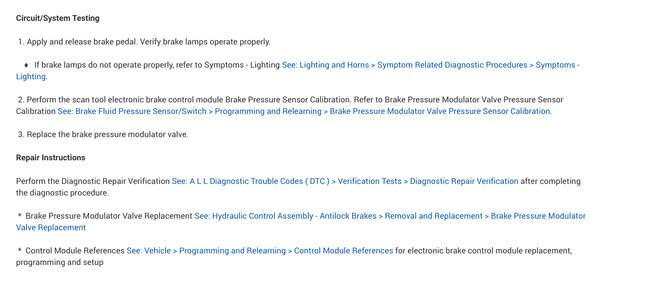

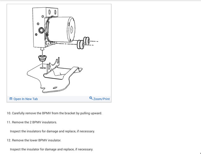

The front wheels seems as if the brake are locking up and giving us the codes above,
but it will do it sometime then other it runs fine.
when it locks up it has to be towed in or let it set to be reset.
Need help .
we have replace the brake caliber, abs sensors, the vacuum boost sensors.
Jan 11, 2020 at 10:27 PM
SCGRANTURISMO
  • 4,897 POSTS

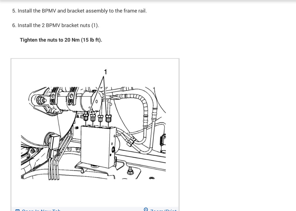

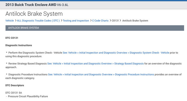

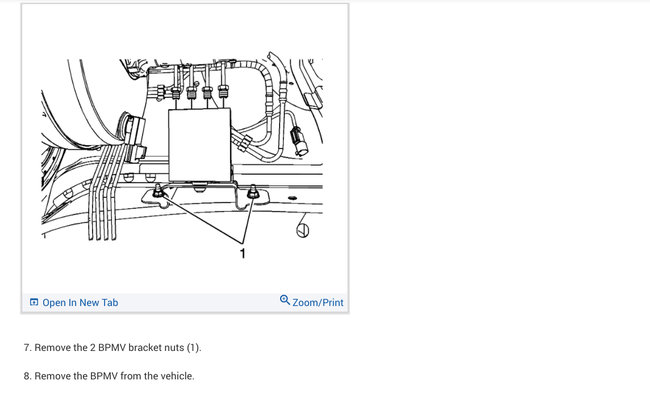

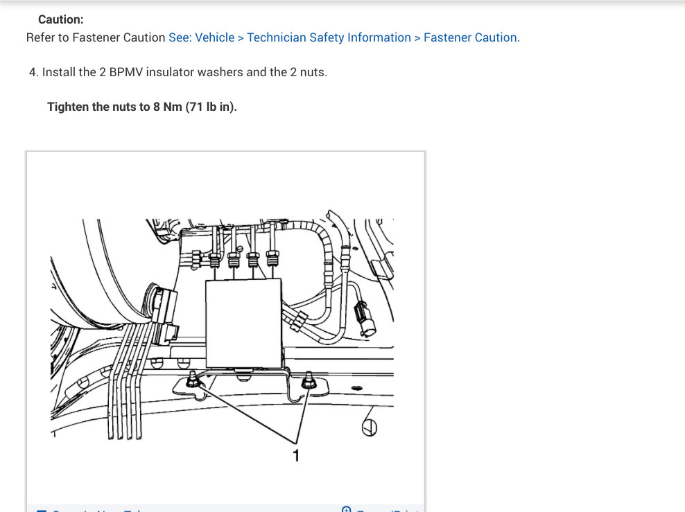

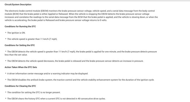

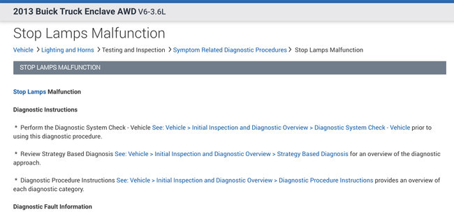

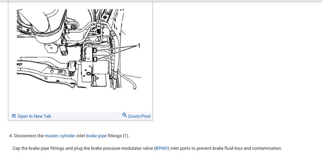

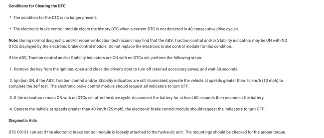

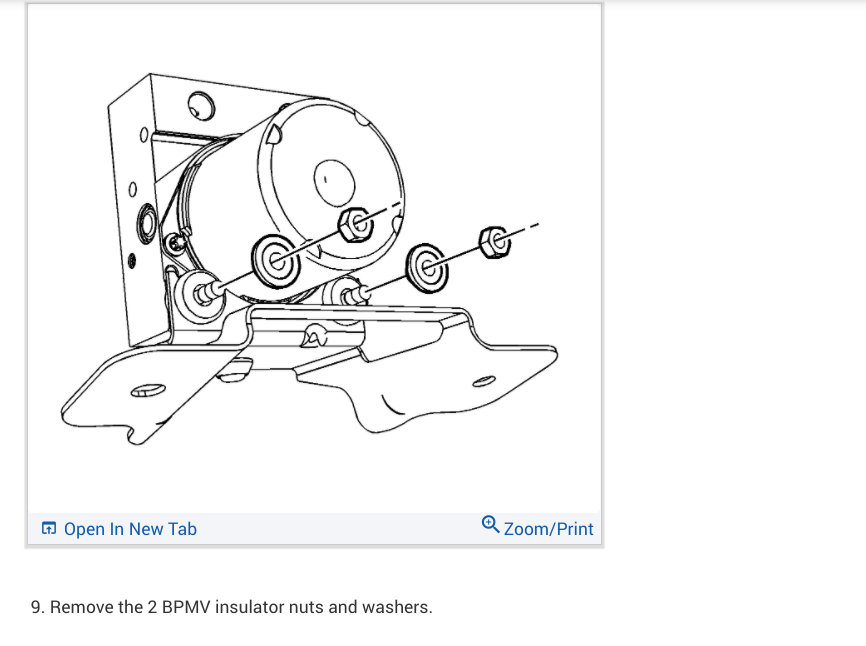

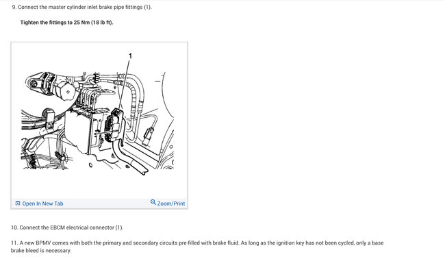

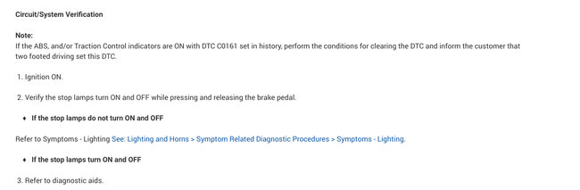

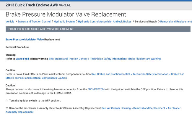

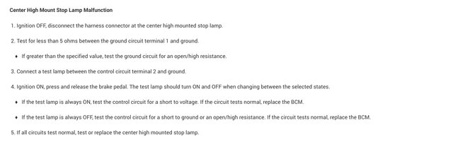

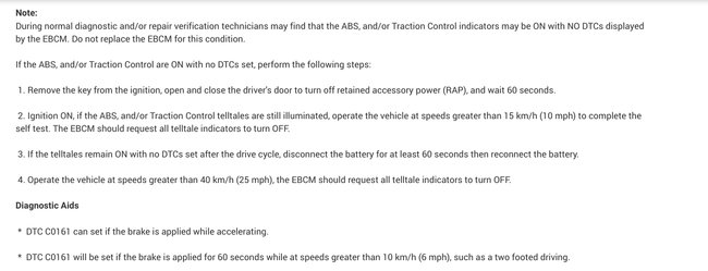

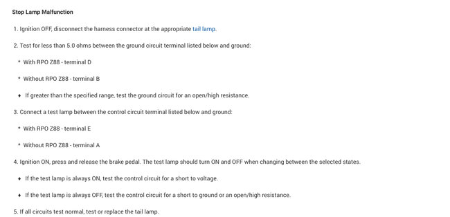

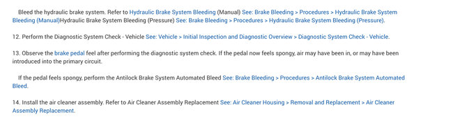

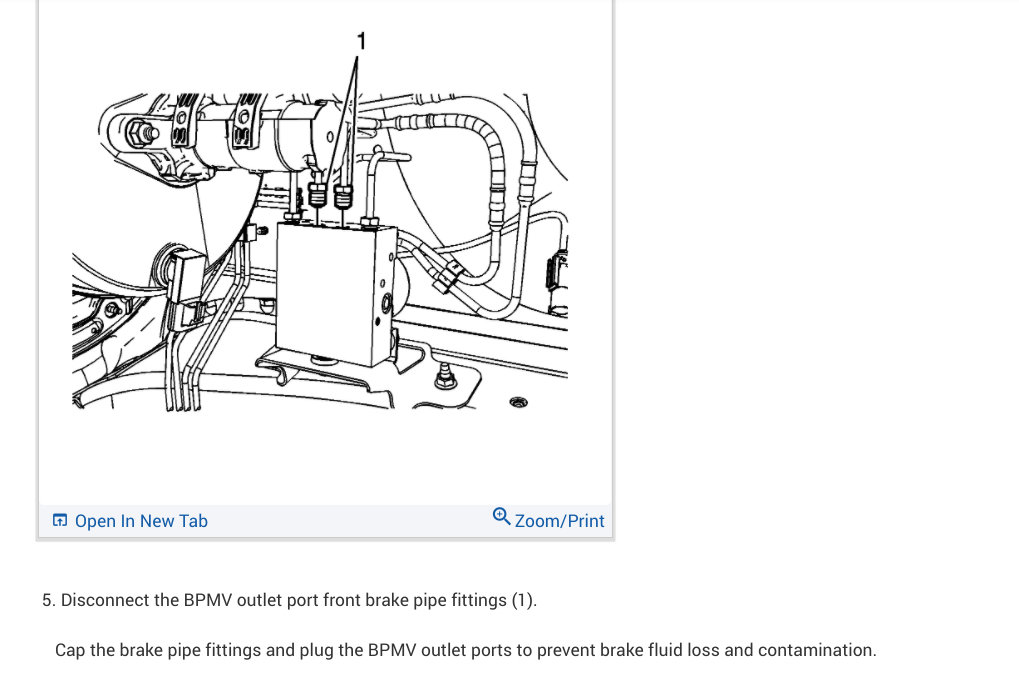

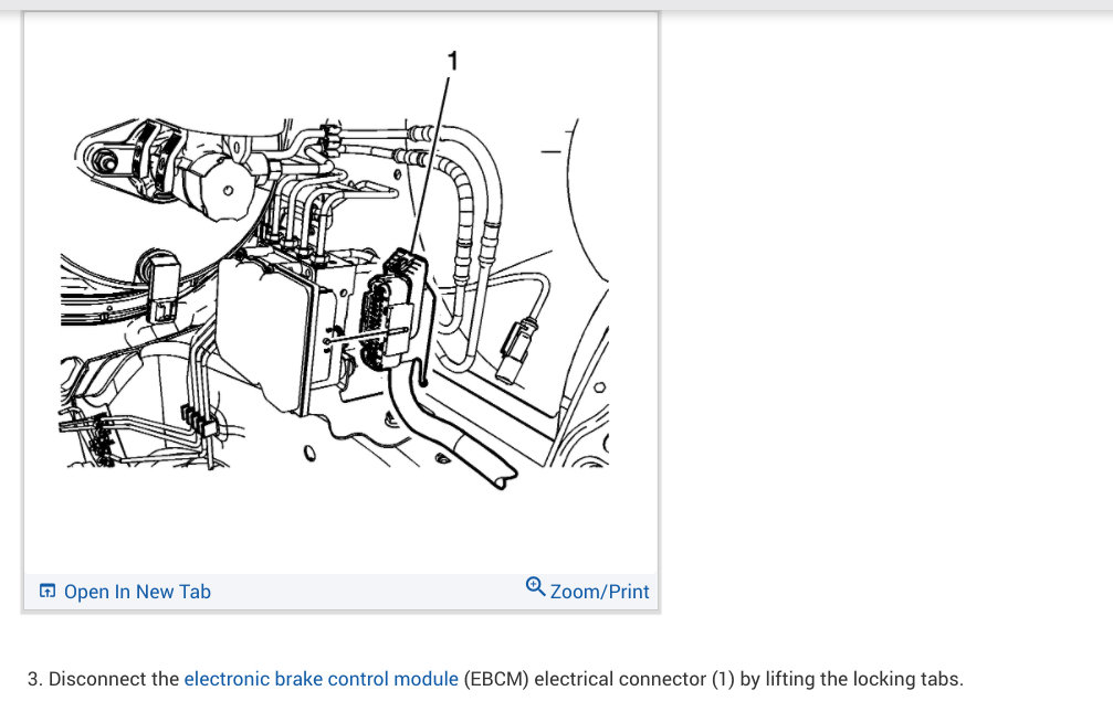

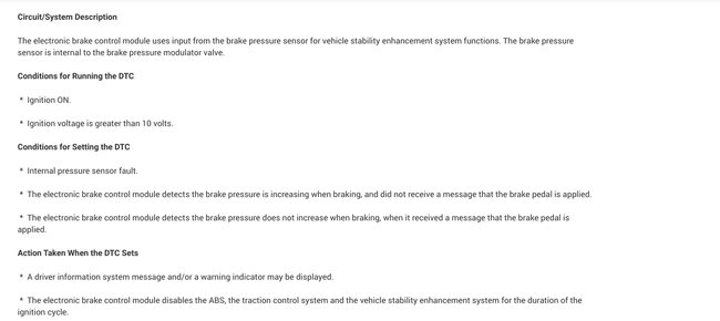

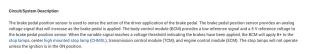

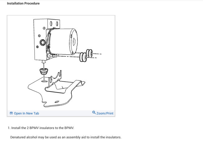

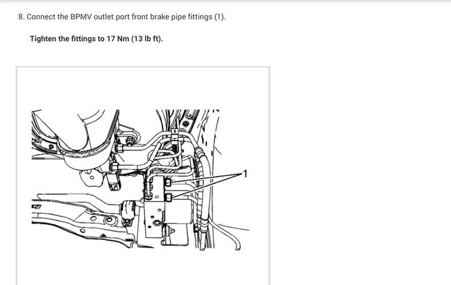

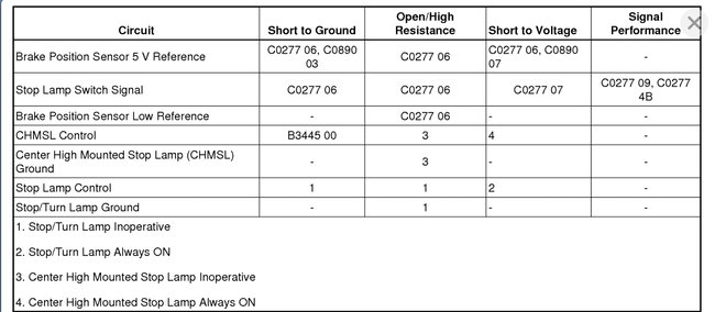

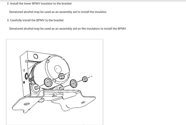

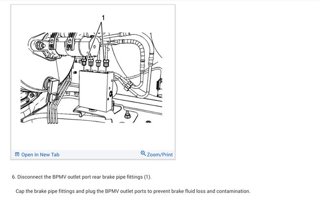

In the diagrams down below I have included the diagnostic troubleshooting guides for Direct Trouble Codes[DTC][s] C0131 and C0161, from the vehicle manufacturer along with repair information as well. Please go through these guides and get back to us with how everything turns out.
Thanks,
Alex
