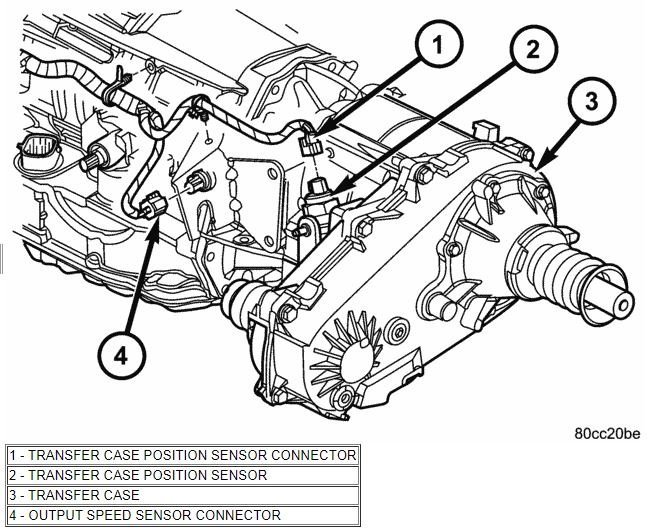

My vehicle listed above Sport model is throwing these codes:
P0339 Crankshaft Position Sensor A Circuit Intermittent Stored
P2305 Ignition Coil B Secondary Circuit Confirmed
P0837 Four Wheel Drive Switch Circuit Range/Performance Stored
Tomorrow, I am going to pick up 6 new spark plugs. I intend to replace those and also do a little musical ignition coil (at the suggestion of Steve on here, thank you Steve) to see if my second cylinder ignition coil is causing problems.
I am going to purchase a crankshaft sensor but was wondering if you think that would fix anything. I am not sure if the spark plugs are also possibly affecting other electrical such as crankshaft, or if they are separate issues.
As far as P0837, what should I do? My Part time light is on almost all the time, and my car is always in 2Hi and I can't change it. So does that mean it's four wheel drive switch that needs replacing? Are transfer case switch and four wheel drive switch the same thing?

The P0837 code simply means the PCM is receiving an invalid signal from the transfer case position switch. In most cases, replacing the switch fixes this issue. It's located on the top side of the transfer case and is relatively easy to access (see the attached picture). This switch is mainly used for the light in the dash and shouldn't affect your ability to actually shift it in and out of 4wd. If you're unable to shift the transfer case, there's mostly likely more going on.

Thank you! What do you think about the crank shaft issue? Good idea to replace? Also I just turned me key on and off three times because I just learned that will flash codes and I got P0839 which is related to 4 wd and yes I am having trouble shifting to 4hi and I also got P0300 and p0311. Thank you!

Are the transfer case switch and four wheel drive switch the same thing? Thank you

The P0839 is also a transfer case position switch code, but it means the voltage on the sense circuit is above the normal range. It's still most likely a bad switch. And yes, in this case the transfer case switch and four wheel drive switch would be considered the same thing since it's a manual shift transfer case. Are you able to shift into any range beside 2Hi?

And honestly, I haven't messed too much with that because I truthfully wasn't knowledgeable and I don't do off roading. But the one time I did switch to 4HI, I got stuck. Luckily my buddy is a Jeep guy and I called him he told me it helps if the car is rolling and that let me get back into 2 lo. I stick to 2 lo currently.

No problem. You may want to try shifting in to 4wd Part Time again just to confirm that it's working correctly (I'm guessing it's probably fine). The best conditions for shifting between 2Hi and 4wd Part Time are vehicle rolling(any speed under 45 is fine) and with your foot off the accelerator. You'll need to pull up firmly on the shifter, but it should pop right in.
