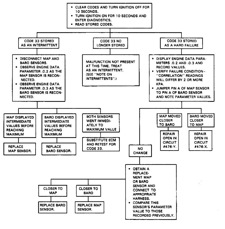

Car will not remain started. Trying to start but cuts right off. Codes 13 or 15 and 33 show.
Sep 7, 2016 at 1:54 AM
HMAC300
  • 48,601 POSTS
see pics for code repair,code 33 may be a bad map sensor or a soft vacuum line leaking and sucking to gether so it throws a code
