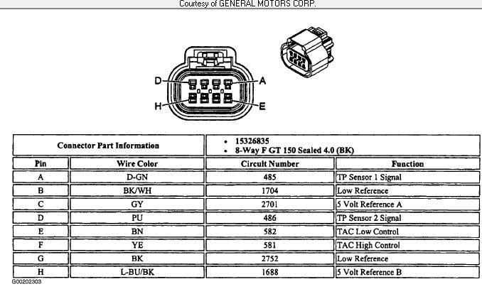

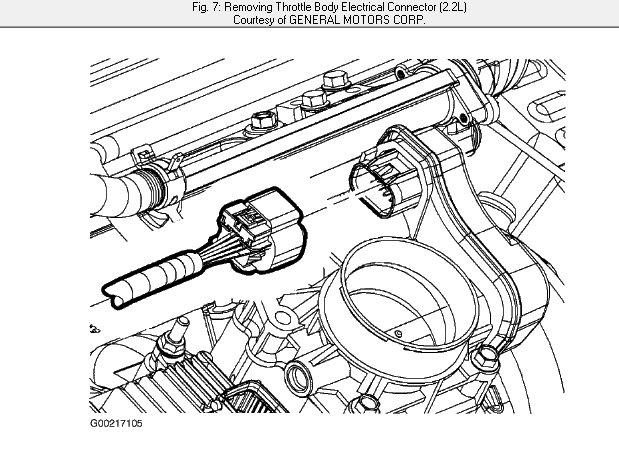

3.remove throttle valve connector fig 1.use voltmeter
4.turn ignition on, with engine off, measure the voltage of TAC motor control1 and TAC motor control 2circuit which are pin E brown in color pin F yellow in color ,check fig2,of the throttle actuator motor with DVOM connected to ground is the voltage greater than 11 volts for both circuits ?if yes, go to step 8.if no go to next step.
5.is the voltage less than 2volts?if yes go to step7,if no go to next step.

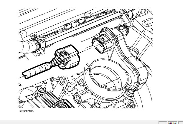

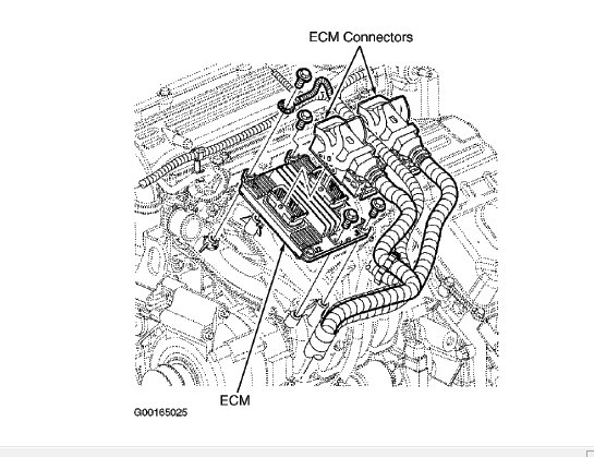

10.test for a poor connection and terminal tension at the ECM fig3.did you find and correct the condition. if yes go to step13.if no go to step 12.
11.replace throttle body assembly. after replacing throttle body go to step 13.
12.turn ignition off. replace ECM, perform ECM relearn procedure(programming).after replacing go to next step.

remove throttle valve connector, ignition on.
your throttle connector looks like the picture below figure 1,put voltmeter red probe on throttle connector pin E which its wire brown in color and voltmeter black probe on a good ground, you must get more than 11 volts, also check the pin F of the connector, voltmeter red probe on pin yellow in color and the black probe of the voltmeter on ground, you must get also 11v,if both values are more than 11 volt then the harness and engine control unit are good.
then throttle body assembly must be replaced. please update what happens with you.

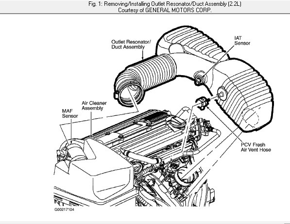

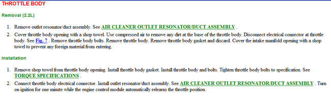

then it sounds your throttle valve assembly defected must be replaced.
check the procedure and diagrams how to remove and reinstall throttle valve.

Can I get a used part or is this like the body control module and needs to be new and programed to my car?
Jan 21, 2021 at 8:31 AM
SEVAG P
  • 405 POSTS
hello,
yes, you can get well known used throttle valve, and does not need programming. just after installation turn on the ignition for about 1 minutes it will adapt erase fault codes and test drive.
