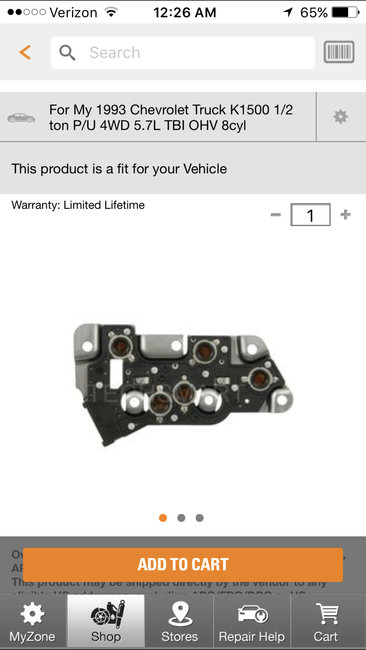

Hi, on my K1500 it is on one one system. I pulled two codes 28 and 32. I looked up both codes one was for transmission other was for EGR. Where should I start? Thanks. Also, if you know what I should do to test or anything like that I would appreciate it.

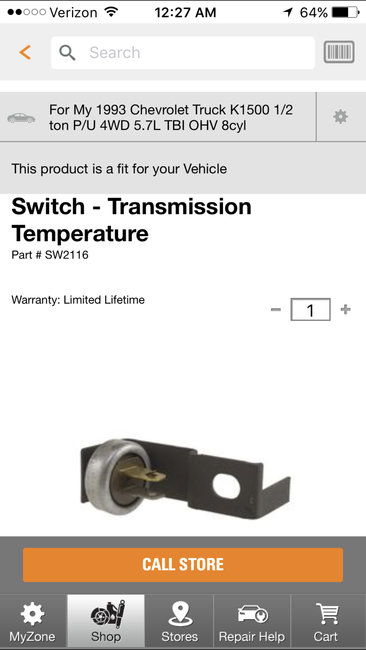

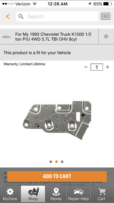

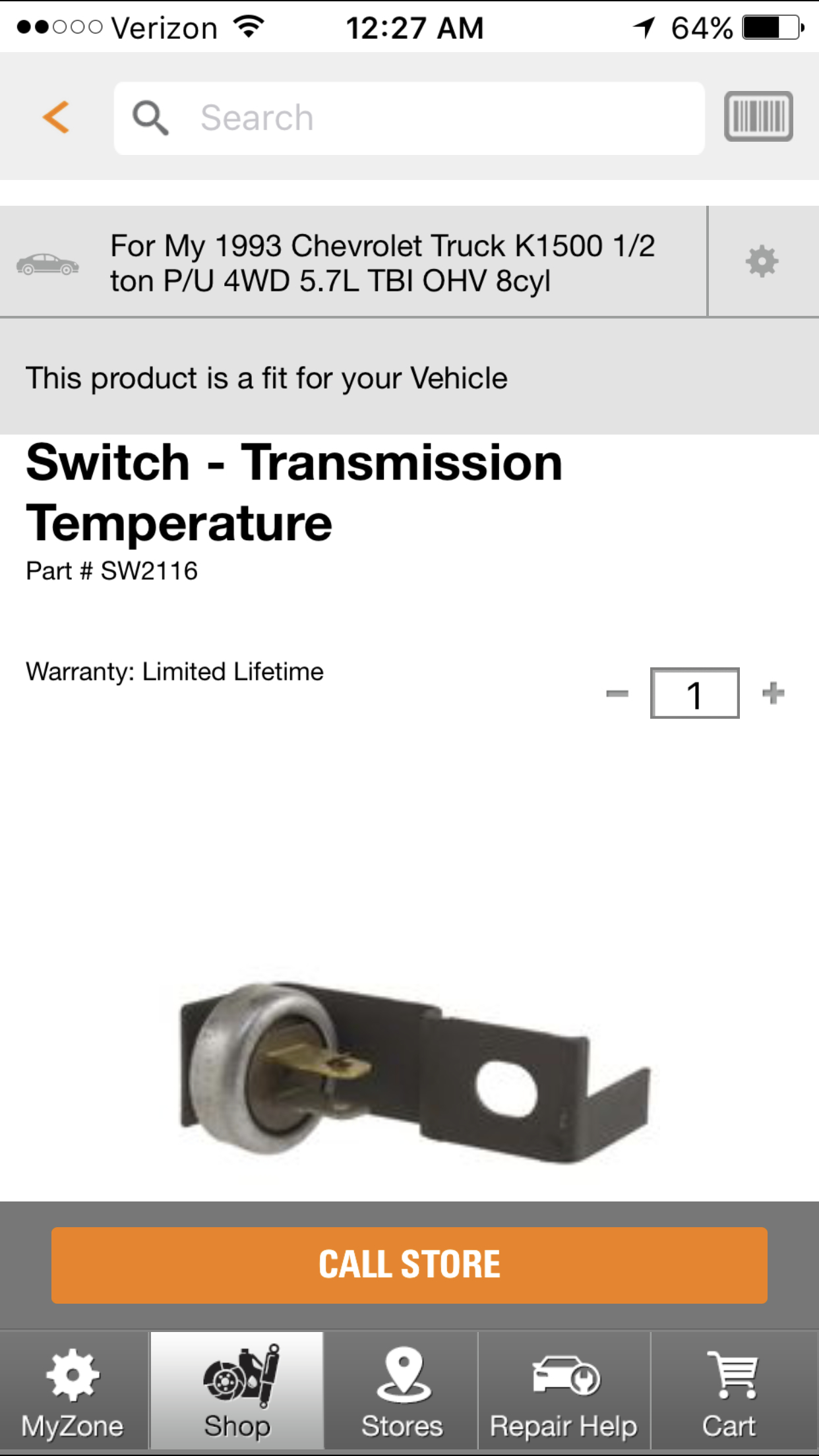

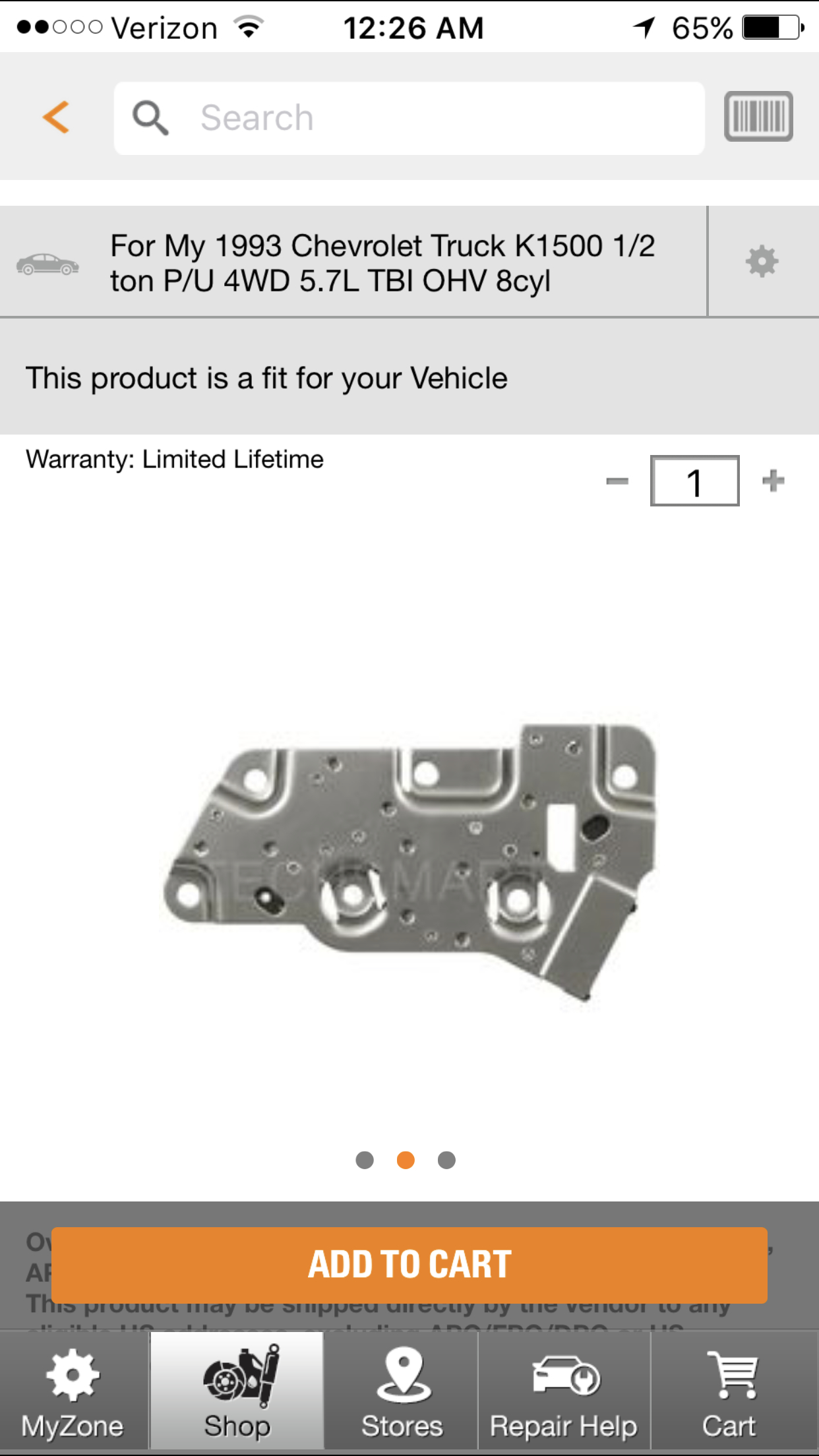

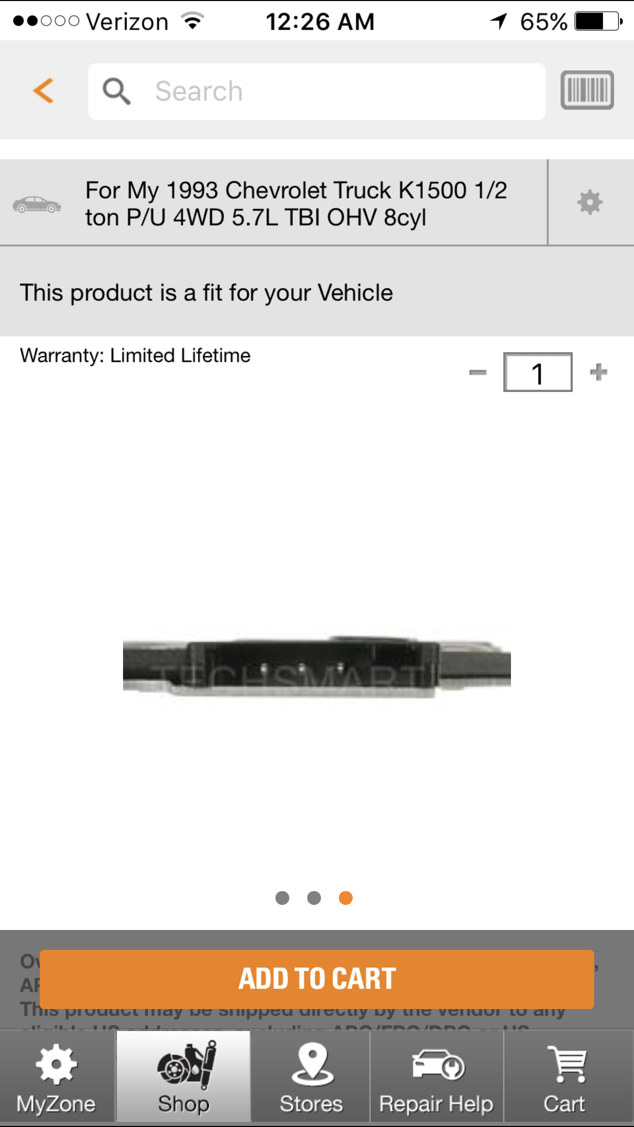

Ok. So I cleared the codes and they came back. I don't have a tester for the EGR. I might replace it and clear the codes again. What should I do for the 28 code I know that is the Auto Transmission Range Pressure switch error. What does the pressure switch look like and how do I change it. Here is a picture of what I have seen. Here is another switch in the 4 picture. Thanks.

Code 28 Is an injector driver error
https://www.2carpros.com/articles/buick-cadillac-chevy-gmc-oldsmobile-pontiac-gm-1983-1995-obd1-code-definitions-and-retrieval-method
You may have a bad computer? I would try a used one there are plug and play so that's easy.
