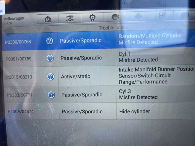

Starts and idles fine. These were the initial codes. I deleted them. You start the car idle is still fine, but the check engine is flashing, cylinder 3 and 1. They look like they have been changed. Do you think the runner flap can affect any of this? Engine revs fine.

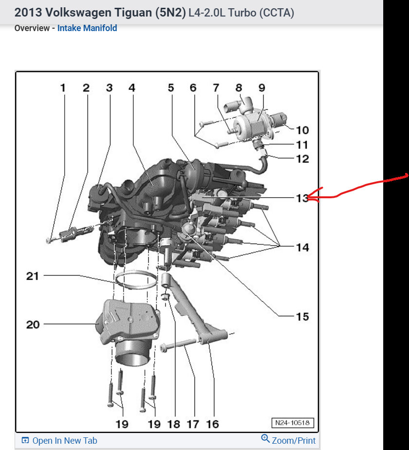

Yes, the intake runner control can cause misfire codes, I would check the valve and its operation, here is the location so you can check it out. Also, I would replace the spark plugs and service the throttle body. Check out the images (below). Please let us know what happens.

I thought number 5 is the runner or are you talking about the electrical part that controls it? How do I check it? remove it and see if it moves when I cycle the engine?

Runners work fine. Do you think this carbon build up is the reason? Not seeing the electrical part that controls the flaps, unless it is the one that has a vacuum line to it, but no way to test it.

Thanks for the videos. Yes, that is okay that one cylinder has its valve open. It looks like the flapper intake valve is working but about the actuator, does that seem to move at all? It looks like a normal build up, but I would clean the flapper valve and intake runners.

What is the flapper valve? Am only moving the rounded black piece which has an arm.

Yes the part inside the intake looks like it is working I was asking about the actuator part.

What actuator part, how do i check it?

It would be the part that attaches to the flapper arm. See if it moves when you turn the key on?
