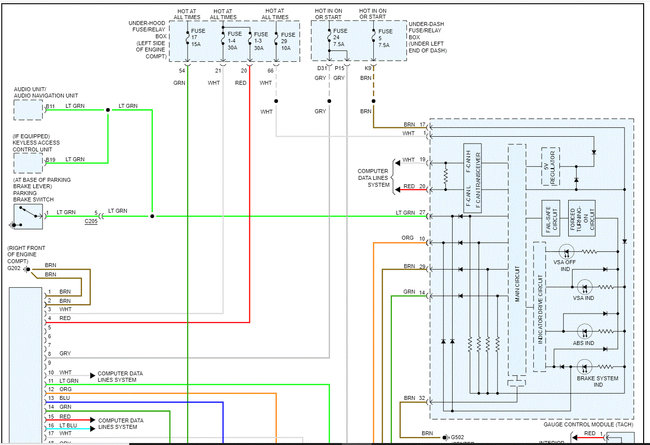

After an accident, the ABS wiring, and ABS pump was damaged someone got a new harness wiring from a Honda dealer cut off part of the wiring needed, and made up the new connection, after that a lot of codes came out the vehicle was brought to me. I discovered some wires in the wrong place after soldering and put back all together SVA and TPMS and Airbag came out to the dashboard car run well, the tool on the steering wheel allow to relearn the TPMS, but after that came back immediately.
Mar 10, 2022 at 10:05 AM
  • 110,241 POSTS

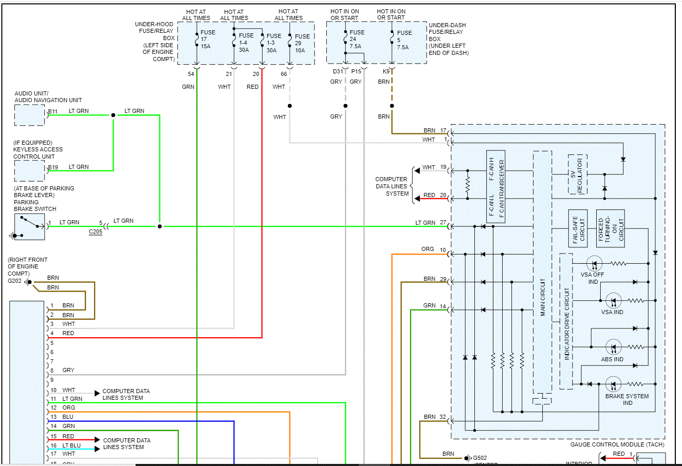

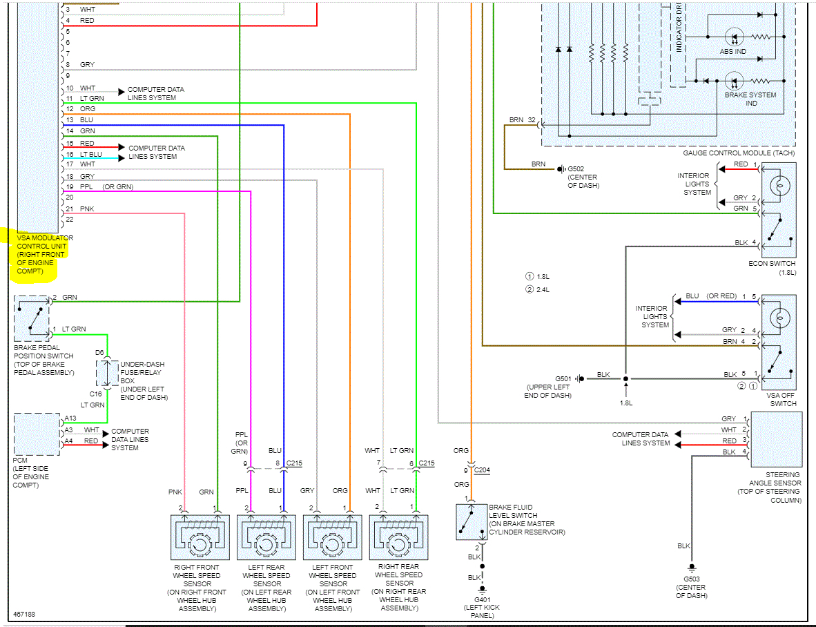

It sounds like there are still wiring issues. What codes are presently stored? Also, I don't know if you have them, but I attached the wiring schematics for the ABS system.
Take a look through the schematics to confirm nothing was mixed up. Also, the schematic is for a non-hybrid sedan. If that is wrong, let me know.
Take care and let me know.
See pics below. Note: The schematic was only one page, but I had to cut it in half to make it readable for you. Also, I did overlap the two pics so you can follow from one to the next.
