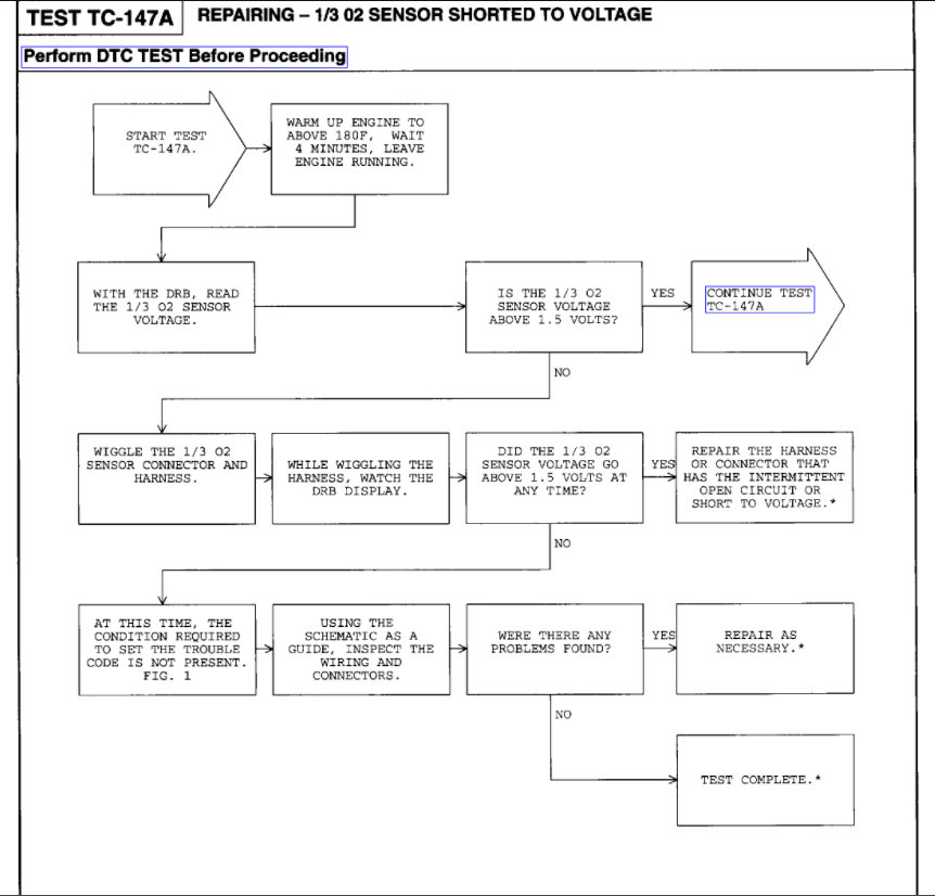

p0144 check engine light.
Jun 17, 2021 at 5:52 PM
Good morning,

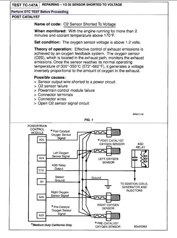

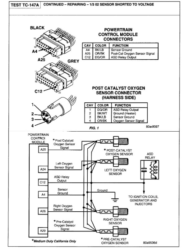

This code is for a short to voltage for the sensor. The most common issue is the heater portion of the circuit has the short. There is a power and ground at the connector for the circuit.

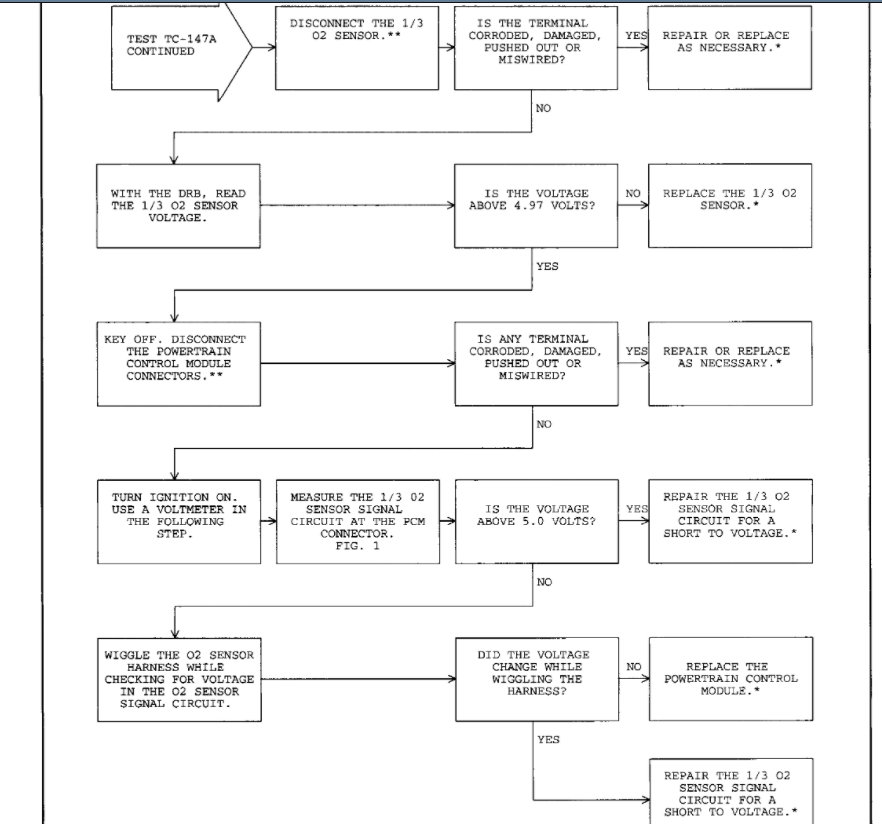

Disconnect the connector and check the voltage at pins 1 and 2 at the connector. You should have battery voltage.
Let me know the results. I attached the flow chart below for you to follow.
