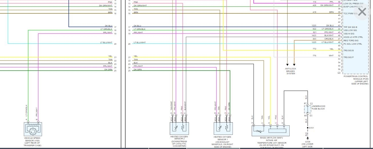

My vehicle is throwing five codes two that are the same. P0030, p0128, p0035, p0030 and p0035 in that order. I am just wondering where I should other? Is one more common than the other?

The 128 is a bad thermostat. You need to replace the thermostat.
P0030
P0030
Descriptor
Probable Causes
Diagnose Other DTCs First
Heated Oxygen Sensor (HO2S) 1 Heater Control Circuit
Heated Oxygen Sensor (HO2S) 1 Ignition 1 Voltage Circuit Short to Ground
Heated Oxygen Sensor (HO2S) Heater Low Control Circuit Open or High Resistance
Heated Oxygen Sensor (HO2S) Heater Low Control Circuit Short to Ground
Heated Oxygen Sensor (HO2S) Heater Low Control Circuit Short to Voltage
Heated Oxygen Sensor (HO2S) Terminals Shorted or Poor Connections
O2S Fuse
Powertrain Control Module (PCM)
Powertrain Control Module (PCM) Terminals Shorted or Poor Connections

Sorry that was p0135 HO2S sensor heater circuit malfunction bank 1 sensor 1.
Apr 12, 2019 at 3:52 PM
Thanks.
Below are the possibilities for the code. In most cases, it is the sensor.
P0135
Descriptor
Probable Causes
Heated Oxygen Sensor (HO2S) Ignition 1 Voltage Circuit Short to Ground
Heated Oxygen Sensor (HO2S) Intermittent Condition or Poor Connection
Heated Oxygen Sensor 1 (HO2S)
Oxygen Sensor (O2S) Fuse
Powertrain Control Module (PCM) Intermittent Condition or Poor Connection
Apr 12, 2019 at 3:55 PM

Thank you very much. Going to change the thermostat first and go from there.
Apr 12, 2019 at 3:59 PM
Sounds like a plan.
