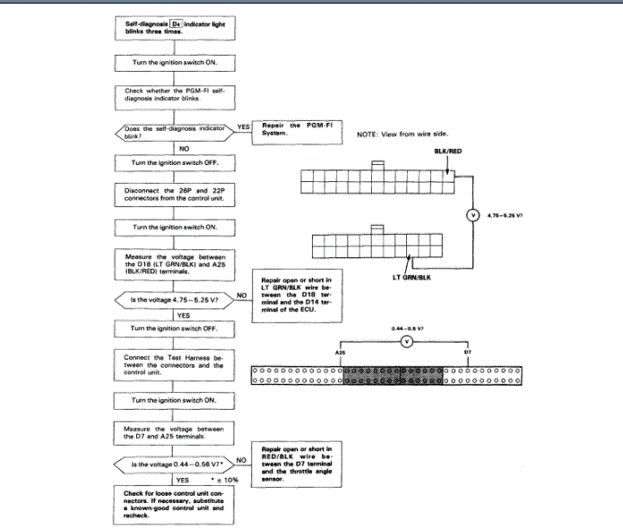

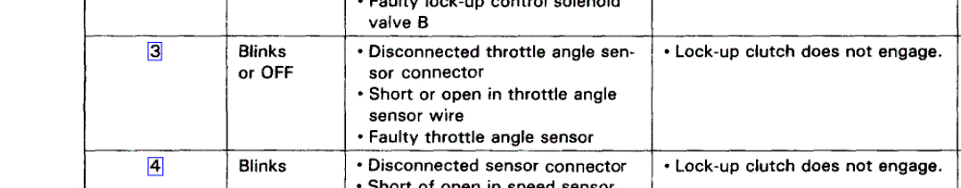

When I do the self diagnostic it comes up code three one which is a/tf1 or l signal b. what does signal b mean?
Aug 17, 2020 at 12:47 AM
Good morning,

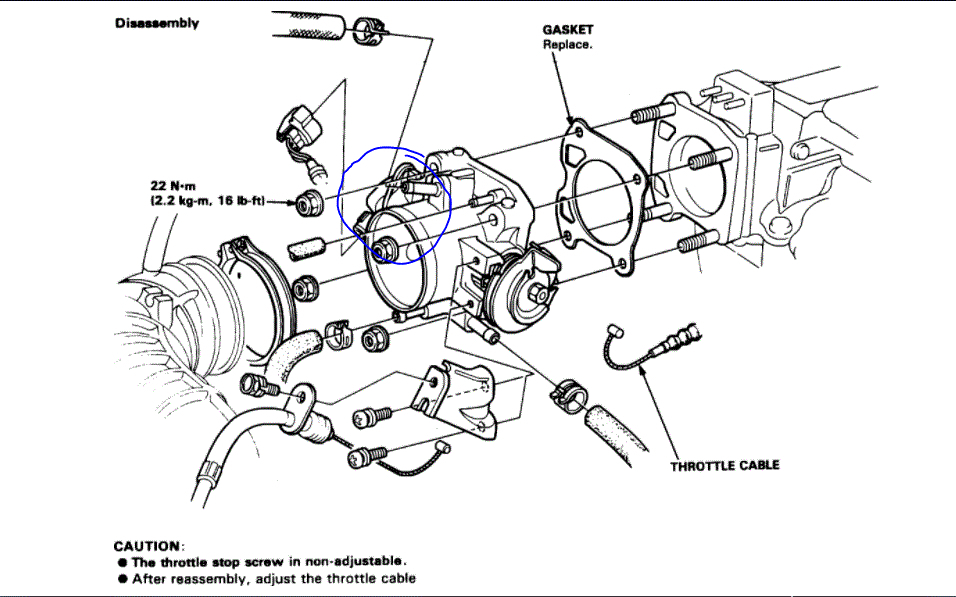

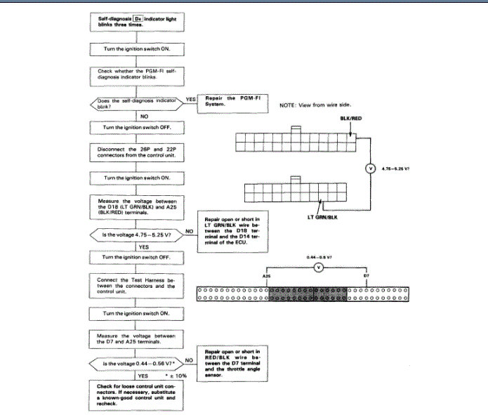

The code is for the throttle position sensor. The signal is not being seen at the ECM.
I attached the flow chart and the description for you.
In most cases, it is the sensor itself.
