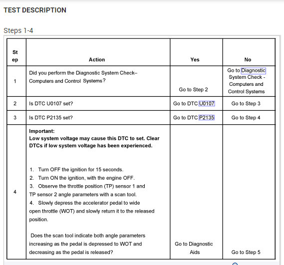

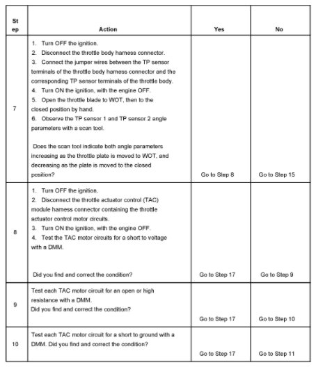

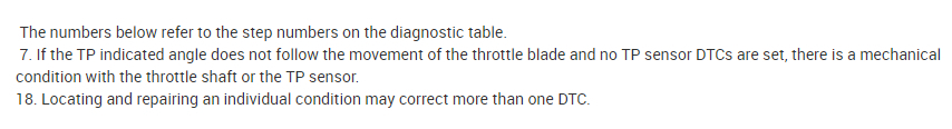

I have a code 1516
256,000 MILES • 6.0L • V8 • 2WD • AUTOMATIC
GARYSIMPSON
  • 22 POSTS
Code 1516.
May 17, 2021 at 5:21 AM
DANNY L
  • 5,648 POSTS
Hello, I'm Danny.

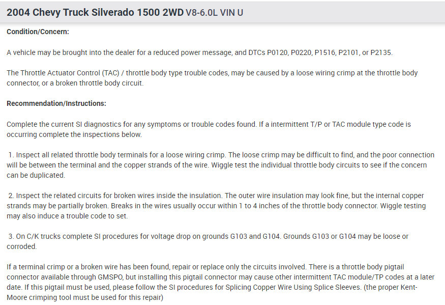

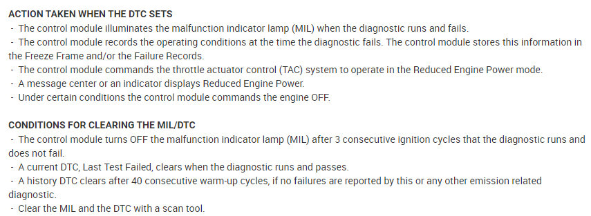

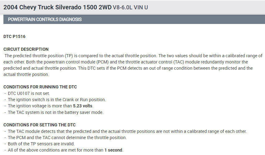

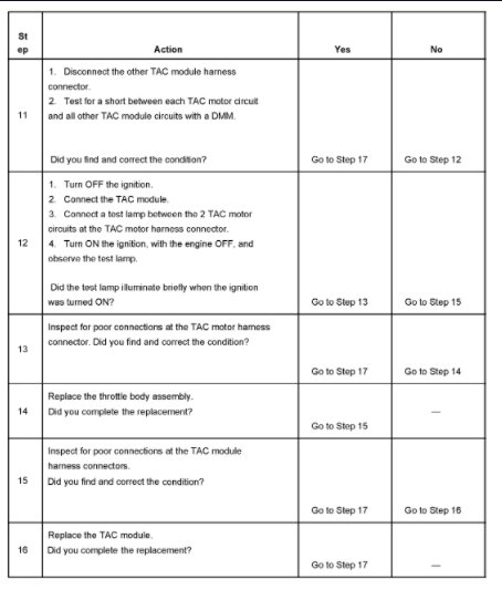

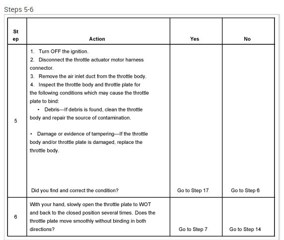

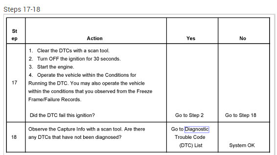

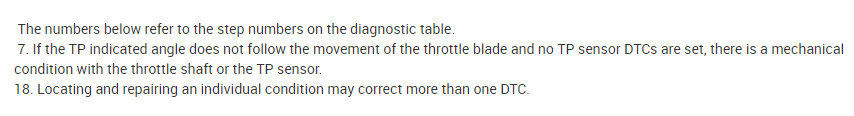

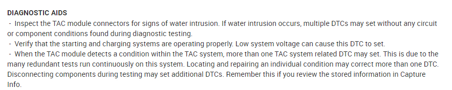

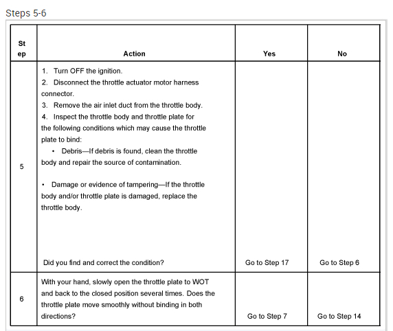

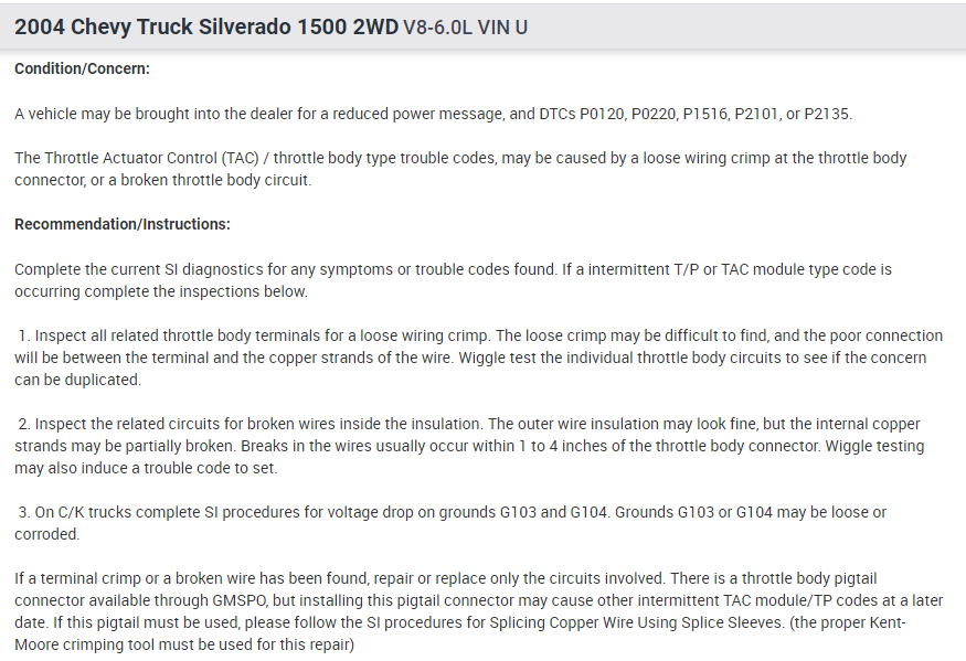

Here is the information you requested. The code P1516 is related to throttle position. I've attached diagnostic flow chart steps below relating to that code for your truck. Hope this helps and thanks for using 2CarPros.
