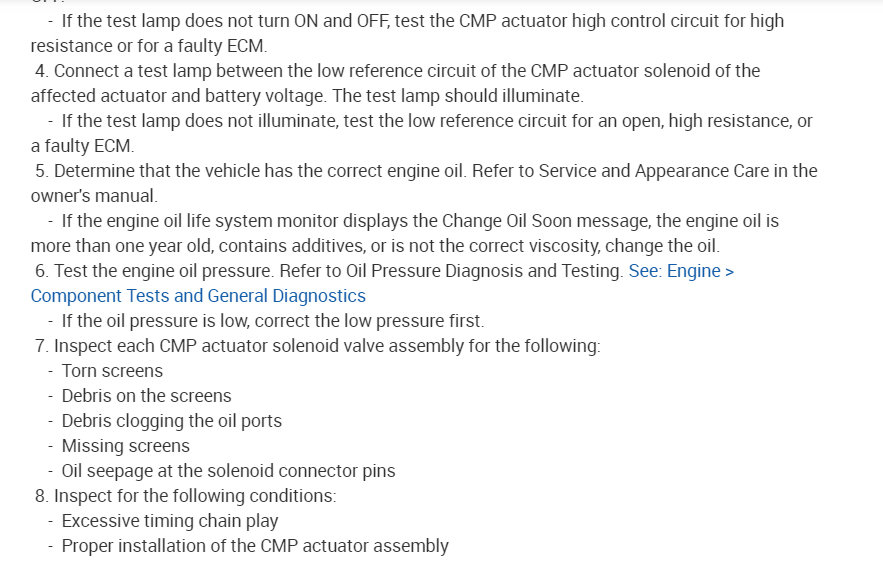

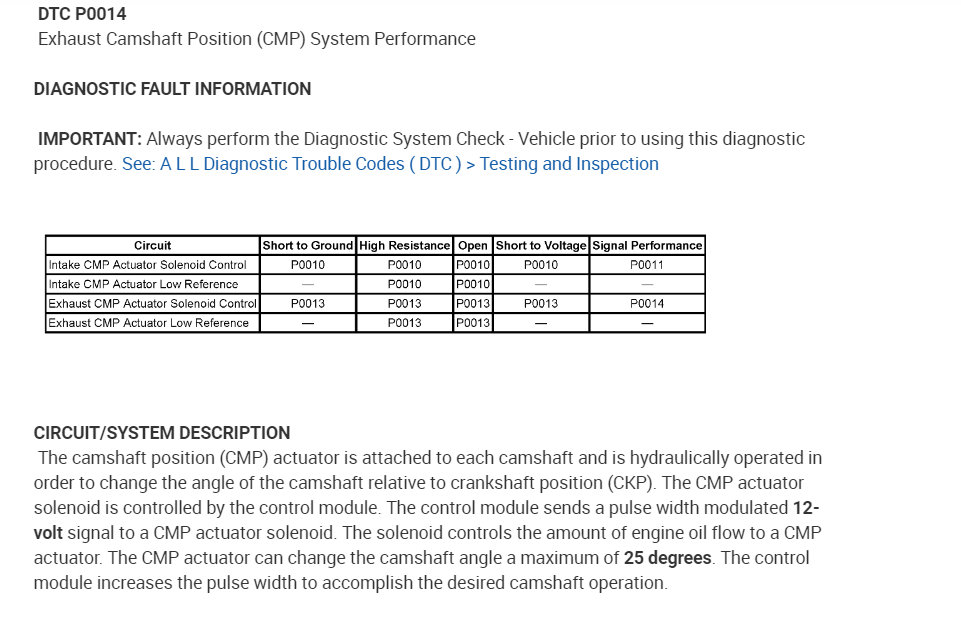

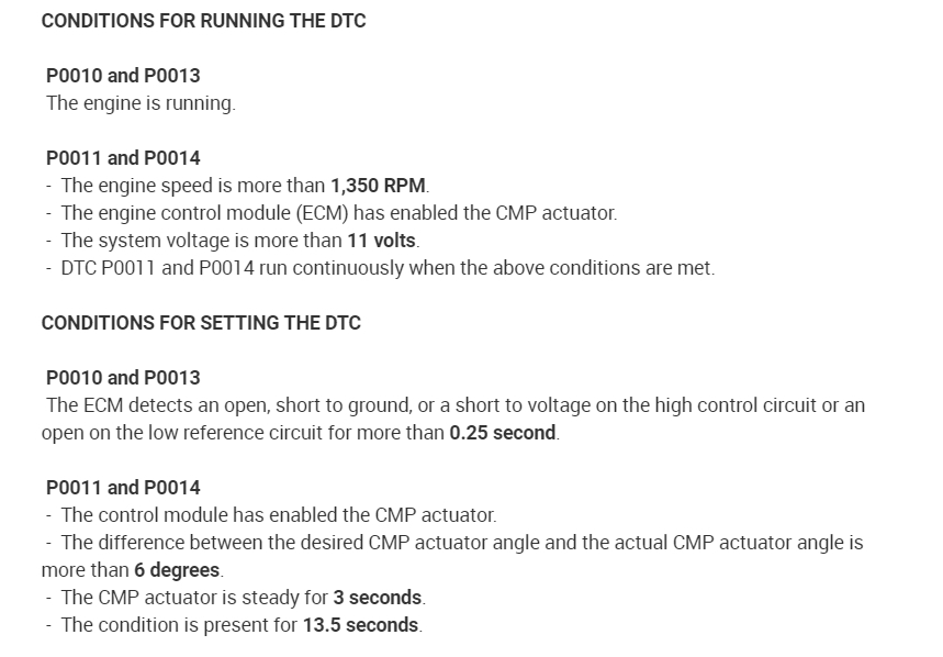

I have the listed above three codes that are popping up. Which code will keep it from cranking?
Aug 31, 2019 at 2:42 AM
SCGRANTURISMO
  • 4,897 POSTS

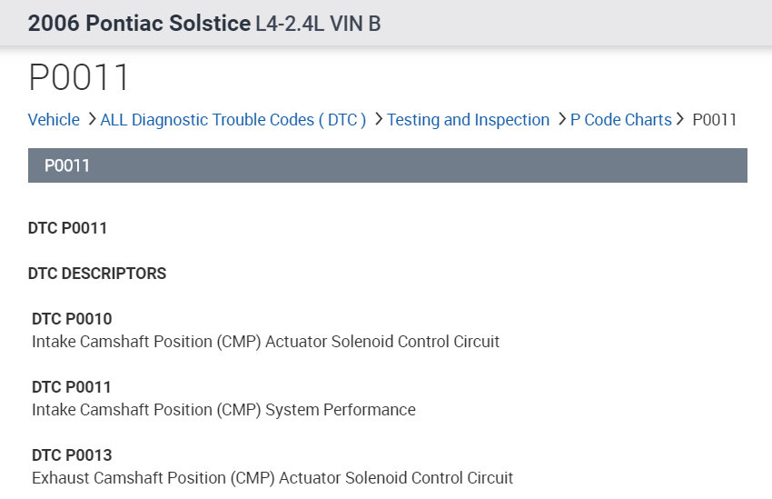

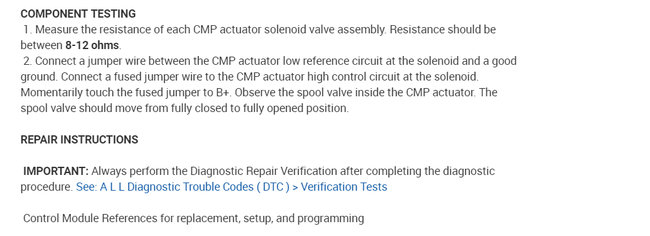

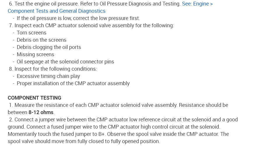

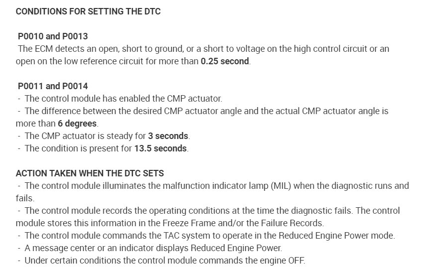

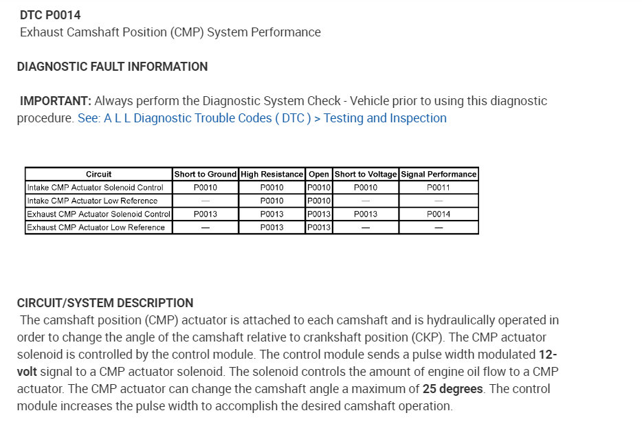

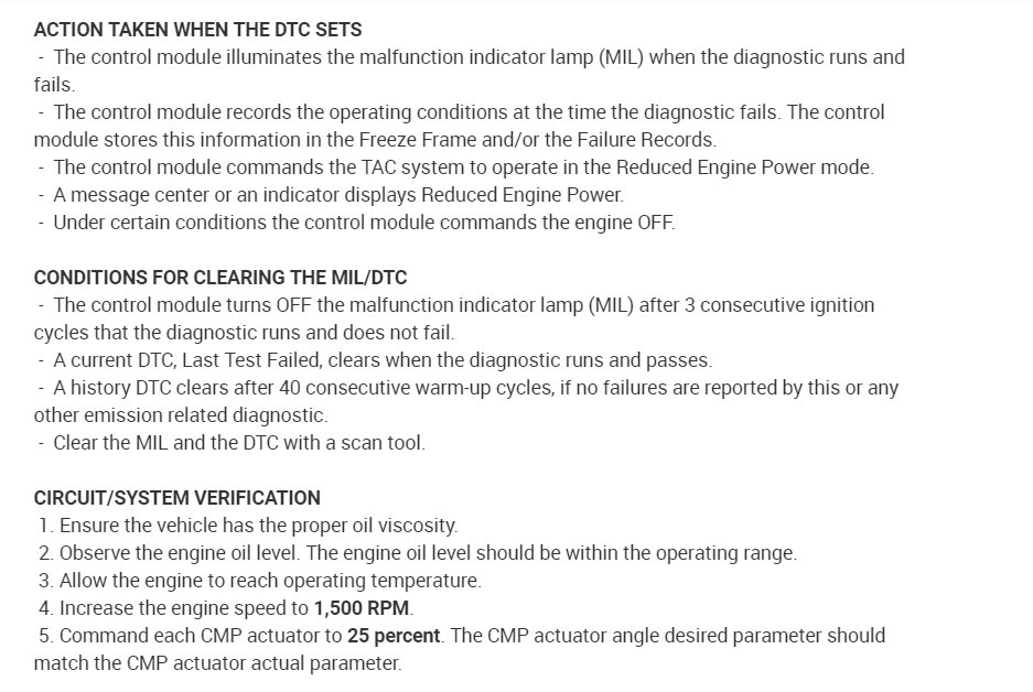

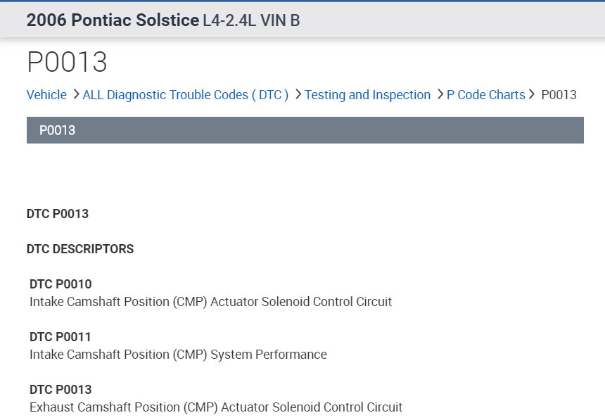

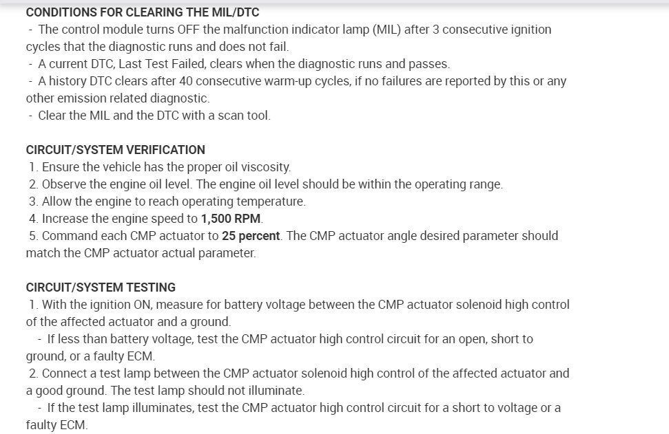

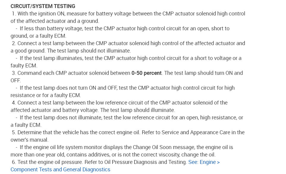

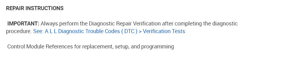

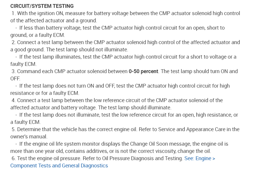

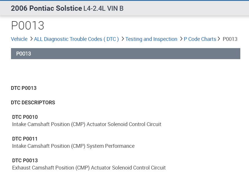

There is no Direct Trouble Code (DTC) P07e8. DTC's have a letter (P,B,U,C) followed by four numbers. In the diagrams down below I have included the factory diagnostic troubleshooting guides for DTC's P0011 and P0013. Please go through these guides and get back to us with what you are able to find out.
Thanks,
Alex
