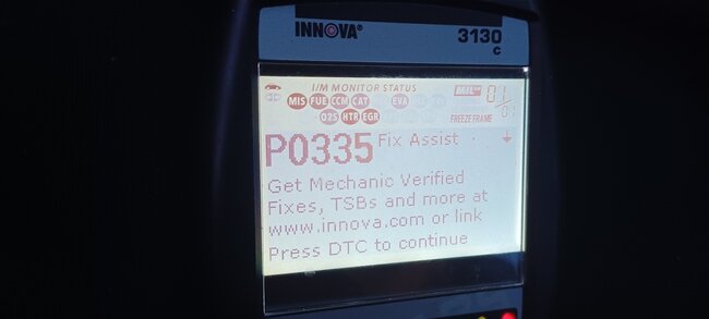

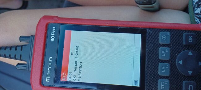

New code popped up, P0335. Used 2 different code readers and screens said slightly different things. Maybe the same but worded differently? Any information would be greatly appreciated!

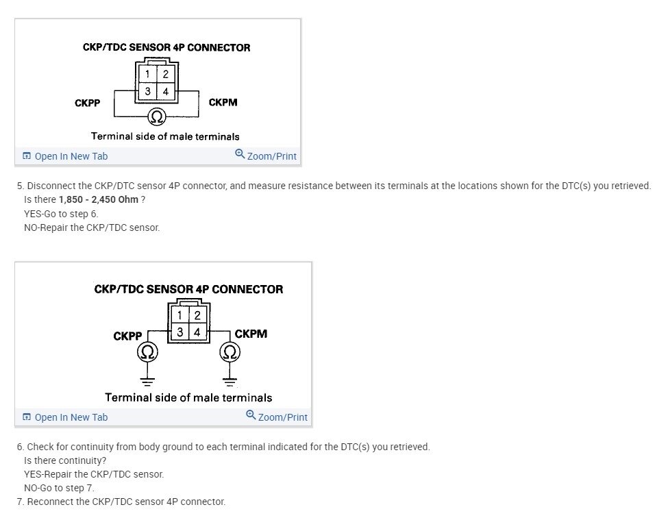

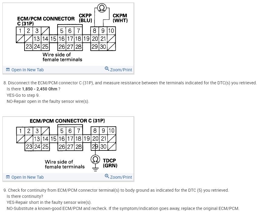

The first one appears to want you to select the DTC button to go farther. The second one is showing the core and the definition. The OE version of the definition is "No signal in CKP Sensor Circuit" that means the crank sensor signal isn't getting to the ECU. Either the wiring or sensor has a failure. The images are the test procedure for the sensor and wiring.
