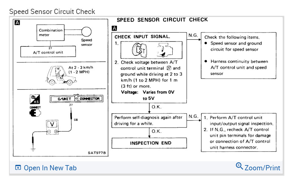

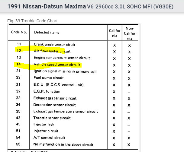

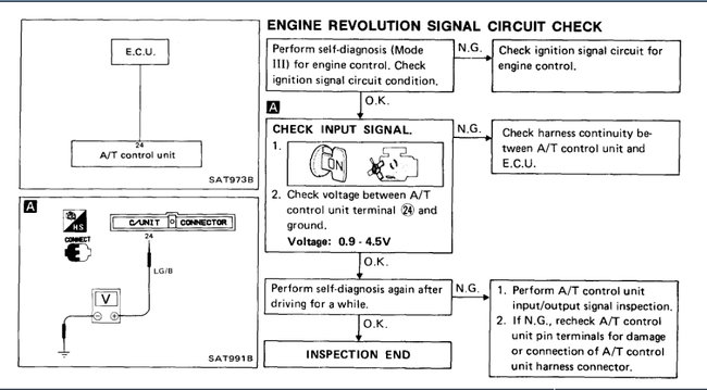

The odometer and speedometer do not work. The tachometer shows it idle at 4,000 but idle is fine. This is how I got the car, not much of its history was provided. Also, I know this might be a totally different problem. The overdrive does not kick in as if it’s stuck in a high gear. If I remove the air filter seems to work fine.

Next, pic 1 below identifies the codes. Pics 2 and 3 are the diagnostics specific to the codes you gave me. Take a look through them and let me know if you are comfortable performing them.
