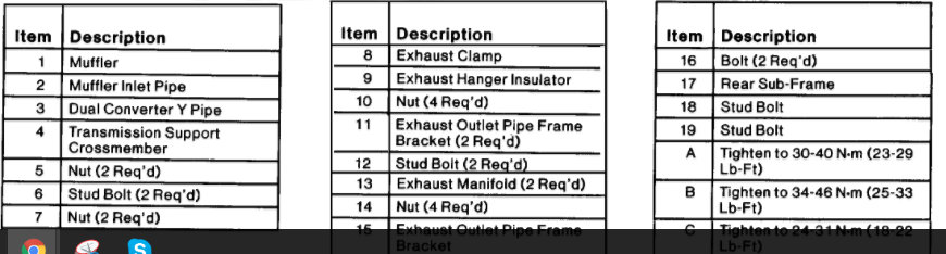

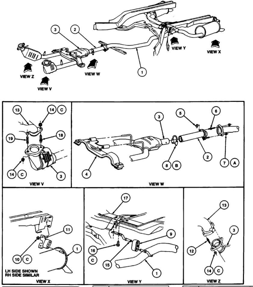

My husband did a vacuum test and he came to the conclusion its a clogged converter. He said there's no way to get it off. The way the tbird is made you can't hardly get to anything. Any suggestions?
Oct 25, 2017 at 9:04 PM
  • 55,433 POSTS
Those are a tough on but it can be replaced, Here is a guide that will give you an idea of what to do to fix the problem.
https://www.2carpros.com/articles/catalytic-converter-replacement
You will need to raise the car up safely,
Here is what it will be like for your car (below)
