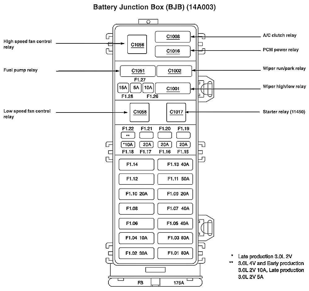

i will be using my first scan-tool in a a few days two erase some codes i guess that i will hav4a bad alternator after i fix it and i am not going2plug the alt.n i am erasing code first.can anybody give me the full definition of freeze frame and tell me where that i can find my fuelpump shutoff switch or fuse and a fuse that i can pull2go back2regular brakes and if i was jumpstarting off of the starter what is the proper procedure&what is the proper procedure4pulling the starter relay&using a jumper wire to start the car.and what&where is the pats module on my car?can u plez reply back to my e-mail is (abo6dat@gmail.com)asap?thx.

Fuel pump inertia switch only trips if the car is jolted real good, it is behind the right wheel arch. Fuse 16 is the pump fuse.

Thank you for your answers can you tell me how many amp fuse that i should be looking for to pull? in case that it might have the wrong cap on the fuse-box?

This should be the box. Fuse F1.16 (20A) powers the fuel pump through the relay.
