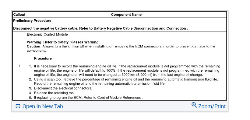

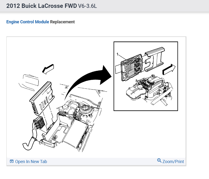

It sounds like the PCM went out or you have some fuses out. you can get a preprogrammed unit by searching Google or Ebay.
If the fuses are okay, I would replace the PCM.
Here is a guide to help and the instructions for your car in the images below:
https://www.2carpros.com/articles/how-to-replace-a-vehicles-main-engine-computer-pcm-ecm-ecu
The OBD-II trouble code U0100 stands for "Lost Communication with ECM/PCM."
