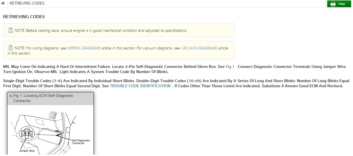

CJ MEDEVAC
  • 11,004 POSTS
MAYBE THIS WILL DO SOMETHING?
SEE MY "PRODEMAND" SCREENSHOT BELOW
