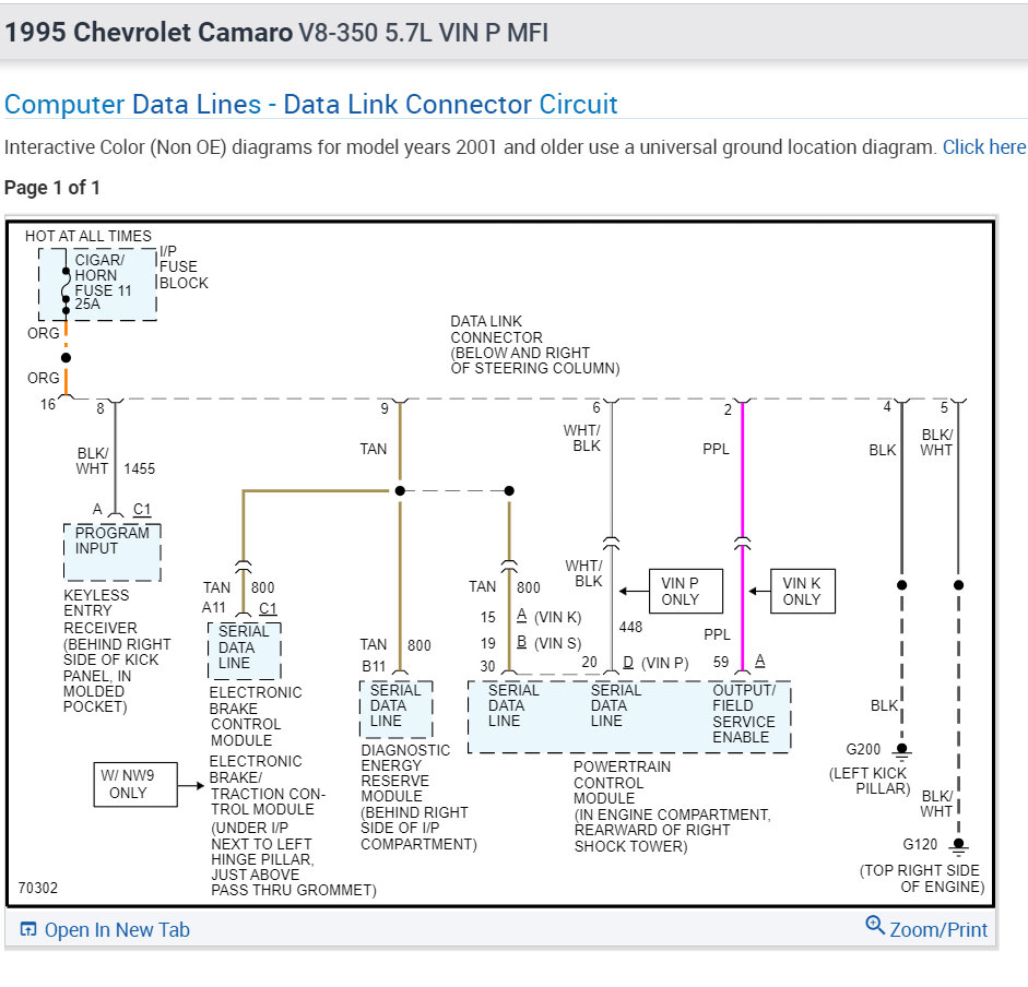

  • 55,770 POSTS
I hear you; can you check the orange wire at the OBD1 connector for power? This guide can help, we will find the problem hang in there.
Check out the images (below). Please let us know how it goes.

TOMMY ROBB
  • 17 POSTS
Yes, the orange wire has power.
Oct 12, 2023 at 6:44 AM
  • 55,770 POSTS
Good, now check the blk and the blk/wht wires for ground at the ALDL.
Just connect the test light to the power side of the battery.

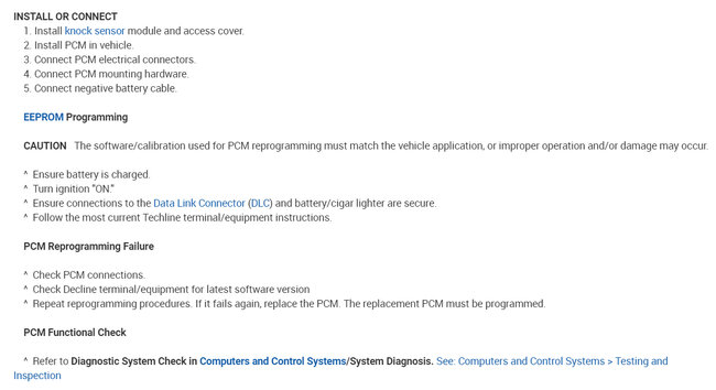

So, I wired the security box back up and everything works with that now. The car starts if I give it a little gas, but it backfires, and I have to keep foot on gas pedal or it will shut off. if I try start without foot on gas pedal it just almost starts and shakes the hole car pretty bad I don't know what to do, and I tried to read codes by jumping a wire to the a+b ports and nothing happens. Any help would be greatly appreciated. Thank you in advance.
Oct 17, 2023 at 2:46 AM (Merged)

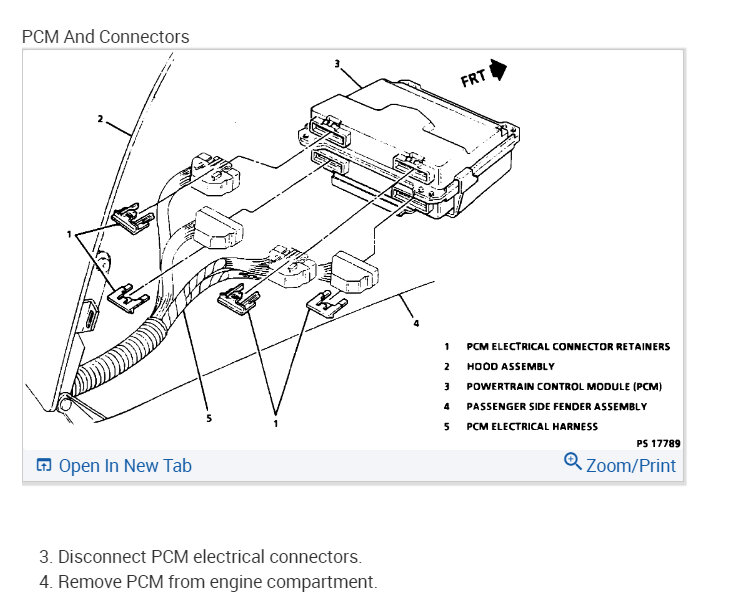

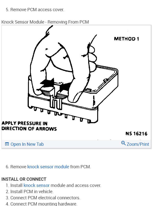

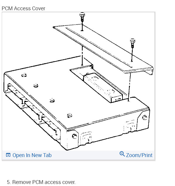

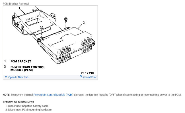

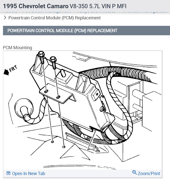

  • 55,770 POSTS
I would check all fuses and if okay I would send the PCM in for testing, here is the location and how the job is done. Check out the images (below). Please let us know what happens.
