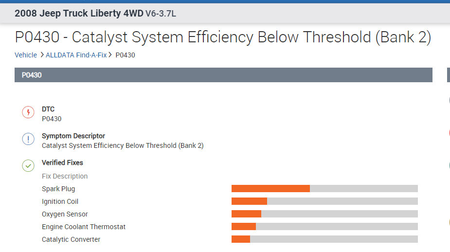

It is unlikely that the new engine would have caused this to happen. The code is for a bank 2 catalytic converter.
By chance, do you know if they replaced things like spark plugs or other things when the new engine was installed? I attached a pic below that indicates in descending order the most common repairs for this code.
Let me know. Also, let me know if that is the only code, and when you say it doesn't run as well as it did before, let me know what is happening.
See pic below.
