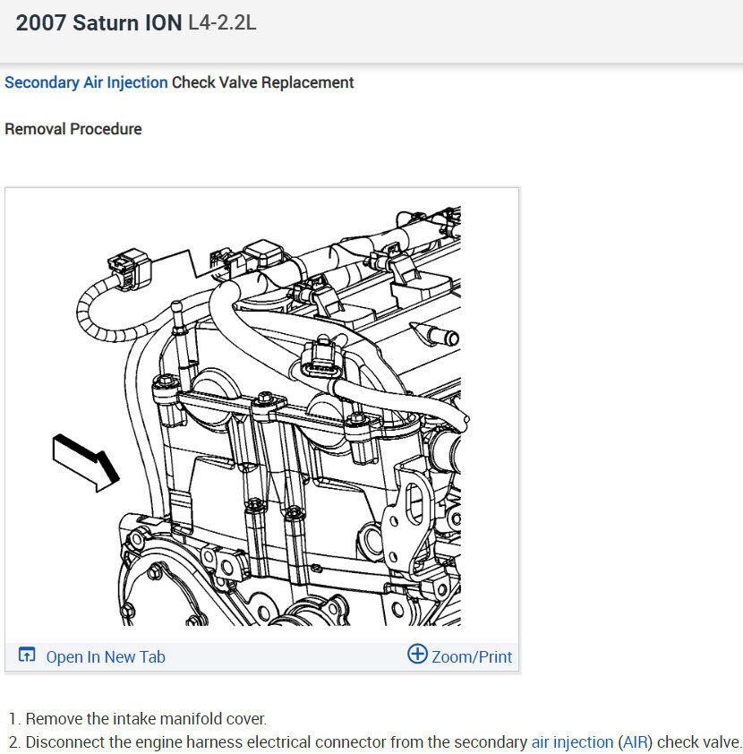

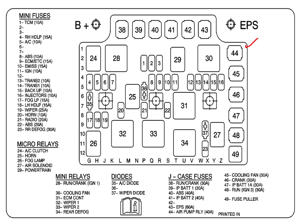

Code p0411, I replaced the secondary air injection motor?
2007 SATURN ION
165,000 MILES • 2.2L • 4 CYL • 2WD • AUTOMATIC
JOEBLOW86

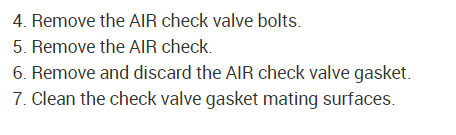

I replaced the secondary air injection motor. Code keeps coming up. What else should I replace? Thank you.
Oct 6, 2024 at 6:29 AM
  • 55,433 POSTS

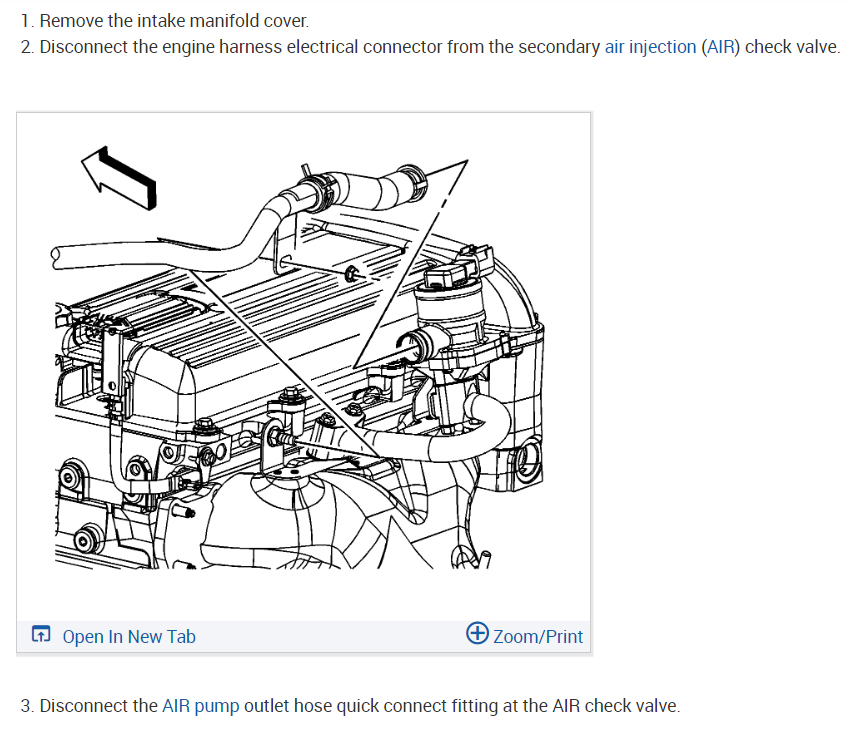

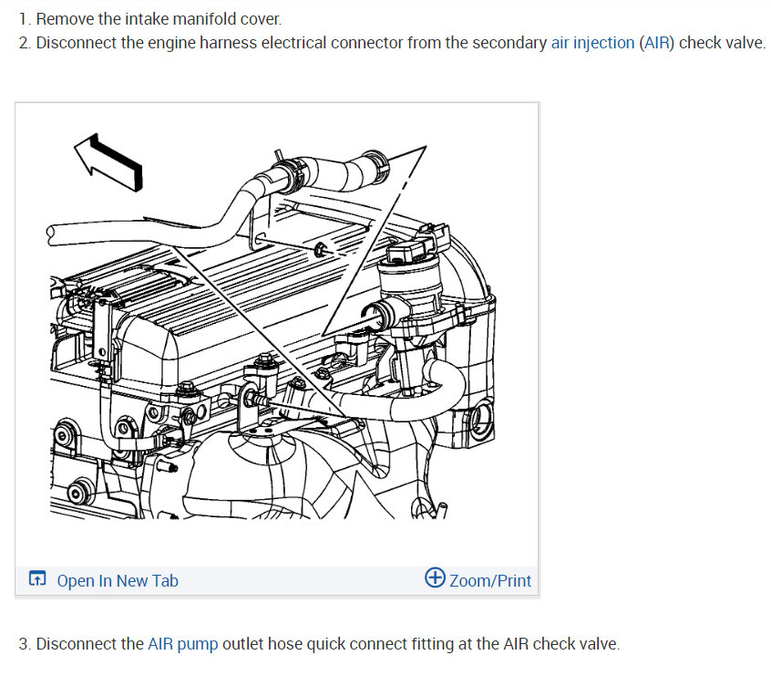

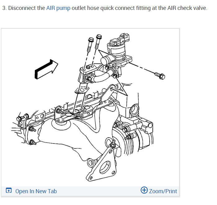

So, what happens is the air check valve ends up going bad. I would remove the valve, you should be able to blow through it one way only. If you can blow through it both ways it is bad. Also, I would swap out the air pump relay because they can burn up once the air pump motor goes bad. Check out the images (below). Please upload pictures or videos in your response of any problems so we can see what to help you with.
