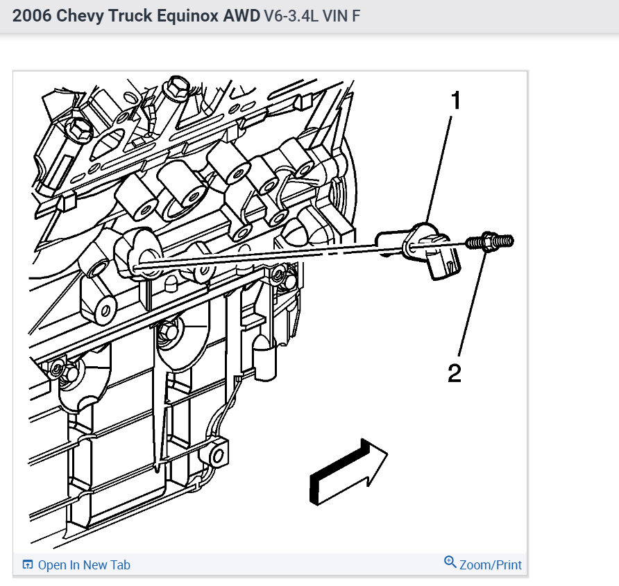

Now the car will not start? Code p0355
2006 CHEVROLET EQUINOX
130,000 MILES • 3.4L • V6 • 2WD • AUTOMATIC
PRRYPERRYS
  • 150 POSTS

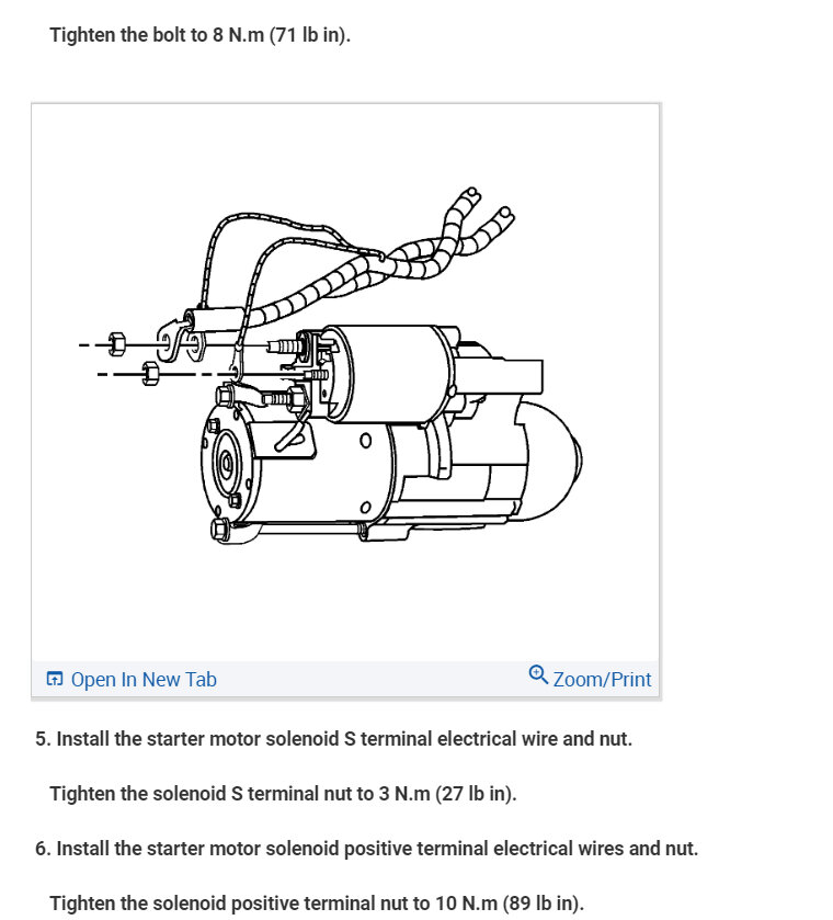

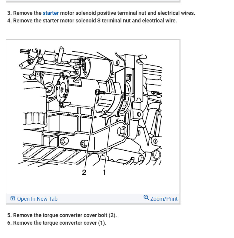

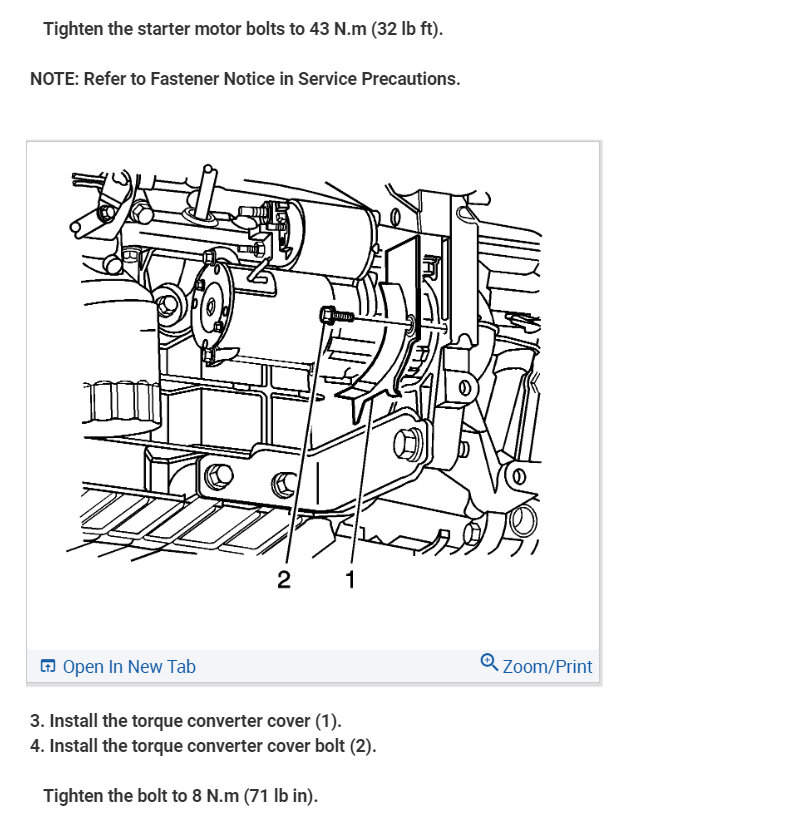

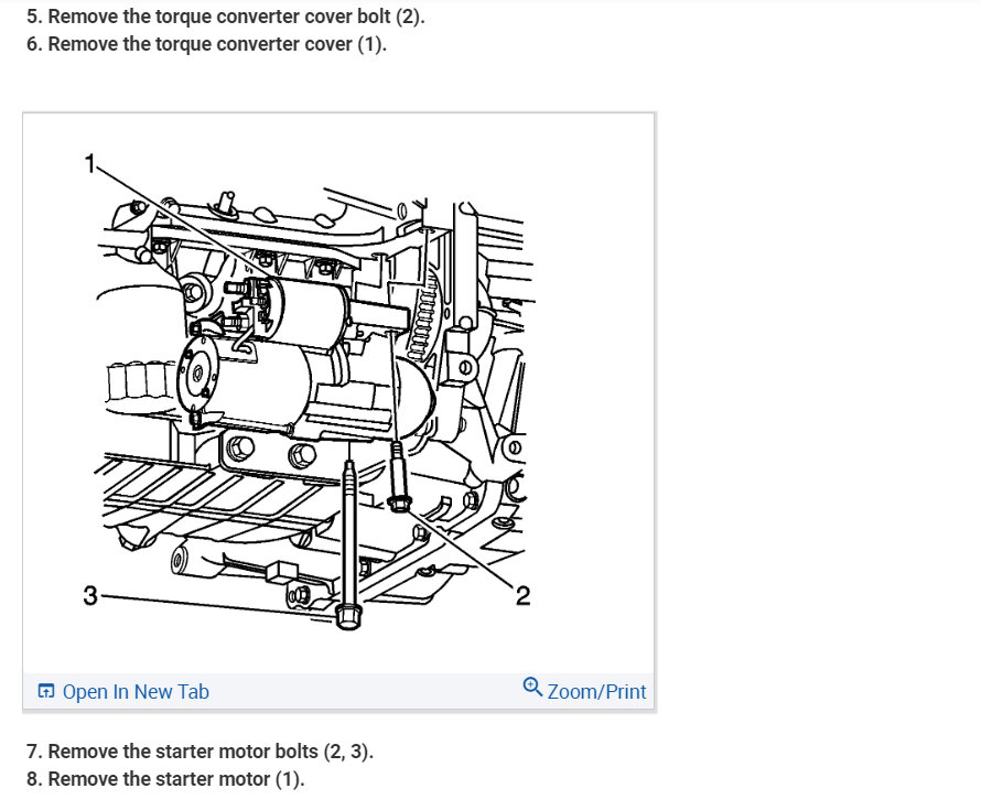

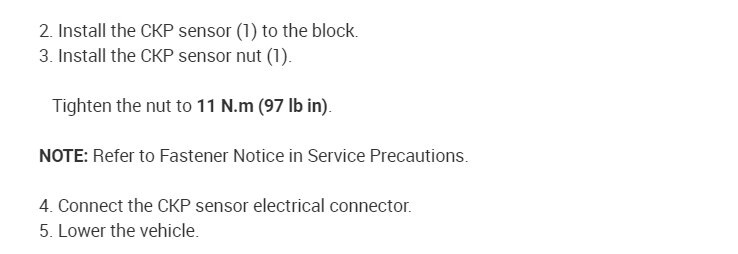

I had Code p0355. I changed the crankshaft sensor. Now the car will not start. I don't know if it's something else. I turned the key I heard nothing, no click, no turning, absolutely nothing at all. Lights and radio come on. But when I turn the key absolutely nothing no clicks no turning nothing at all.
May 16, 2023 at 9:11 PM
  • 55,381 POSTS

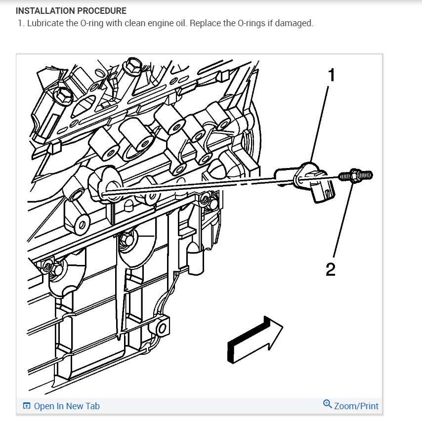

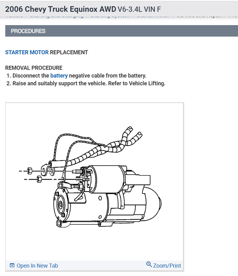

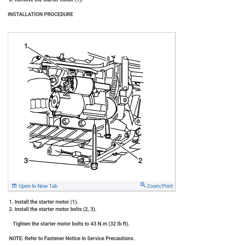

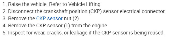

It sounds like the starter has gone bad or you have a bad connection at the battery, here are two guides to help us see what's going on and I have included how to change the starter out in case you need it. Also, I would remove the new sensor to see if it is too long and contacting the crankshaft.

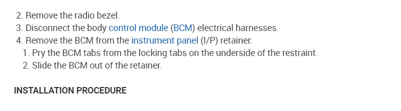

Hey, my friend hope all is well I don't know why I keep listening to my friend at home I know they mean well. So, I upgraded my scanner battery was dead as you said so I upgrade scanner for better results here are the codes that I got Would not let me upload picture #1.body control module fault 21, # 2 supplemental inflatable restraint fault 1 # 3 anti-lock brake system fault 1 # 4 electric steering fault 1.
Jun 10, 2023 at 5:27 AM
  • 55,381 POSTS

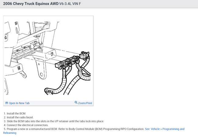

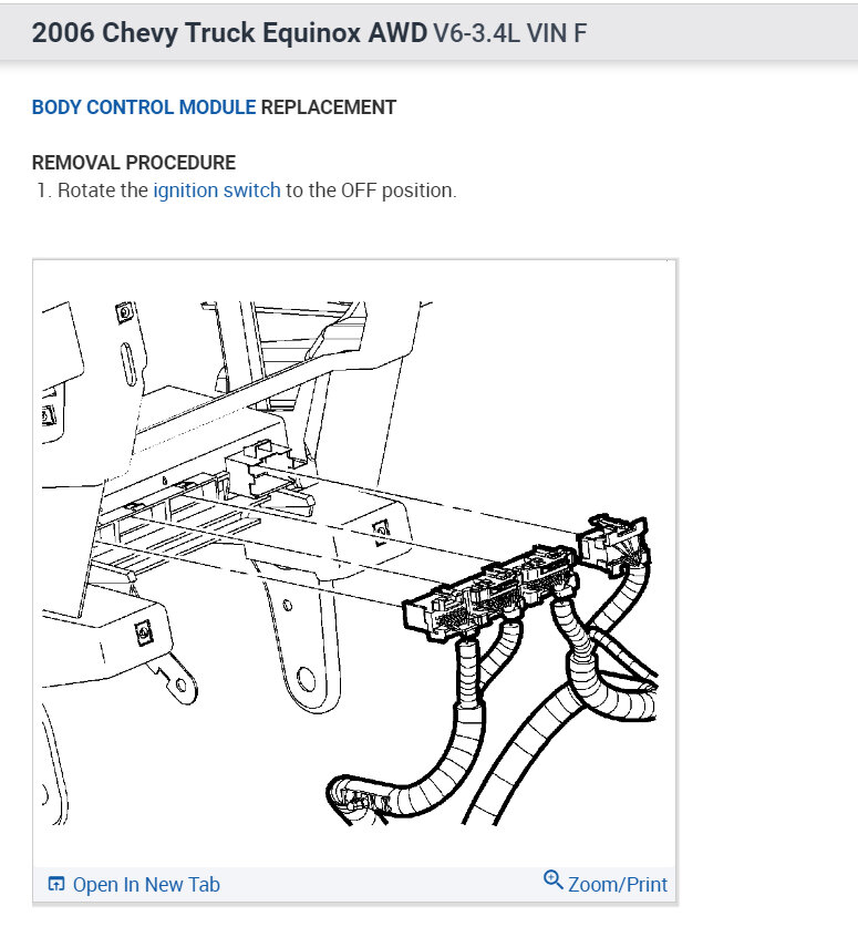

The BCM can cause all of the problems you are having but I would check the fuses first. Here is the location and how to change the BCM out. Check out the images (below). Please let us know what happens.

Good morning, Ken, my friend, I hope all is well. fuses look good I will order a BCM I understand how to put it in but I'm not too sure about programming. I will keep you informed. thank you. Kenny

Good morning, my friend hope all is well. I just changed the BCM about twenty minutes ago car is still doing same thing will not start is there a relearn or program or maybe I missed a fuse in checking. then I only checked the one under hood could not get down to under dashboard on drive side due to my health.
Jul 9, 2023 at 10:09 PM
  • 55,381 POSTS
Was the BCM perprogramemd? Also is the security light flashing when you try to crank the engine over?
Jul 10, 2023 at 3:33 AM
PRRYPERRYS
  • 150 POSTS
Hey, my friend, I don't know if it was programmed. I bought it used from a parts store offline. Ebay and just put it in my car.
The security lockout light is blinking now. Before I changed BCM it was not blinking it was just on.
Jul 10, 2023 at 5:55 AM
  • 55,381 POSTS
It must be preprogrammed, or you will have this problem of the security lock out.
Jul 11, 2023 at 3:21 AM
PRRYPERRYS
  • 150 POSTS
How do I program it?
Jul 12, 2023 at 3:47 PM
  • 55,381 POSTS
You must send it in to be programmed or have a scanner capable of doing so from data collected from your old BCM.
