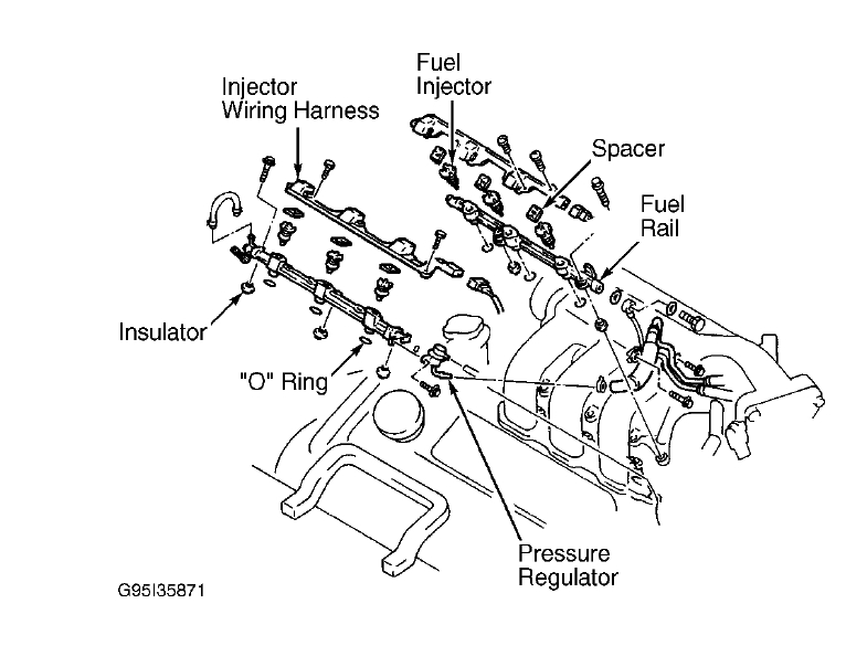

misfire number two cylinder. I put in new spark plugs , wires and distributor. still misfire code, Ray

hello,
Have you checked the injector number 2? if the pulse from the control unit present, you can use a noid light for injector pulse test its the easiest way. also perform compression test at cylinder 2 compare with others.
check our links below how to fix miss fire.
https://www.2carpros.com/articles/how-to-test-a-fuel-injector

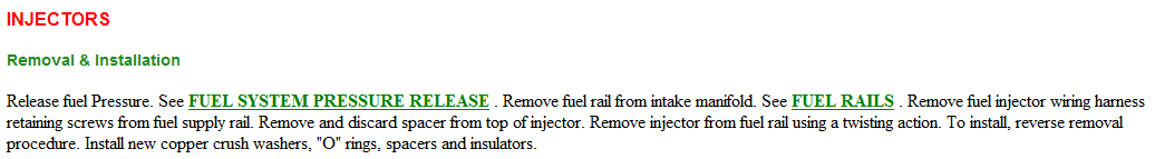

check the pictures below how to remove and reinstall injectors
Hope these procedures help, lets us know if you need more help.
