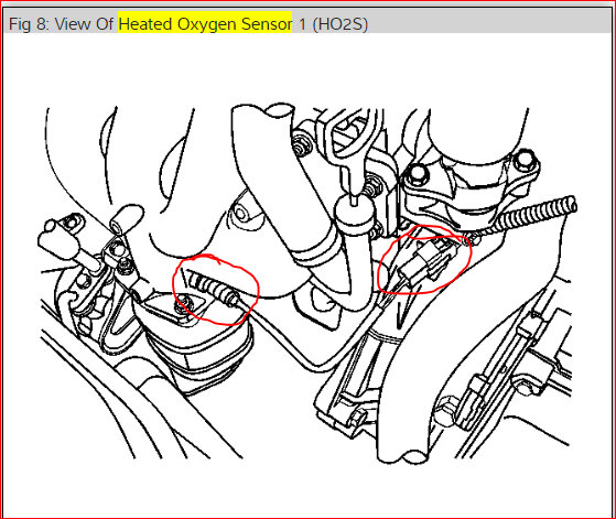

Have a code po133. I want to know which one the top or bottom?

That would be Bank 1 Sensor 1 (Upstream-Top). I have attached a picture of location (circled in red) and also a link showing how to replace. Hope this helps and feel free to ask any other questions if needed. Thanks for using 2CarPros.
