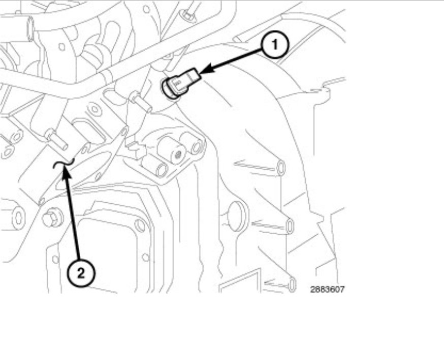

Check engine light came on. Got code from O'Reilly's of po128. Told it was coolant sensor. Where is that located on my car? I have replaced thermostat sensor already.
I bought a thermostat and sensor at the same time. I replaced sensor and engine light went off. Did not feel it needed the thermostat replaced.
Sep 30, 2017 at 10:15 AM
  • 55,808 POSTS
Here is a guide to show you what you are in for when doing the job and a diagram (below) to help you get the sensor replaced:
https://www.2carpros.com/articles/coolant-temperature-sensor-cts-replacement
and if the code comes back I would replace the thermostat .
Oct 1, 2017 at 5:39 AM
SATURNTECH9
  • 30,868 POSTS
I would be replacing the thermostat. I have had those Chrysler 200 set that code and it was a bad thermostat.The dealer had the thermostats on a two month back order. I had to get the thermostat on eBay.
