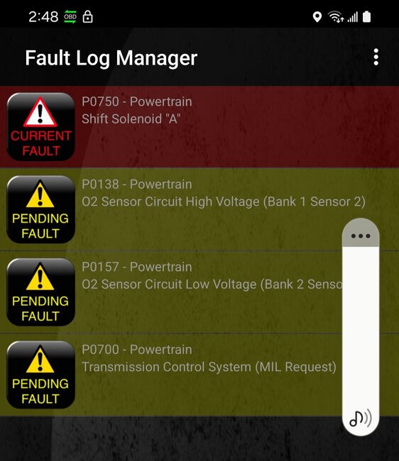

Received code P0705 CEL, replaced transmission solenoid pack, put everything back together, now won't shift into R or D without revving the engine up to about 3,000 RPMs. then it only shifts into gear temporarily.

it is code P0750 and P0700, this indicated Solenoid pack A, which is what I replaced, I added another qt of ATF+4 and it shifted into reverse a little easier but I still had to rev the RPMs to around 3K to get it to shift into any of the Drive gears. At no time did I get a P0705 error.

Sorry, I mistyped the error code, it was not P7050 but P0750, I did clear the codes in between in any case.

We have conflicting information, your scanner says shift solenoid, but the everywhere else I check the code is for the gear range sensor. Can you try a different scanner?

I used another scanner, the code its giving is also P0750 shift solenoid "a".

Okay, I see, this is a manufacturer code, I would take the unit back apart and check the filter to make sure it has not fallen out and is laying in the pan. If not, it sounds like the front fluid pump has gone out and the transmission needs to be rebuilt. You are getting the shift solenoid code because there is no or little fluid pressure to help the solenoid operate. You can do a line pressure test to confirm. It could also be the pressure regulating solenoid is not working correctly as well. Check out the images (below). Please let us know what happens.
