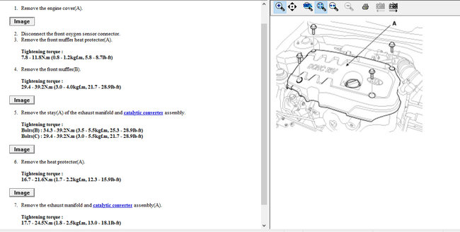

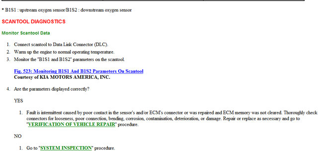

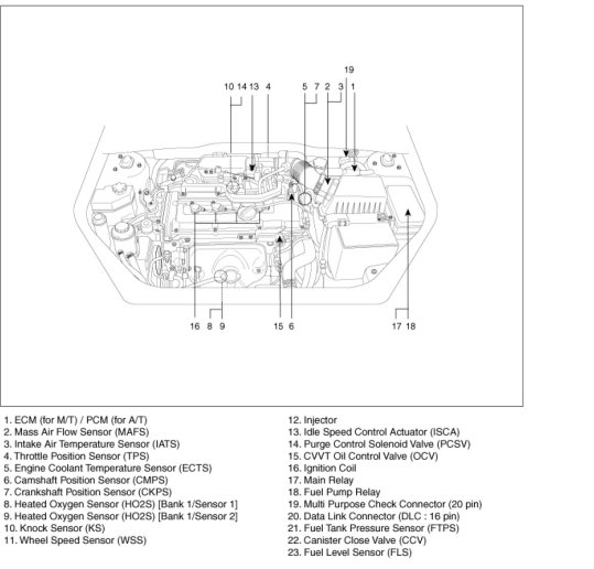

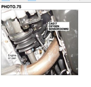

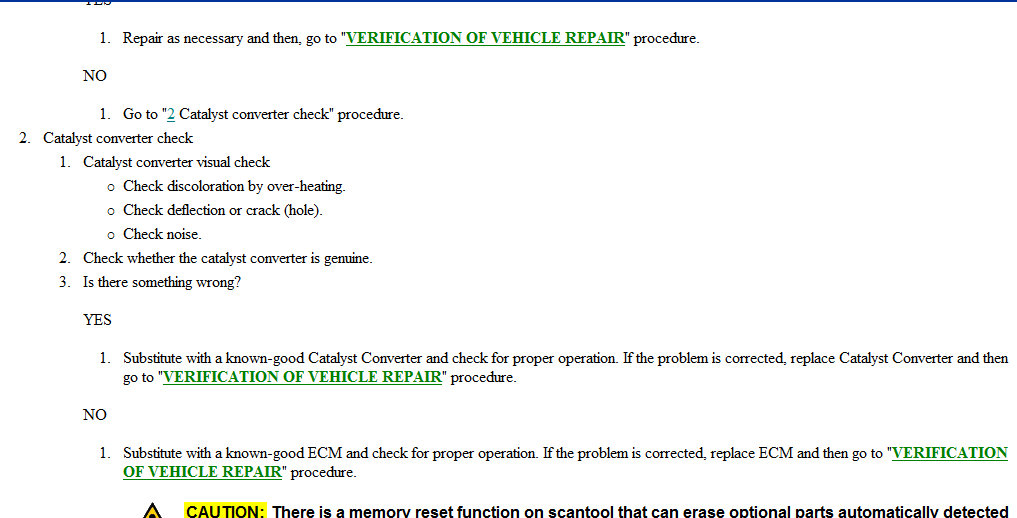

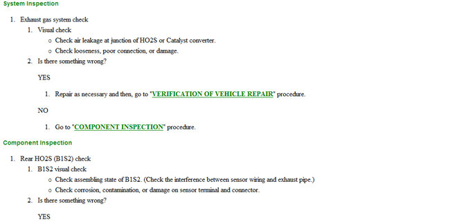

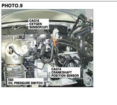

The check engine light is on with code P0420.

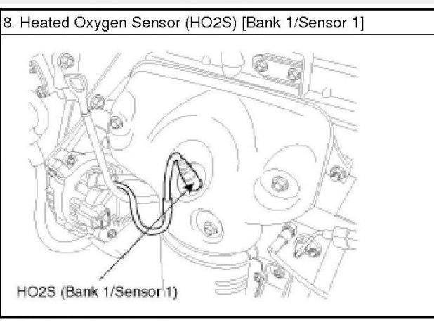

I already checked the 02 sensor the upstream S1 reads .2 to .7.
The downstream reads 0 volts.
I replaced both sensors with new ones and still the same.
I don't have any leaks on pipes or manifold .
Car shakes a little but not much RPM are around 800.
Please help.
Jan 18, 2021 at 3:31 AM
SEVAG P
  • 405 POSTS
hello

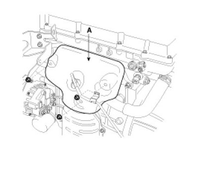

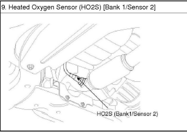

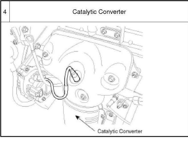

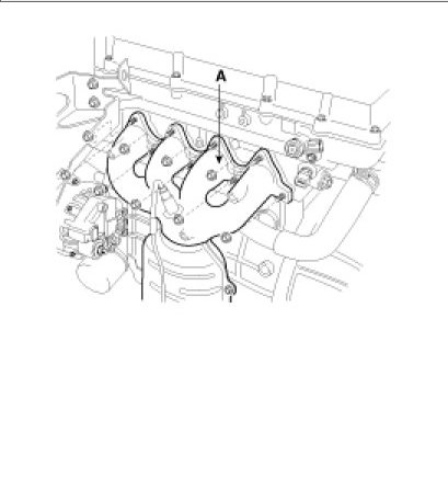

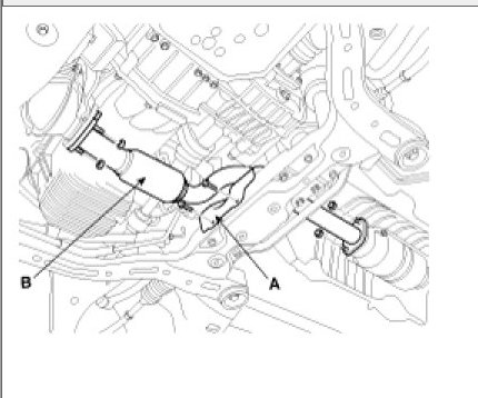

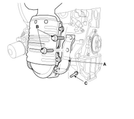

it sounds like catalytic converter must be replaced, its clogged or aged.
Here are a few tutorials to view about catalytic converters:
https://www.2carpros.com/articles/catalytic-converter-replacement

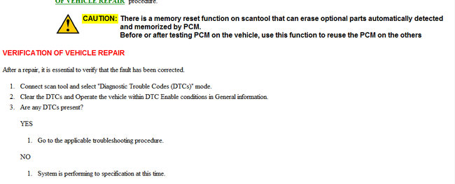

I've attached picture diagnostics steps below for your vehicle, and remove and reinstall the catalytic converter .hope it helps.
