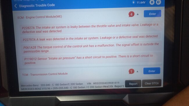

I performed a scan and these codes P22827A and P22797A are showing up. I did a smoke test and found everything to be good, no leaks. I was thinking about the PCV valve but I'm not sure. Any further assistance will be appreciated. Thanks

Did you check the air intake boot/tube between the throttle body and MAF sensor, this is where the leak will be not the intake manifold.
Code: P22827A Air system leak between MAF and throttle body
Code: P22797A Intake air system leak - air leakage detected

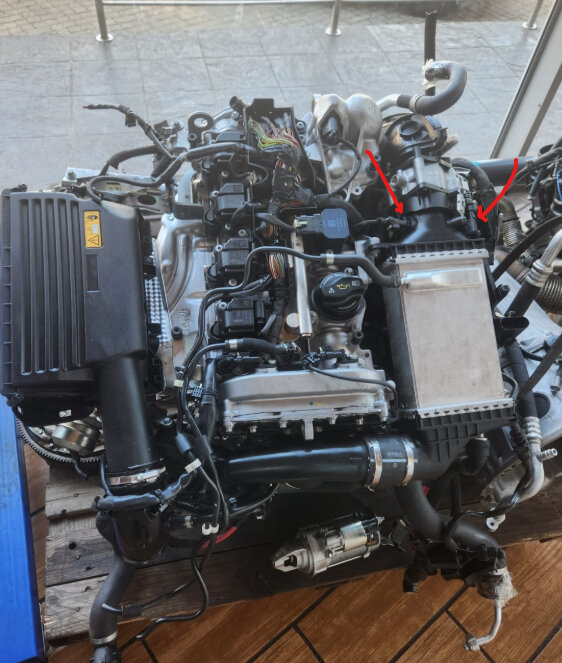

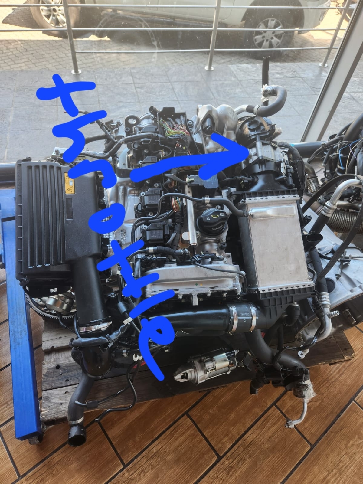

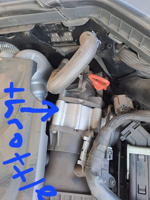

M274 is the model engine. Photos of the engine and diagnostic scan codes. When zoom in the photos there are 2 sensors opposite to each other before the throttle body. So it's 2 sensors, the throttle body and then intake manifold.
To note throttle body bolts directly on the intake manifold.

Also to mention P119012 code but i sorted it out.

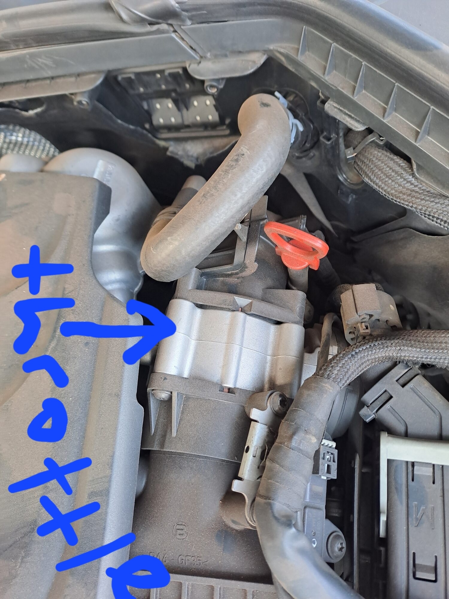

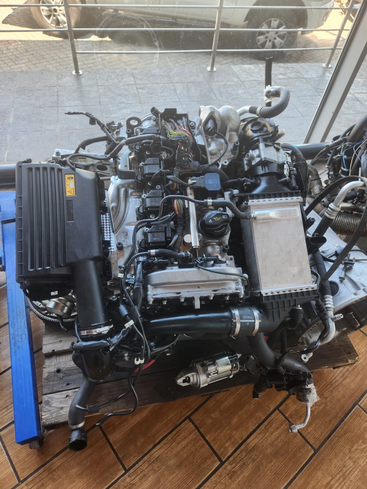

Photos of engine.
Apr 20, 2025 at 11:01 PM
  • 55,381 POSTS
I need better images of the engine intake but I marked where I think the sensor is. Check out the images (below). Let us know what you find.

The sensors on the left is TEMPERATURE SENSOR; AT CHARGING AIR INTERCOOLER.
The sensor on the right is PRESSURE TRANSMITTER AT CHARGING AIR INTERCOOLER.
