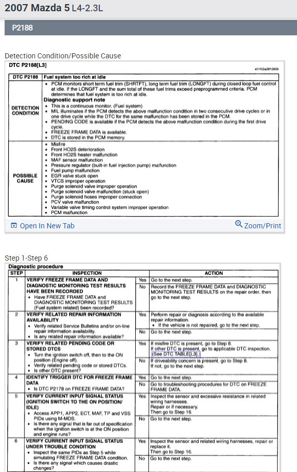

Check engine light turned on with codes p2188 and code p2404
2007 MAZDA 5
186,000 MILES • 6 CYL • 2WD • AUTOMATIC
LISA JONES
It shows no problem just engine light came on and these are the codes.

These are the code:

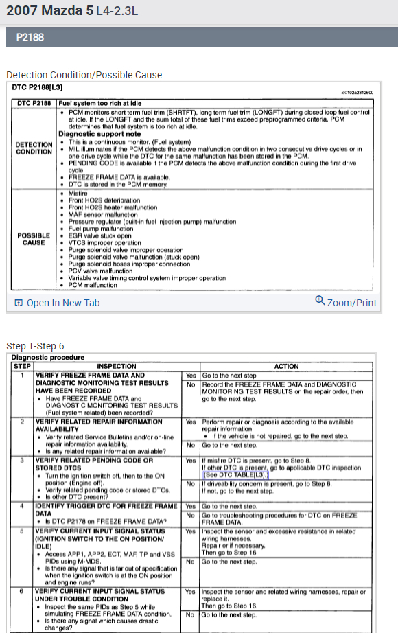

P2188: Fuel system too rich at idle.

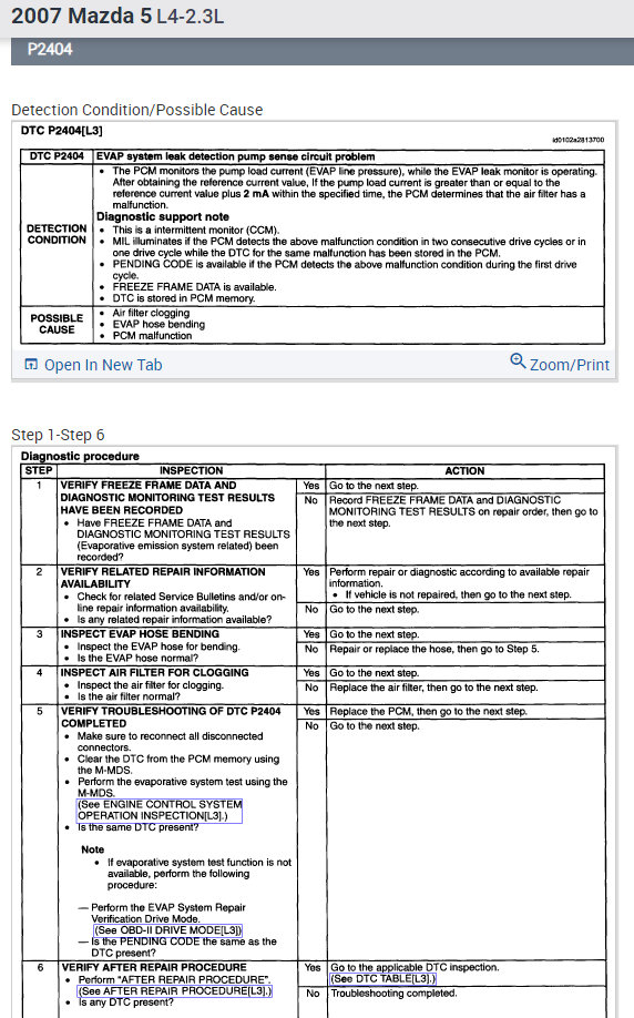

P2404: EVAP system leak detection.

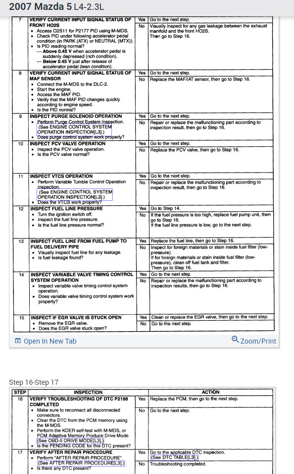

The code P2188 can occur for few different reasons. Primary reason could be having misfire or having a faulty oxygen sensor. It can also get triggered for mass air flow sensor malfunction.
P2404 can get triggered for any type of leak in the EVAP system. It could be a simple as a loose or defective fuel cap or a hose that is leaking.
https://www.2carpros.com/articles/evap-system-code-repair
I have attached the diagnostics for both of those codes. It should help you determine what is the reason you are getting those codes.
