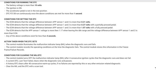

I've replaced accelerator pedal and throttle body and you can drive it about 20 miles until it warms up and it has no throttle.
Jan 1, 2020 at 6:50 AM
SCGRANTURISMO
  • 4,897 POSTS

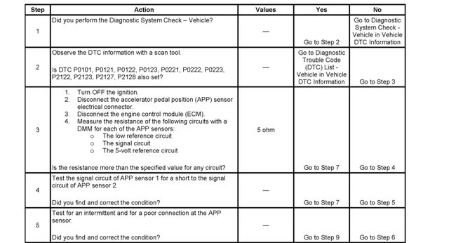

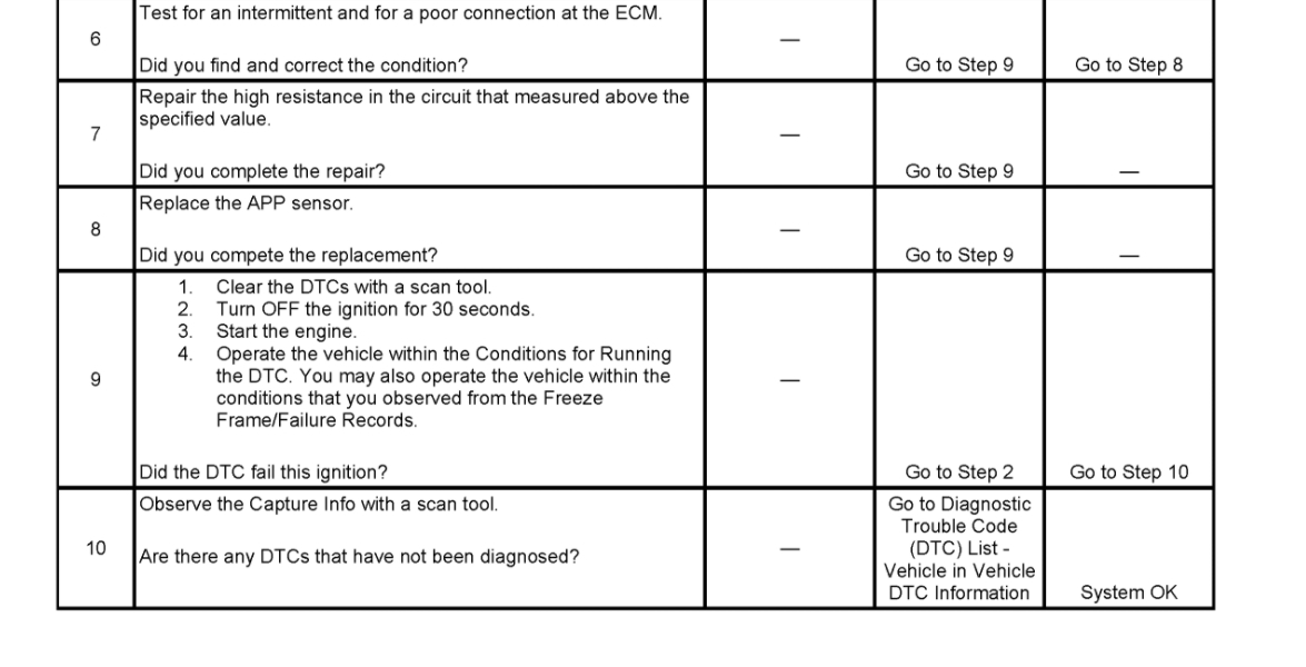

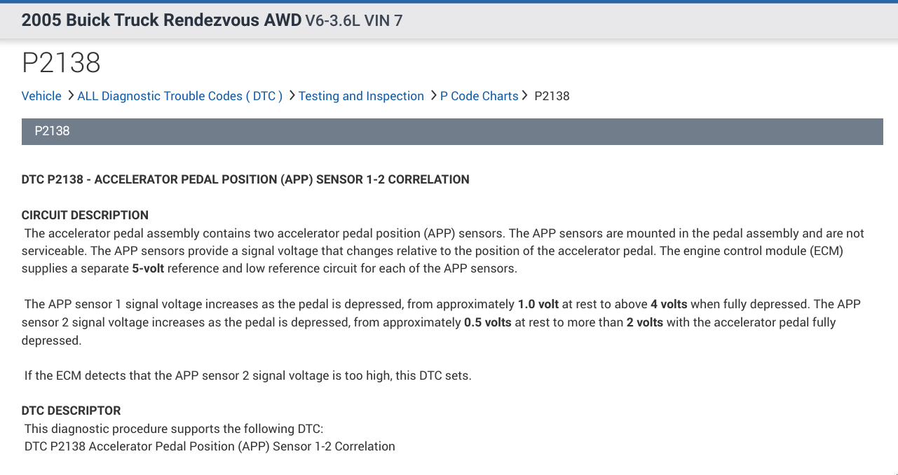

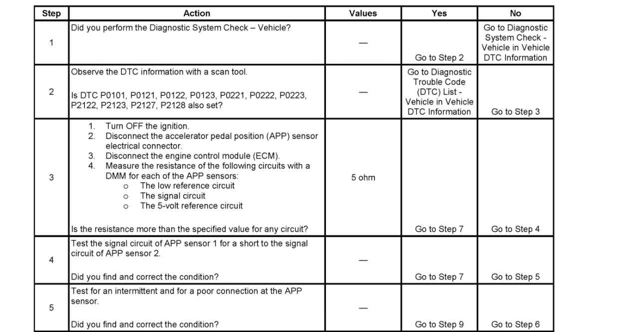

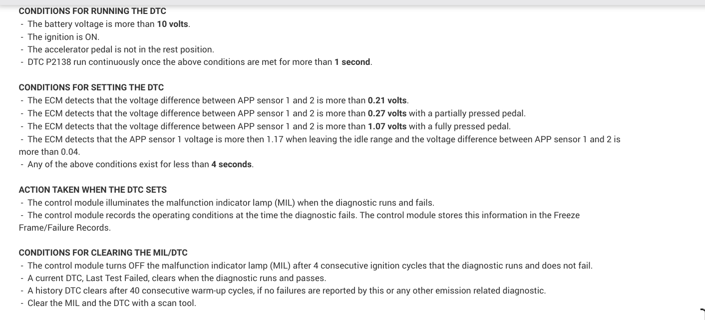

In the diagrams down below I have included the diagnostic troubleshooting guide from the vehicle manufacturer for Direct Trouble Code[DTC] P2138 for your vehicle. Please go through this guide and compare to what you did to fix the vehicle, and get back to us with what you find out. Happy New Year.
