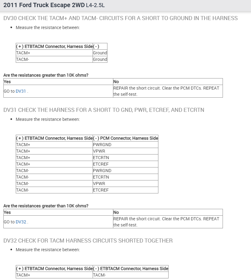

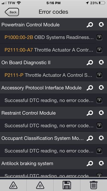

I’m getting code P2111, I even replaced the throttle body along with the gasket and still nothing. Also, in the process I replaced the connector for the MAP sensor as well as the purge valve as those two had nicks in the wiring or were just loose.

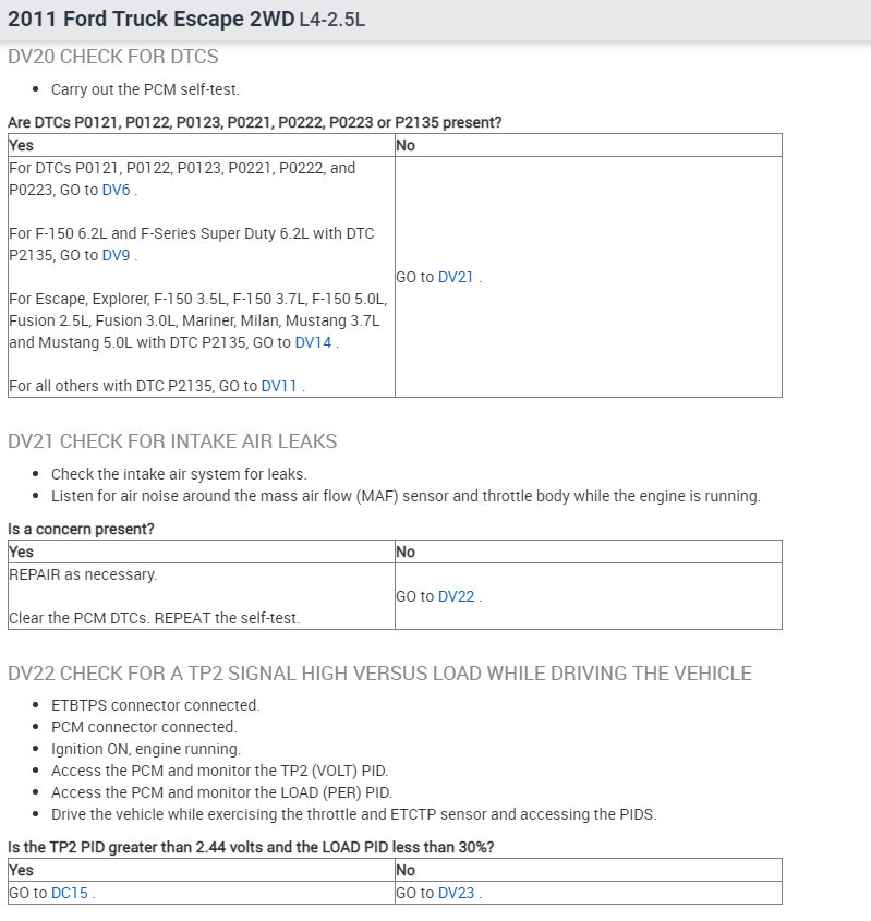

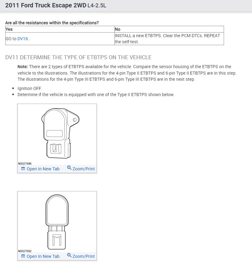

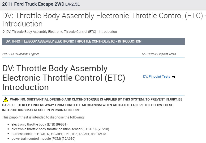

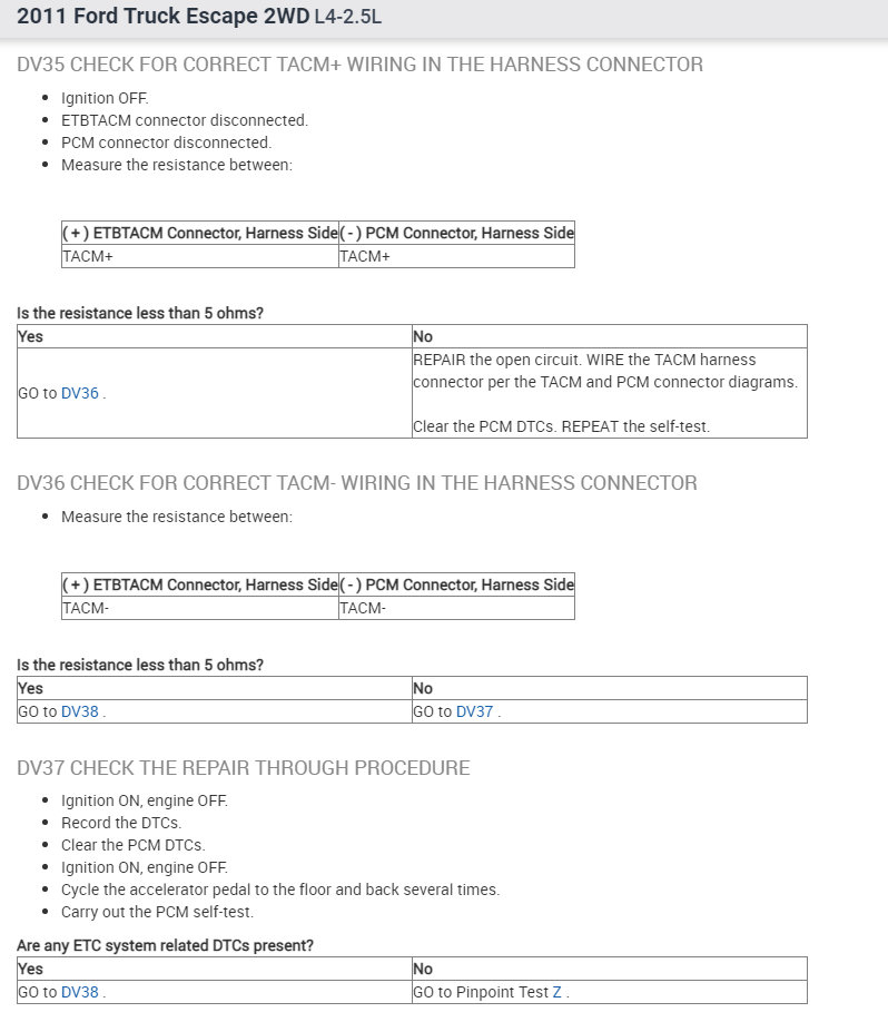

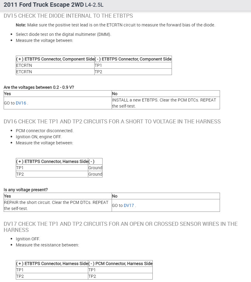

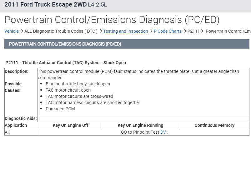

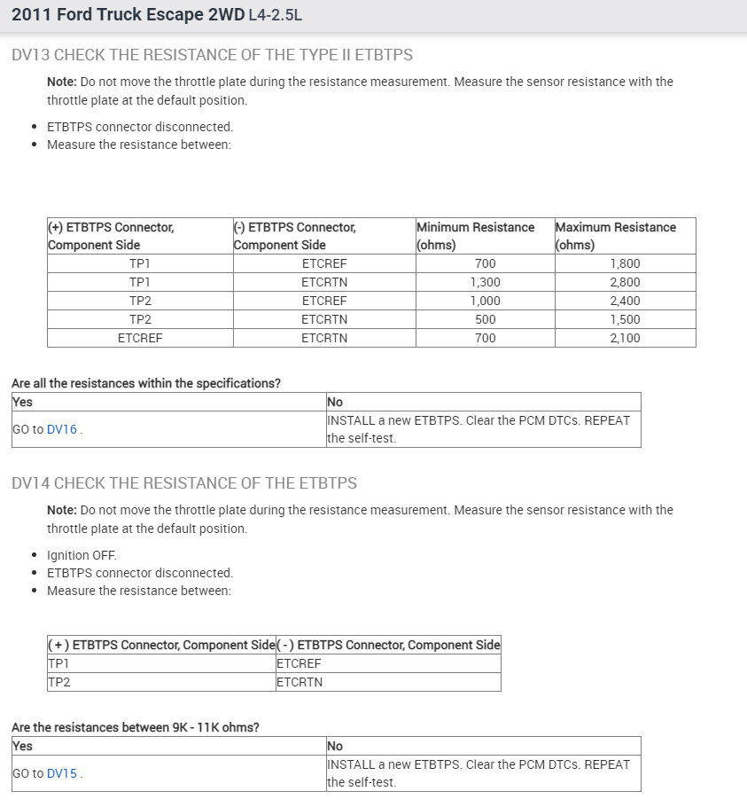

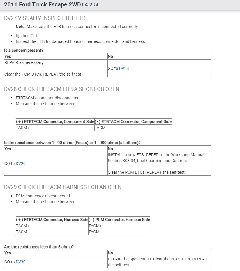

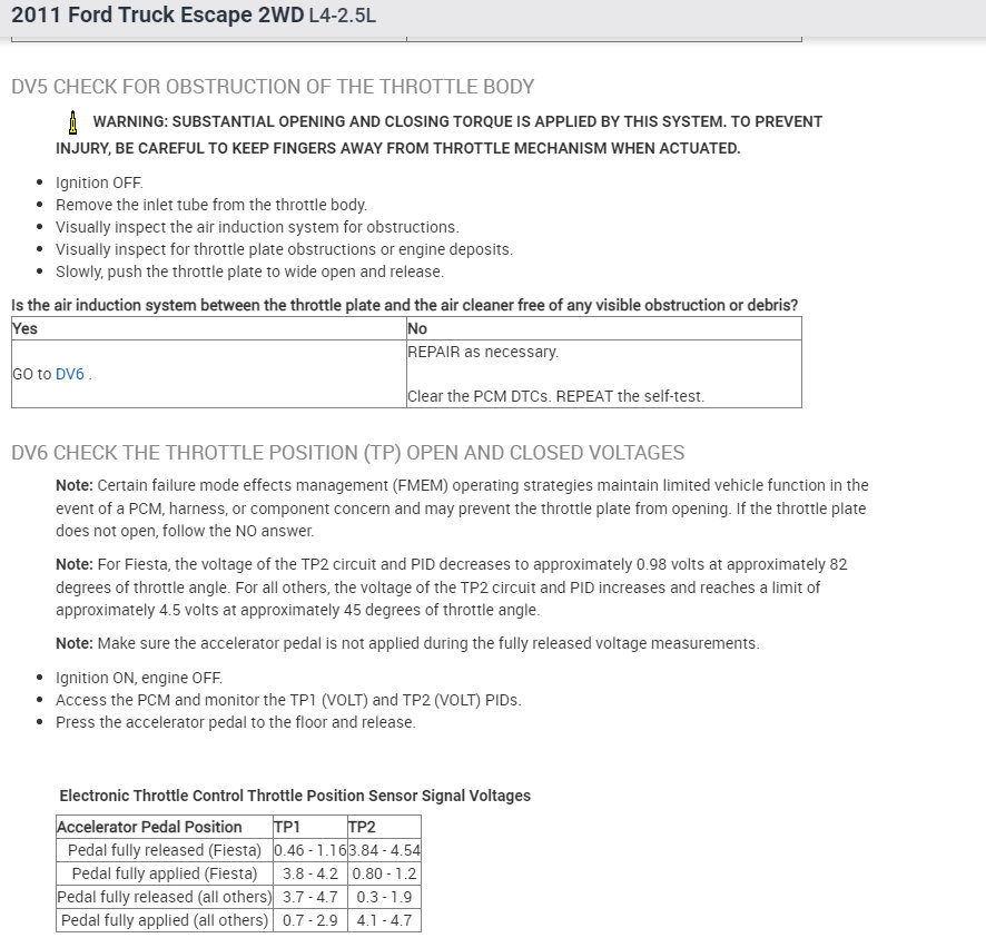

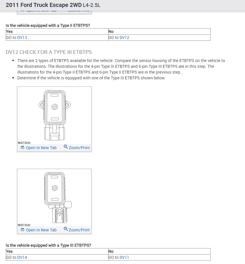

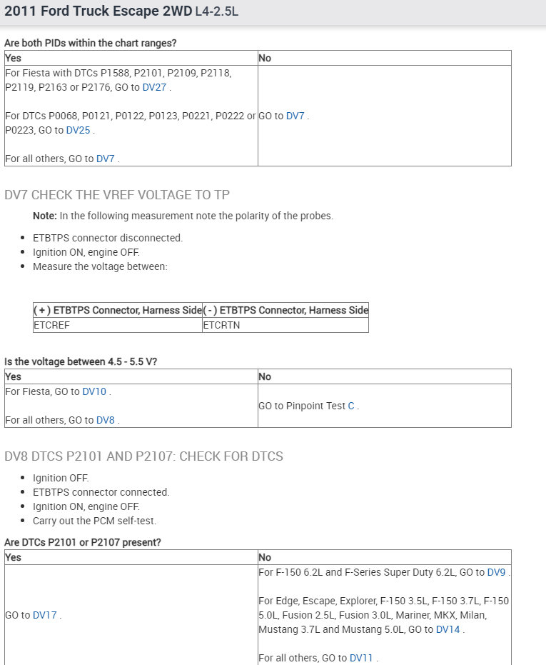

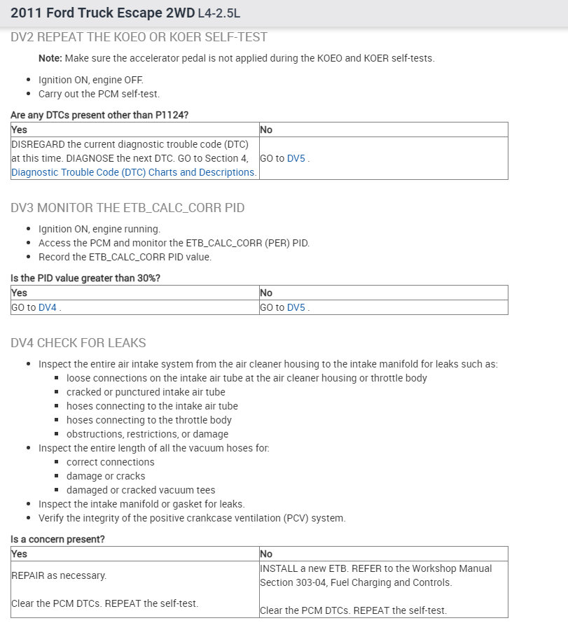

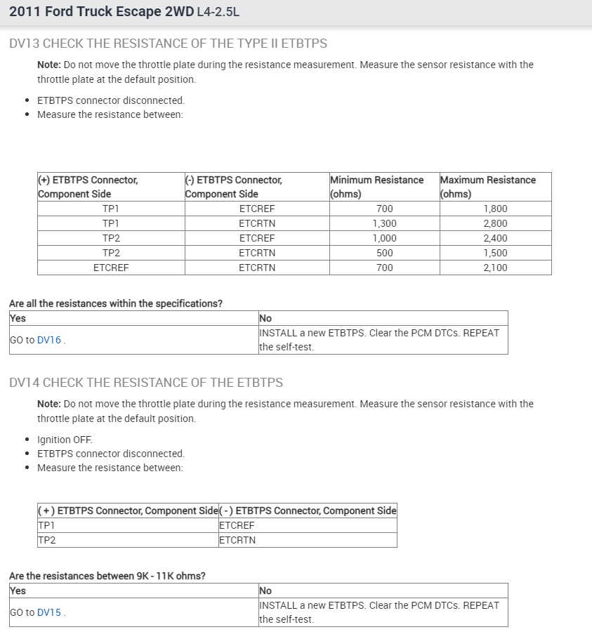

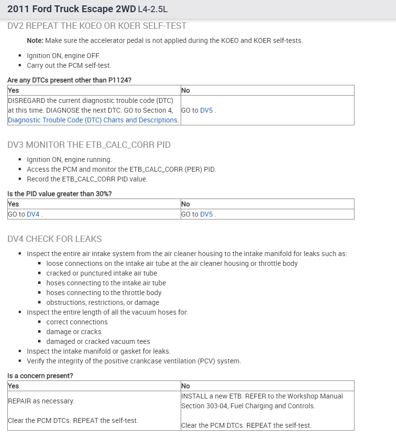

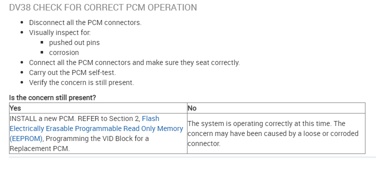

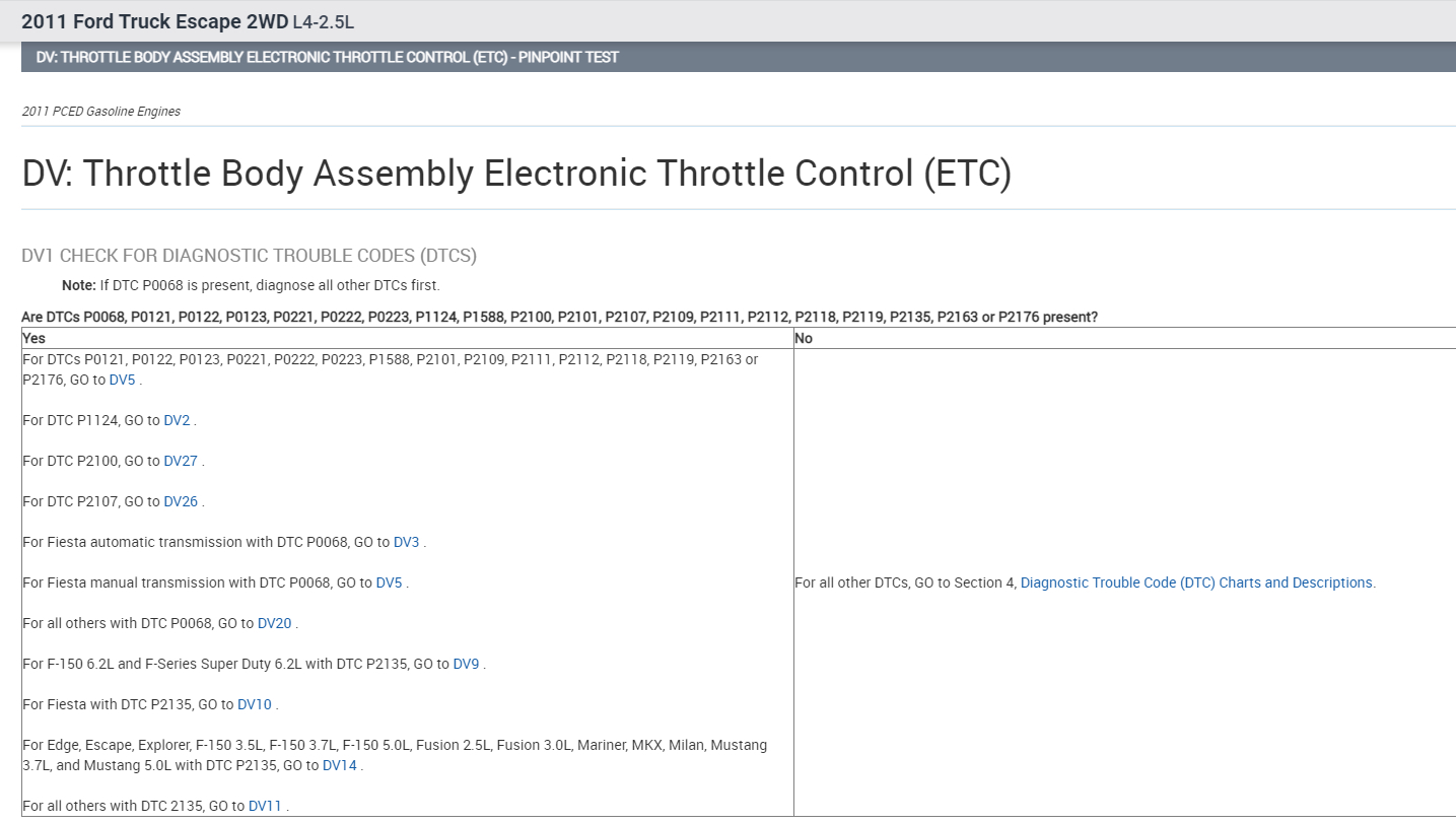

The code
P2111 - Throttle Actuator Control (TAC) System - Stuck Open

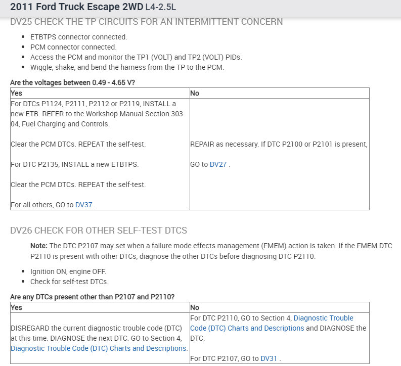

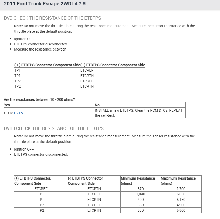

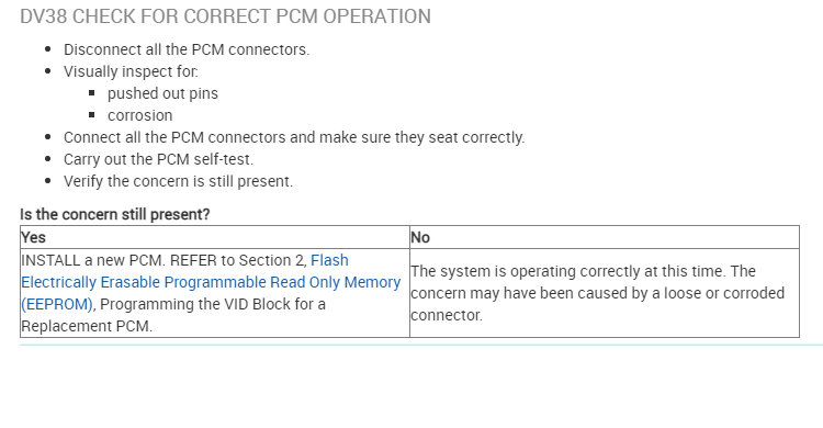

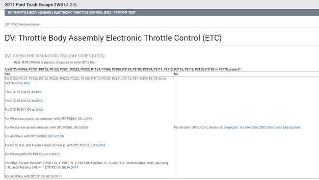

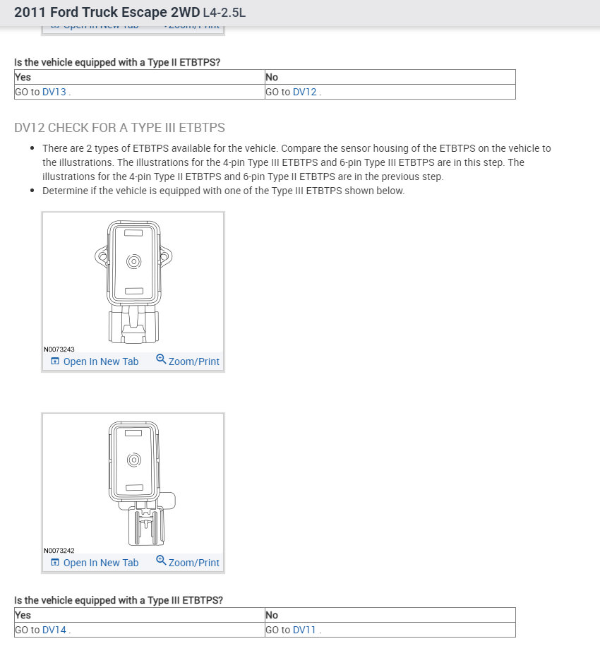

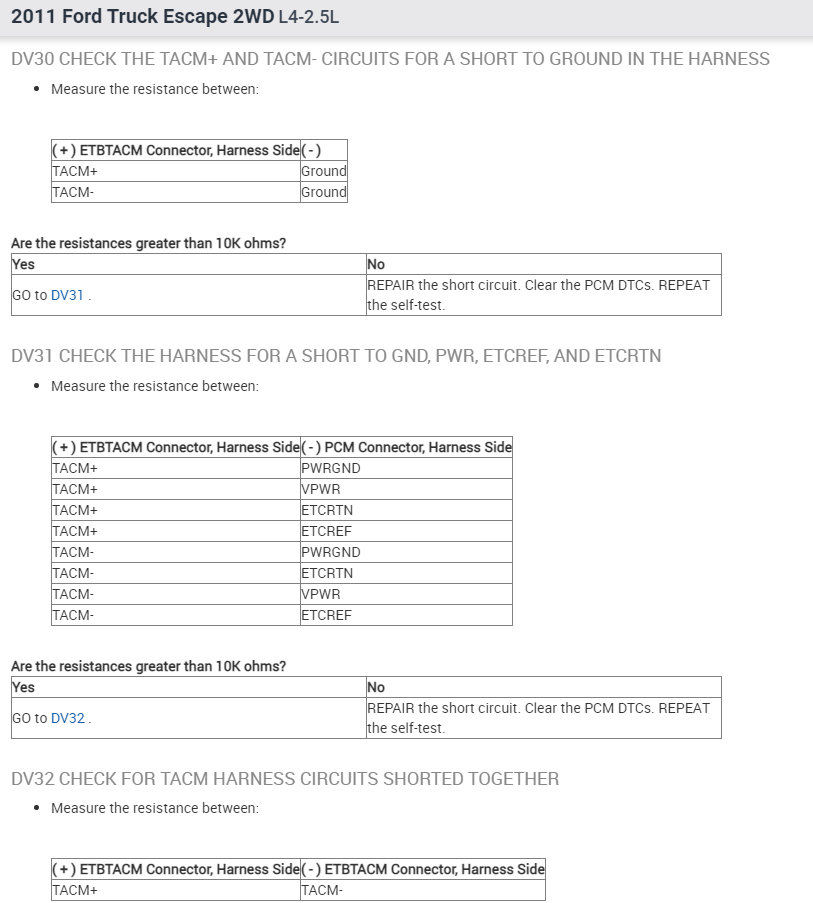

This can get triggered due to issues with the circuit, as well as the actuator itself that you have already changed. It can be also due to the ECM.

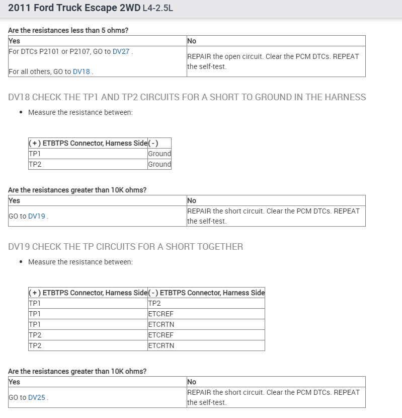

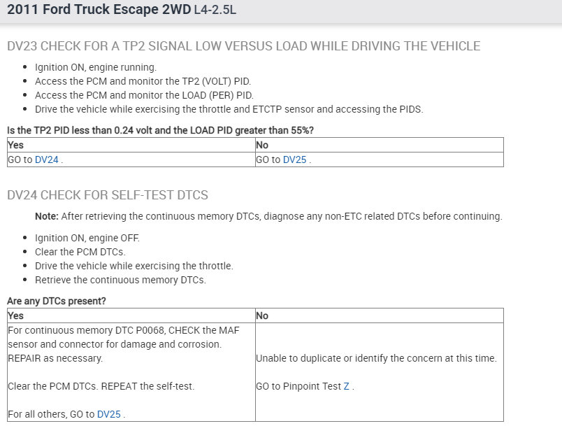

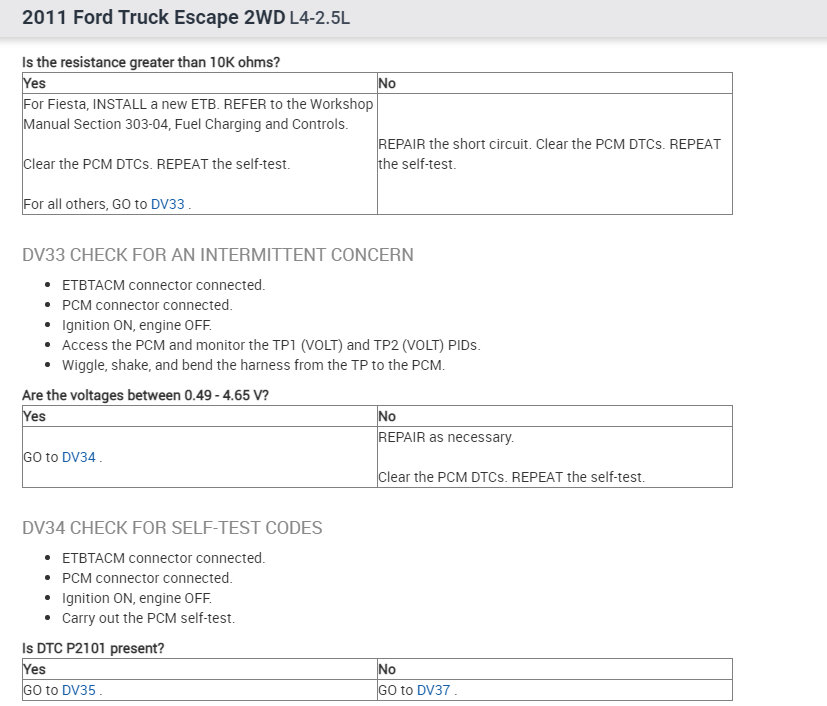

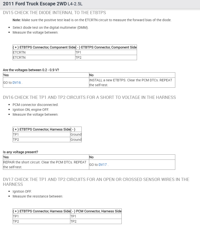

I have attached the trouble shooing guide for the code below for your reference. Follow those steps as it can help you determine the issue.
Let me know of any questions.

Sorry for the late reply.
As long as the extra wire is not attached to anything and not making contact it is fine.
You want to first focus on the throttle actuator harness.
Jun 15, 2022 at 6:03 AM
