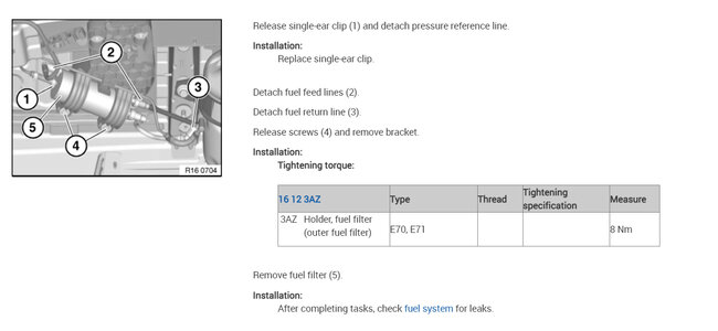

I have the vehicle listed above 3.0si and received the code P2096. I have changed the downstream injector. However, there does not seem to be a leak in either the upstream or downstream. Not really sure where to go from here since it does not seem like I have a leaking or broken injectors. And am not too sure if there is a working or good catalyst converter cleaner on the market. Any suggestions or someone who has run into the same issue?

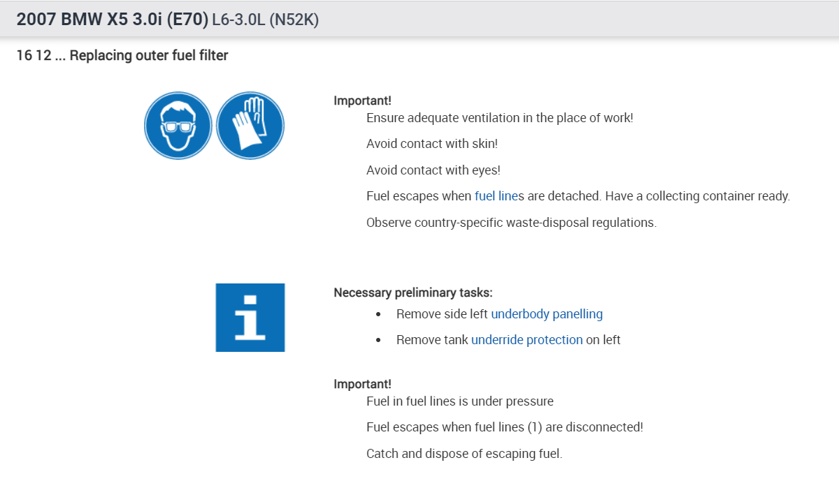

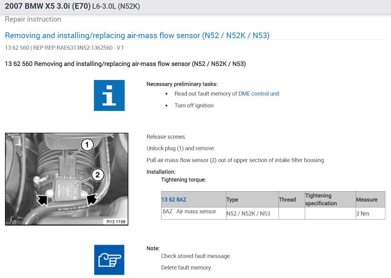

This can be caused by a vacuum leak or a clogged fuel filter or a bad MAF sensor, I do the vacuum leak check first. Please use this guide when the engine is cold only:
If no leaks are found, please change out the fuel filter which is a normal maintenance item. The location is in the images below. And finally, the MAF sensor needs to be replaced. Also, the location and instructions are in the images below.
