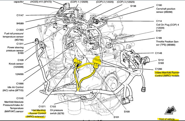

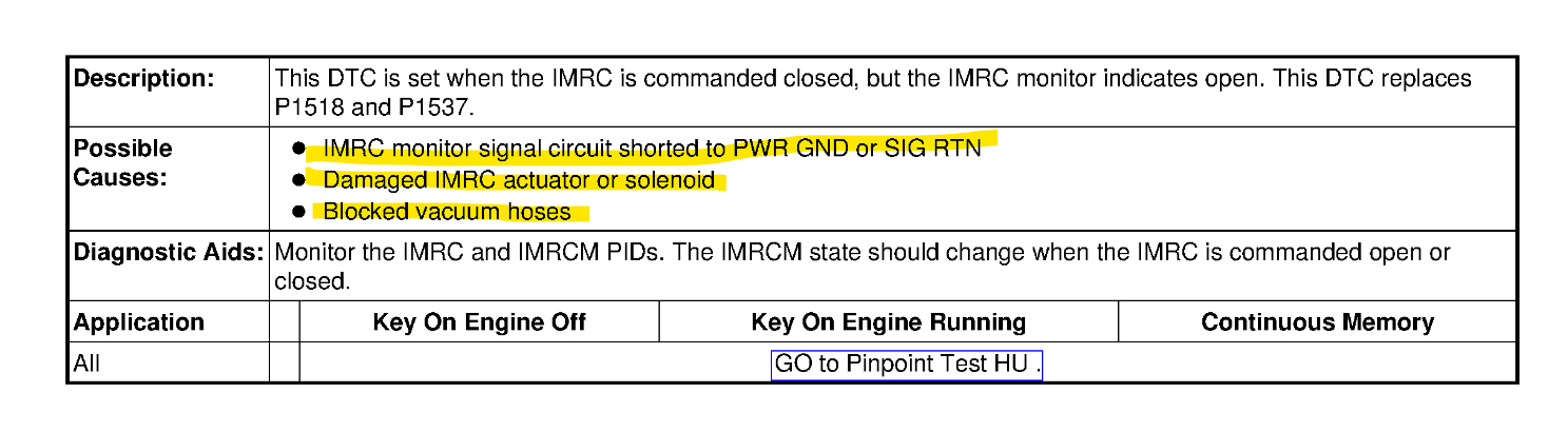

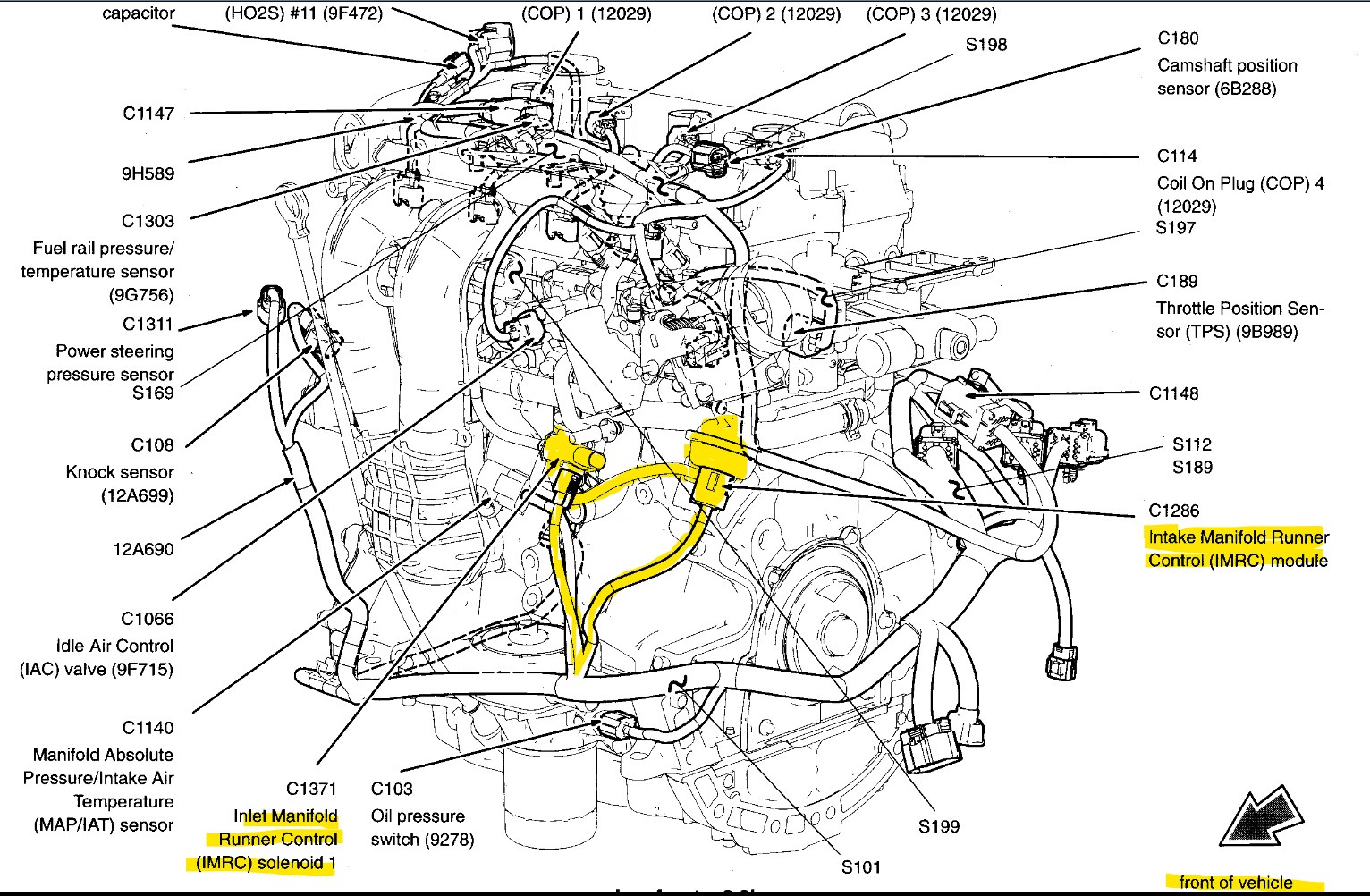

Hello, this code indicates that the intake manifold runner is stuck open, I assume your vehicle has a plastic intake manifold as well?
This can be an issue with the actuator or solenoid that controls the runner. There are 2 different systems it looks like for this model; the Actuator is an electronic motor that moves the intake runner. The Solenoid controlled design uses a solenoid to control vacuum to the solenoid and is monitored by a small module at the end of the intake runner.
When you replaced the runner did you notice if there was a vacuum hose going to the end of the runner? If it's a vacuum controlled system, it might be the solenoid is bad or not receiving vacuum. I'll post a picture of the vacuum controlled design.
It's important to know which system we are dealing with here first. The motorized actuator doesn't have a position sensor on the end like the vacuum controlled system does.
The motorized system also only has a 2-wire connector on the motor, whereas the vacuum controlled system has 2 wires to the vacuum solenoid and 3 wires the module (or position sensor) at the end of the runner.
These systems basically vary the amount of air coming into the intake manifold by rotating the valve to close or open the intake more.
And most times because the intake manifolds are plastic, they can warp because of heat over time and the runner will stick inside and not rotate correctly, that's why we will usually replace the intake manifold with the runner
