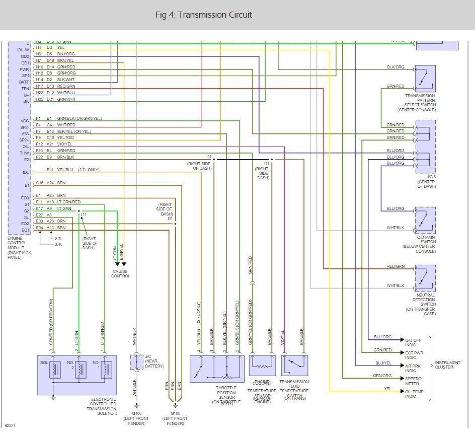

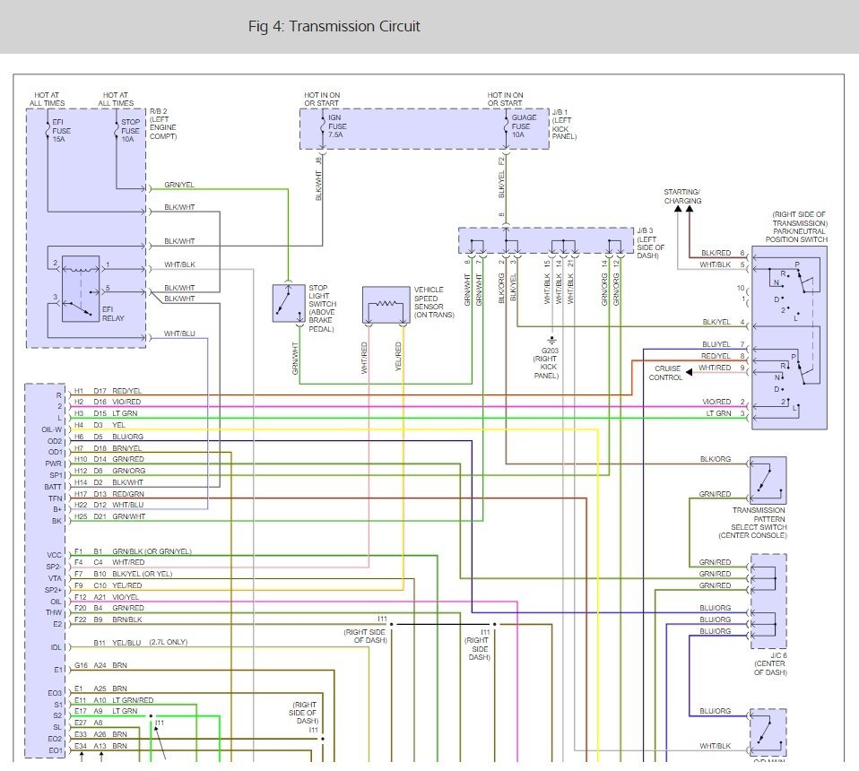

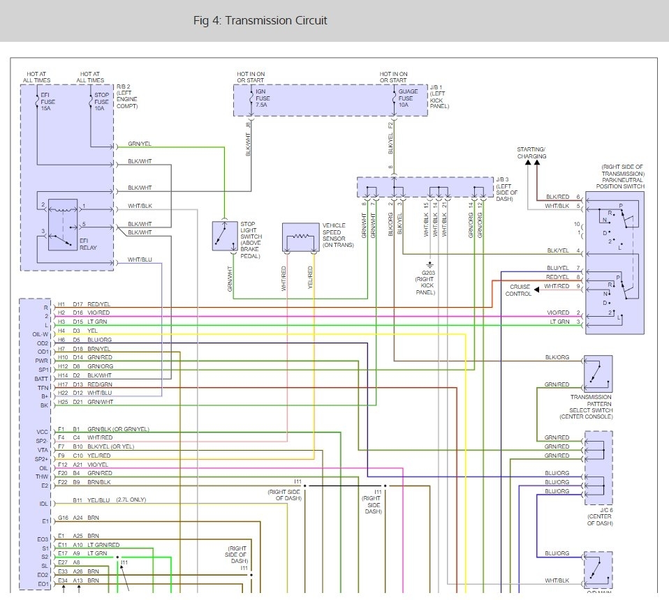

I switched out the neutral safety switch. Cleaned out the plug that plugs into very well I use toothpicks are used paper towels and I use electrical cleaner. Check engine light went off it was fine all weekend I drove about five miles this morning on my way back to check engine light went back on. Does anybody have any more options that I could be?
Jul 10, 2017 at 1:13 AM
  • 55,224 POSTS
It sounds like you have a bad connection in the wiring between the switch and the ECU. Here is a guide and some wiring diagrams (below) so you can run some tests to get the problem fixed.
Please run some tests and get back to us we are interested to see what it is.
