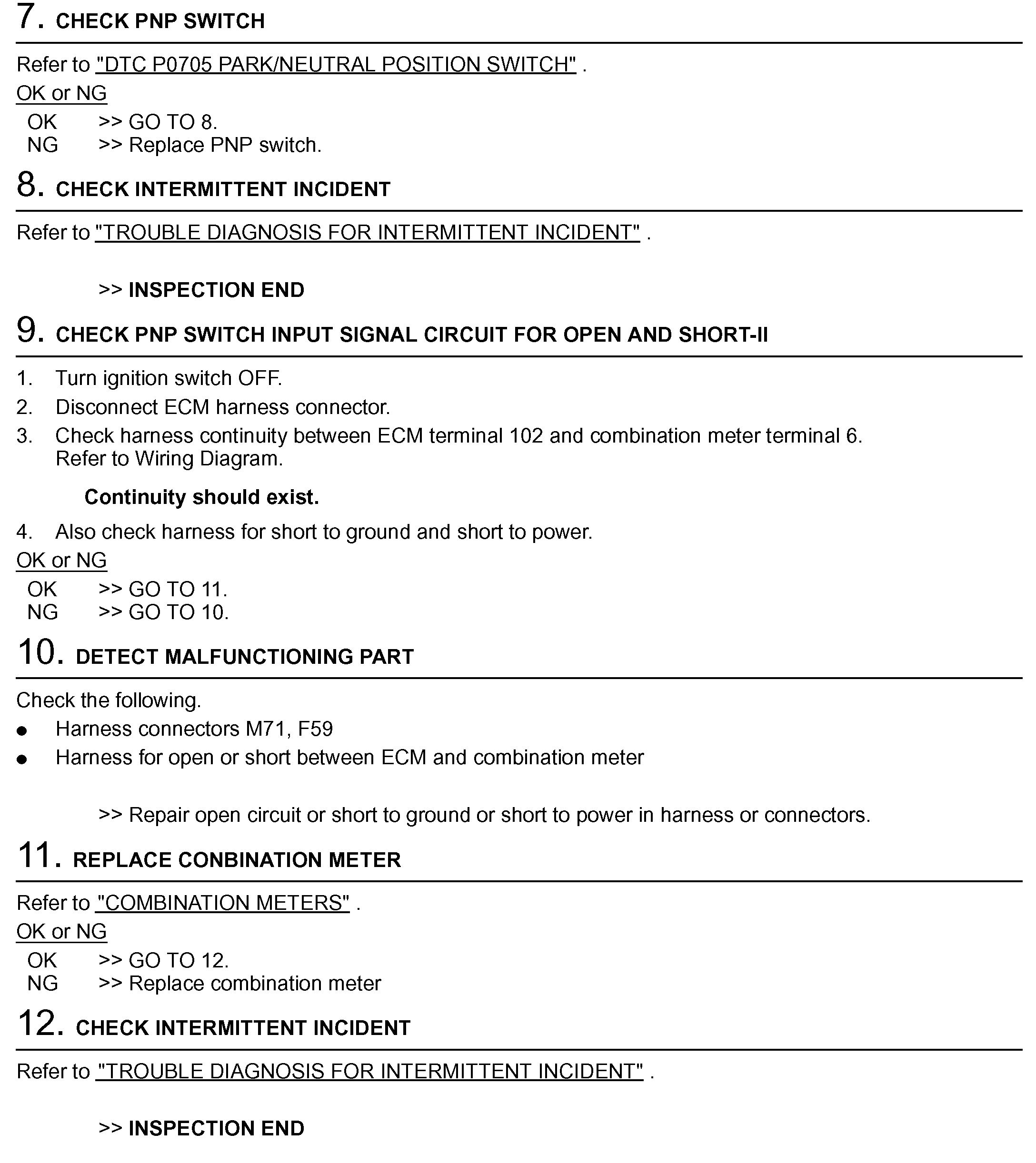

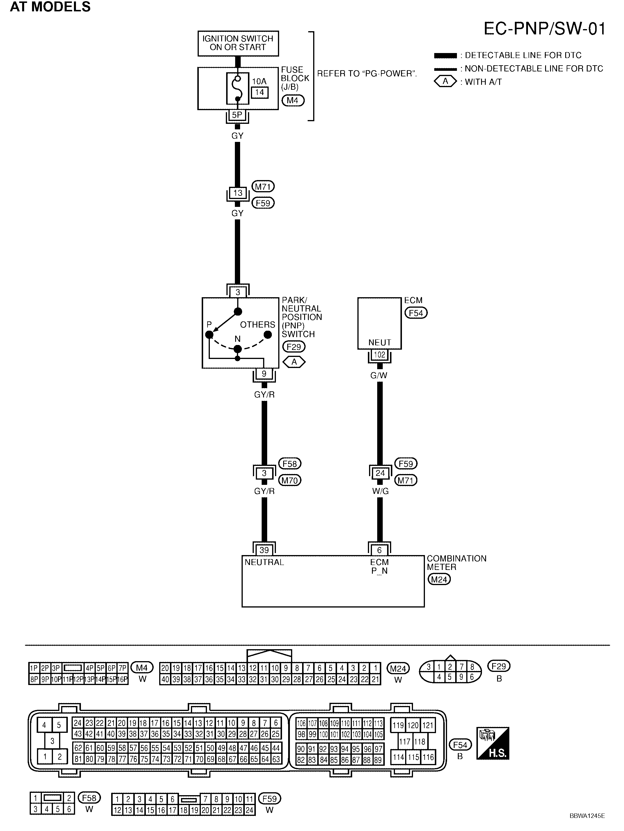

Neutral position switch been replace, wiring information in order to troubleshoot wiring. thanks

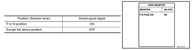

Here are the diagnostics for the code. The attached pics correlate with these directions.
________________
pic 1

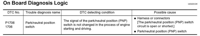

On Board Diagnosis Logic
DTC Confirmation Procedure
CAUTION: Always drive vehicle at a safe speed.
NOTE: If DTC Confirmation Procedure has been previously conducted, always turn ignition switch OFF and wait at least 10 seconds before conducting the next test.

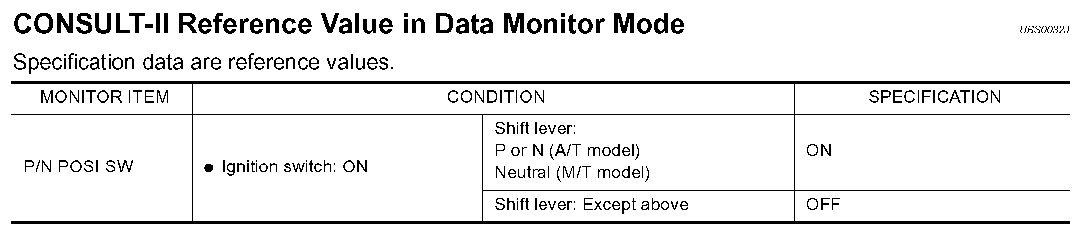

WITH CONSULT-II
1. Turn ignition switch ON.

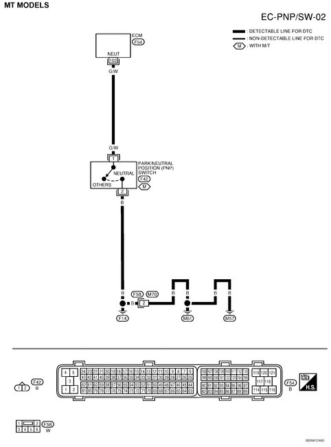

pic 2
2. Select "P/N POSI SW" in "DATA MONITOR" mode with CONSULT-II. Then check the "P/N POSI SW" signal under the given conditions.
If NG, go to "Diagnostic Procedure" below.
If OK, go to following step.

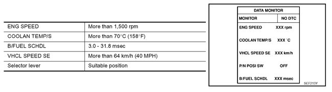

3. Select "DATA MONITOR" mode with CONSULT-II.
4. Start engine and warm it up to normal operating temperature.
pic 3
5. Maintain the given conditions for at least 60 consecutive seconds.
6. If 1st trip DTC is detected, go to "Diagnostic Procedure" below.

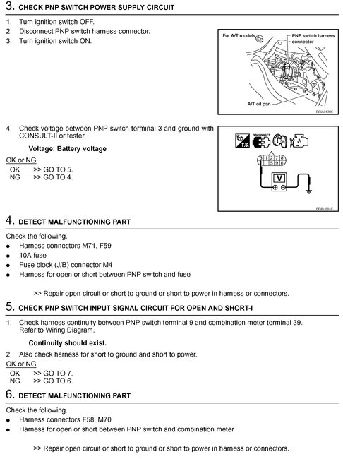

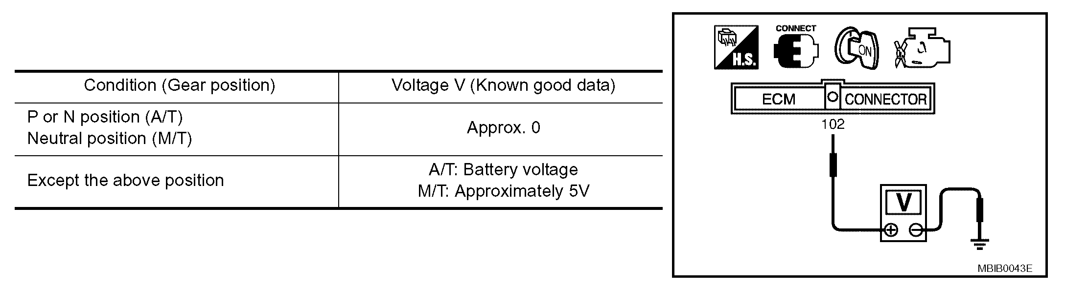

WITH GST

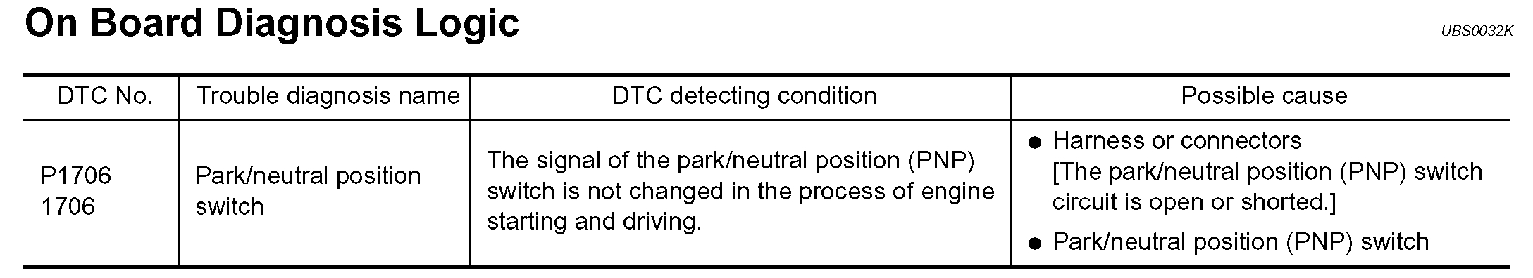

pic 4

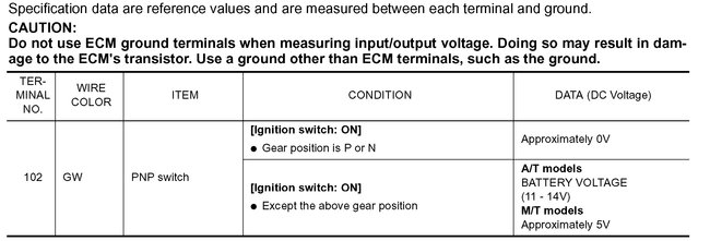

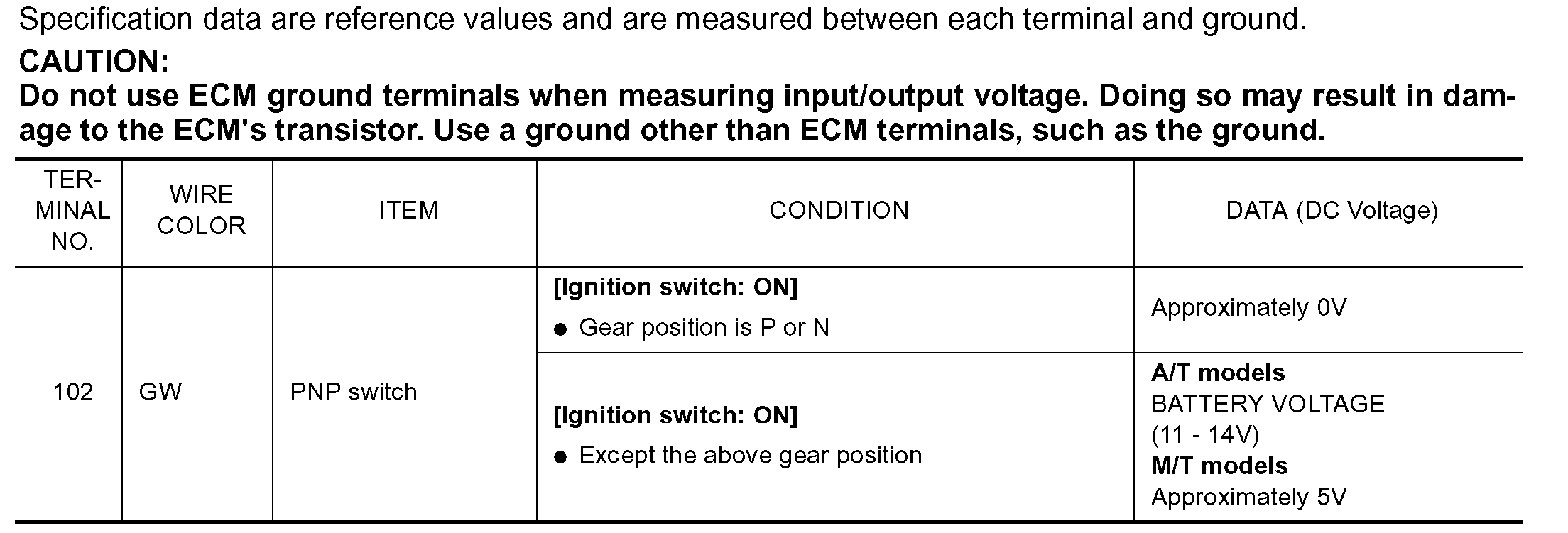

2. Check voltage between ECM terminal 102 (PNP switch signal) and ground under the given conditions.
3. If NG, go to "Diagnostic Procedure" below.
EC-PNP/SW-01
pic 5

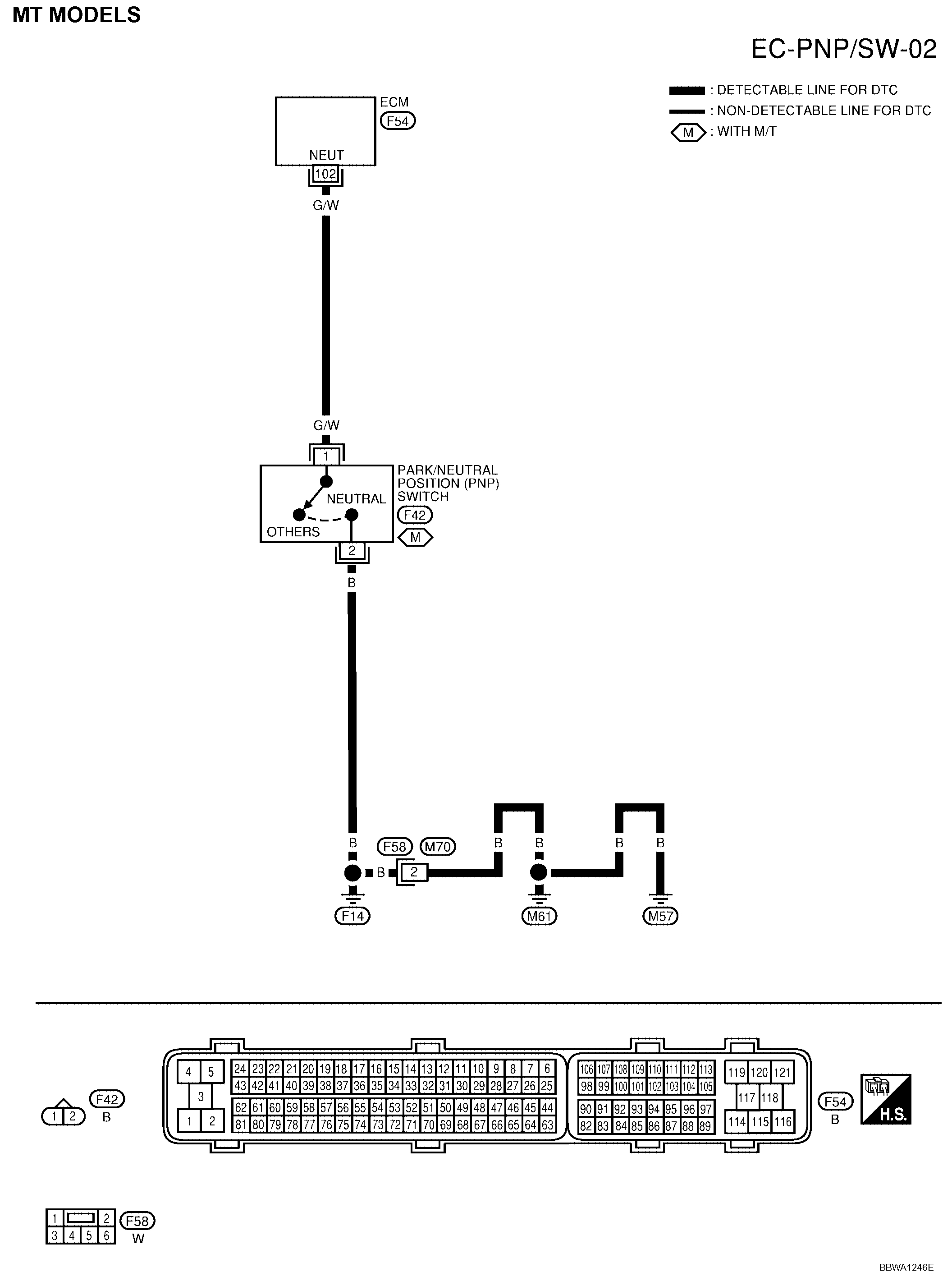

EC-PNP/SW-02

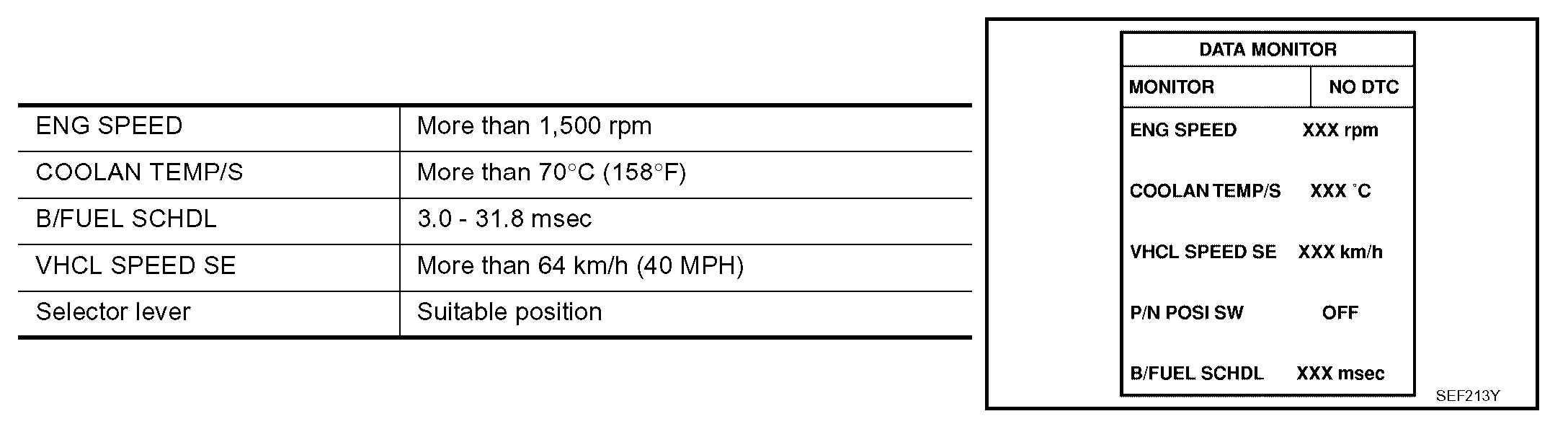

pic 6
pic 7
Wiring Diagram

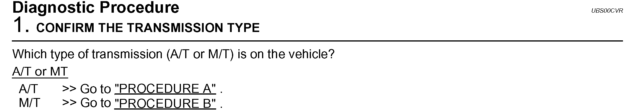

Diagnostic Procedure (Step 1)

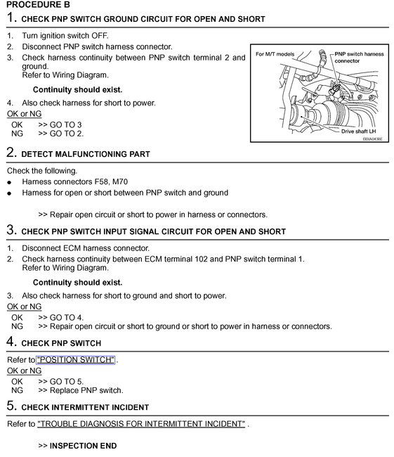

pic 8

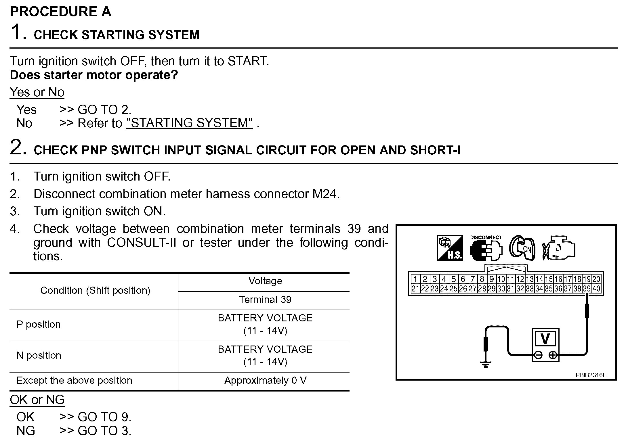

PROCEDURE A
Procedure A (Steps 1 - 2)
pic 9
Procedure A (Steps 3 - 6)
pic 10
Procedure A (Steps 7 - 12)
pic 11

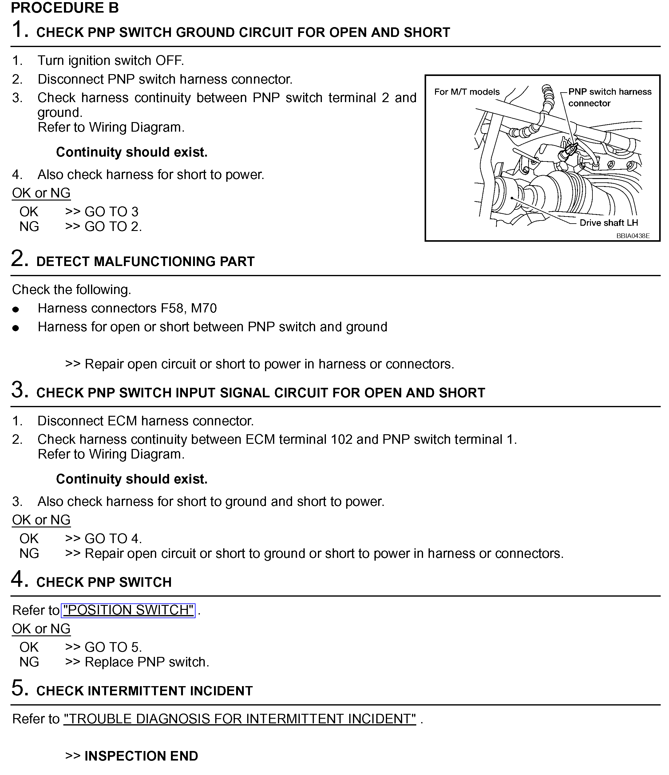

PROCEDURE B
Procedure B
pic 12
