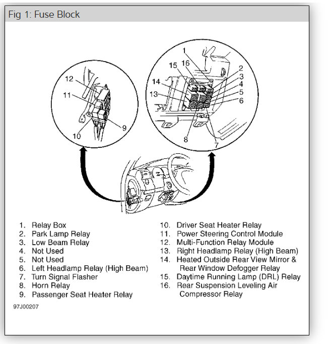

What does code P1700 mean and how can I fix it inexpensively?
Nov 14, 2016 at 10:56 PM
HMAC300
CAR REPAIR CONTRIBUTOR
48,601 POSTS
that is a transmission problem internally not allowing the TCM to communicate with PCM. Lets start by checking the fuses here is a guide and th fuse locations in the diagrams below.
Image (Click to enlarge)
